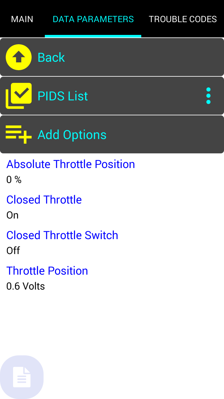

But my idle speed is messed up, after warm up idle speed is around 850rpm and ignition timing at 5°(yeah 5° not 15°)
Already tried idle relearn but not successful, checked everything, no vacuum leak, the car is running fine just not perfect because the fuel trim and higher idle than official spec.
Is it normal that my Closed Throttle Switch always Off???

That would be why it's pulling fuel. Timing is too low, so it's nowhere close to burning fully. You're gonna have to figure that out. What's the timing do after idle and under load?
850 is a good idle speed, anyway. That gives you higher oil pressure.

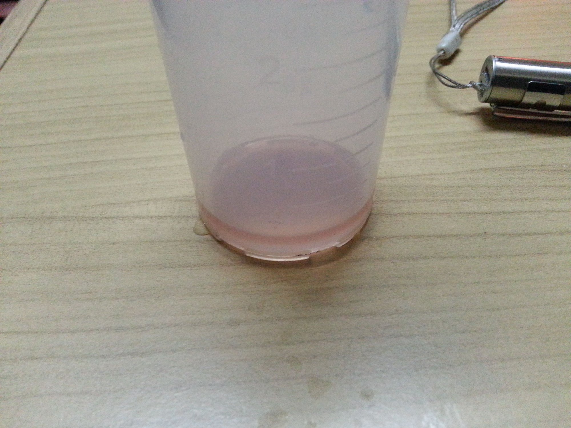

Well, just found out my fuel pressure regulator has small amount of fuel leaking from vacuum port, also the same thing happen on fuel pressure damper but it's worst than the FPR....
Old Jul 20, 2020 | 08:52 AM
95naSTA's Avatar
Posts: 941
From: Philly
That would make sense for the rich trims. Let us know if it fixes it.
