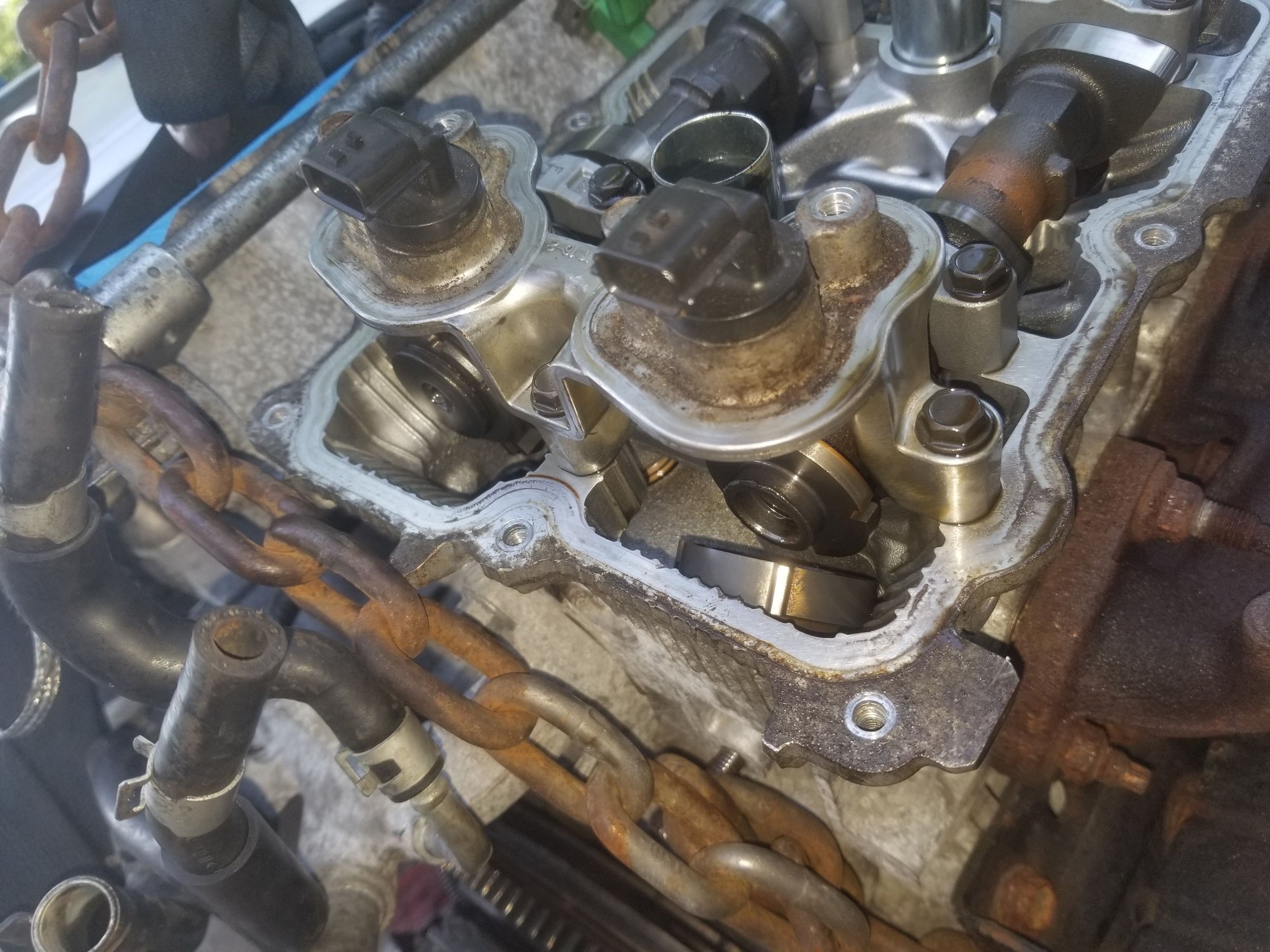

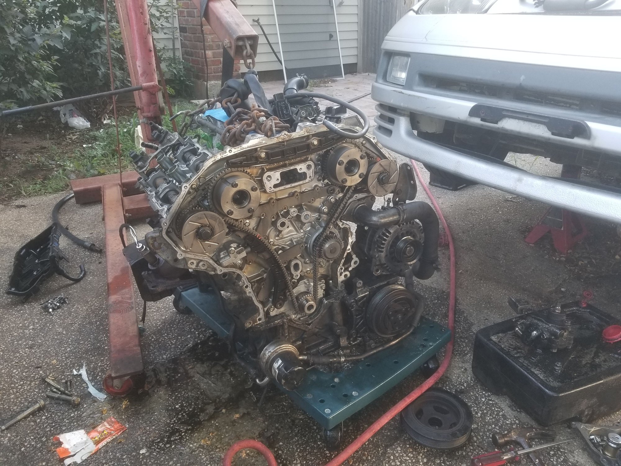

Mistakes were made initially. It's a 2009 motor. I thought the timing guides had gone because the issue sounded exactly like my original 3.5 that blew but upon pulling the engine i found that the guides were fine and the cam signal wheel had spun right off!
Timing chain and guides are spotless. So I'm going to do myself a favor and change the oil gallery gaskets
Im going to put some loctite and screw it right back on, this may have been the issue all along.
I also had poor compression in bank 1 and i tried using engine restore to remedy it. But now I'm here with the engine out and timing cover off so yeah... At least i can give the bay a good scrub down 🤷🏽‍♂️
