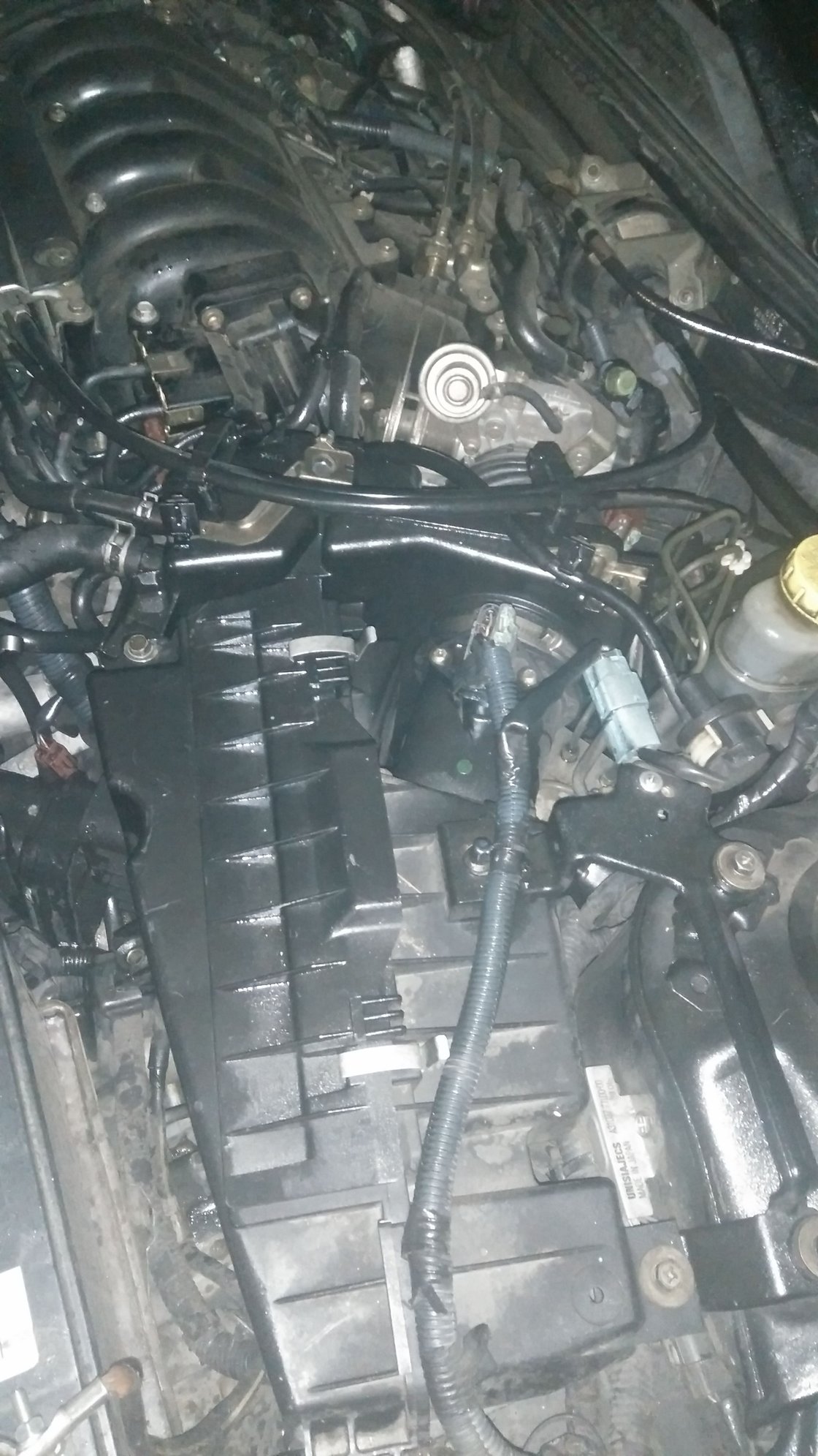

I was driving on the freeway to get dinner and suddenly the check engine light came up. The temp gauge was close to max.
I turned the AC off, took the nearest exit and parked. Saw some steaming smoke from the hood for a minute. The temp gauge was back to normal quickly.
From the moment the check engine light came on to parking, I would estimate it was above 2-3mins. But seemed like an eternity.
When I opened the hood, there was coolant leak on pax side. It was dark, cell phone flash light didn't help me find anything obviously wrong.
The radiator inlet and outlet hose were plugged in. Thermostat+hose looked good.
I am thinking this is a coolant leak, but not sure where to look.
Here's a pic. It didn't really come up like it looked. Thanks to the crappy camera.
coolant leak

Looking at the spray pattern on the air box and intake, I'm guessing the radiator is cracked on the top along the seam. It's notorious on this cars with the factory radiator.

I was thinking that same thing even before I opened the post. That happened on my 97 Max and my 03 Max, I replaced the radiator with an OE one both times.

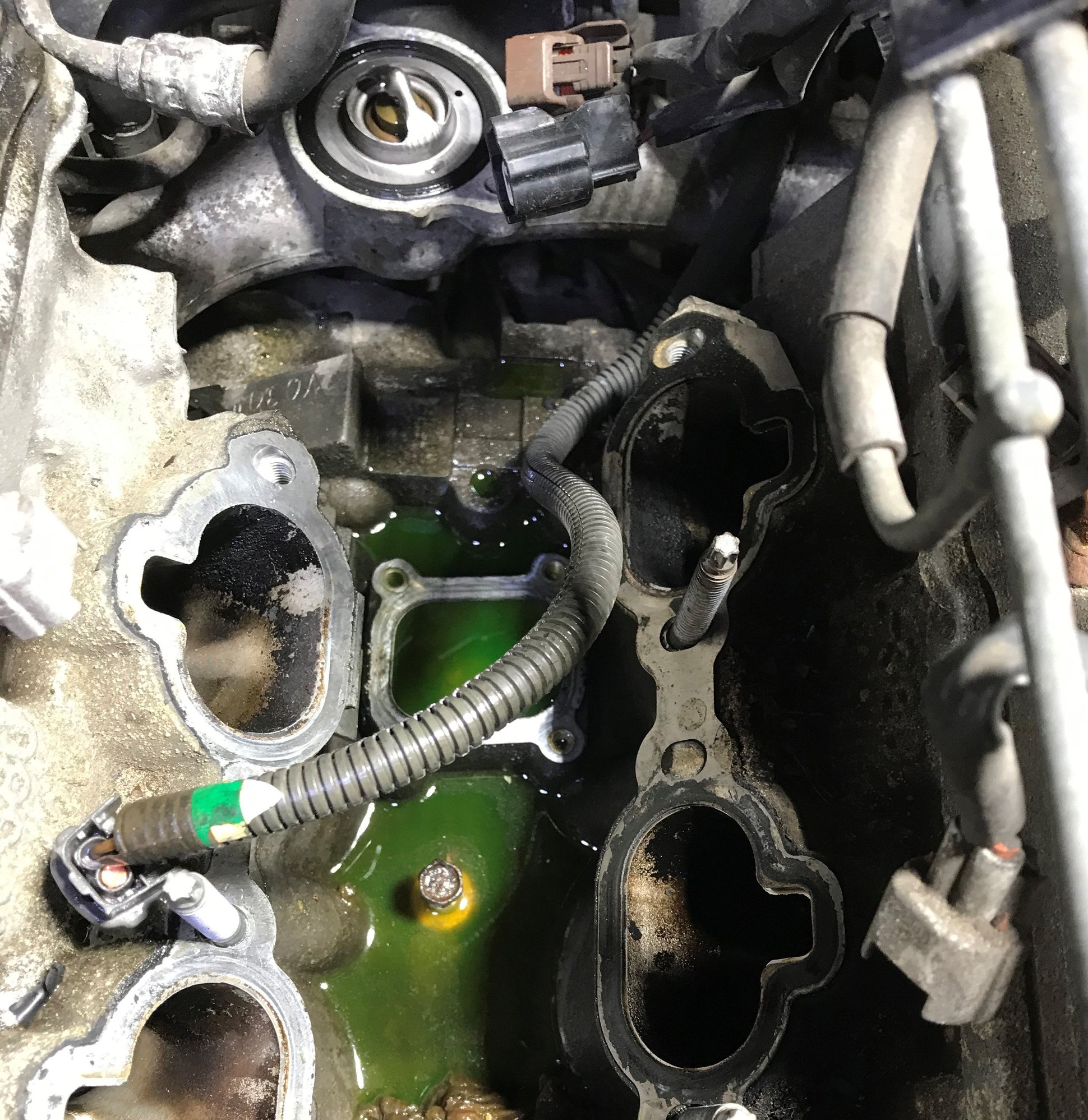

There's a high temp thermostat under the water inlet pipe, the hose can be leaking or the gasket. Also in that area are all your smaller diameter hoses for throttle body. I had to replace the hose for the water inlet pipe a year ago on my 2001 max. My pinhole was pointed toward under the intake manifold so it flooded the galley where the knock sensor is bolted. To make things easier and also wanted to change out the knock sensor, I ended up having to remove the upper and lower intake manifold to get to everything.
The only pic I have is with everything removed, the water inlet pipe would have connected the thermostat to the top of the block
