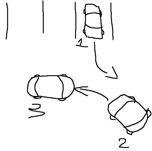

Hello everyone, I have an '00 Maxima A/T with 228,000 miles. In the last 2 years, it has gotten all 4 motor/trans mounts, inner and outer tie rods, lower control arms, sway bar bushings, and sway bar end links. Front tires are new and were just balanced. Recently in the last few weeks, I have noticed a pop/clunk coming from the general vicinity of the front drivers side area, and for the most part, it only happens at slow speeds like in parking lots when I'm turning and I get on the gas, however it will occasionally happen when I'm going around 35 and I floor it. It almost sounds like something is binding, and I can feel it in the floor.
I have looked and felt around under there, and the stuff I replaced is all tight. I did a little snooping on the forum and I'm suspect of the strut bushing mainly because I have no idea how old the strut assemblies are or how many miles are on them, but I'm not entirely sure how to single that out without taking the strut assembly apart. Maybe there's something else I should be checking that I'm missing.
I have drawn this beautiful illustration of my car in a parking lot to try and explain when the noise happens. It happens between points 2 and 3 when I get on the gas.
I think it's your driver-side CV axle.
Agreed. Old car.
The lash you are feeling and hearing in and out of gear is an indication of worn joints. Pop a new driver axle in. They're like, $50 bux.
