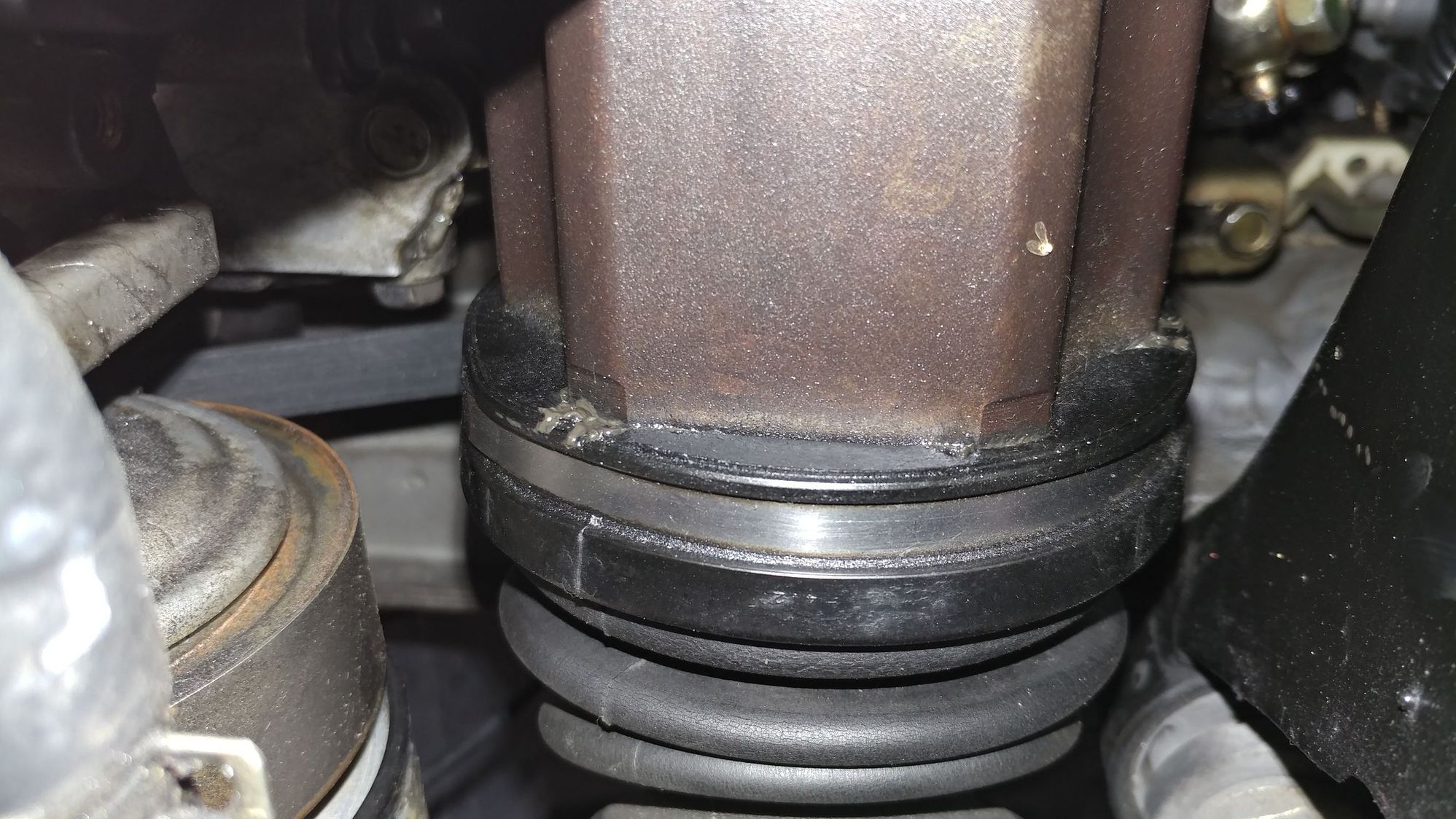

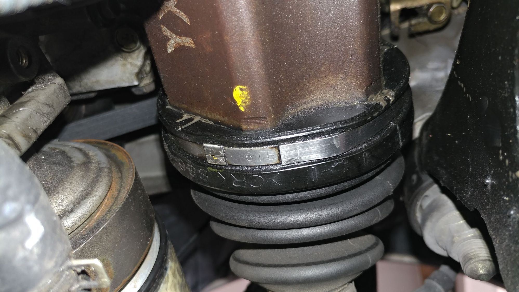

When I was under the car this weekend I noticed that CV grease is leaking out of the end of the inner boot on the passenger side and coating the surrounding parts with brown sludge. Anyone ever seen this happen before? The boot is totally intact. I'm guessing the grease is losing it's viscosity and is now thin enough to seep out of the boot. I don't think the joint is damaged but I should probably deal with this before too much grease comes out.
