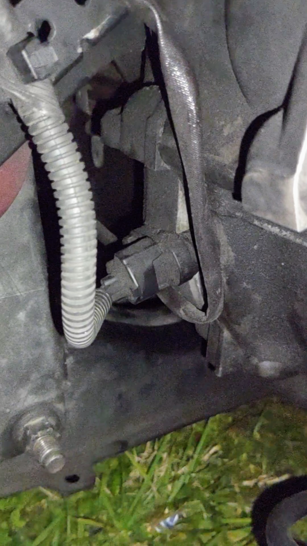

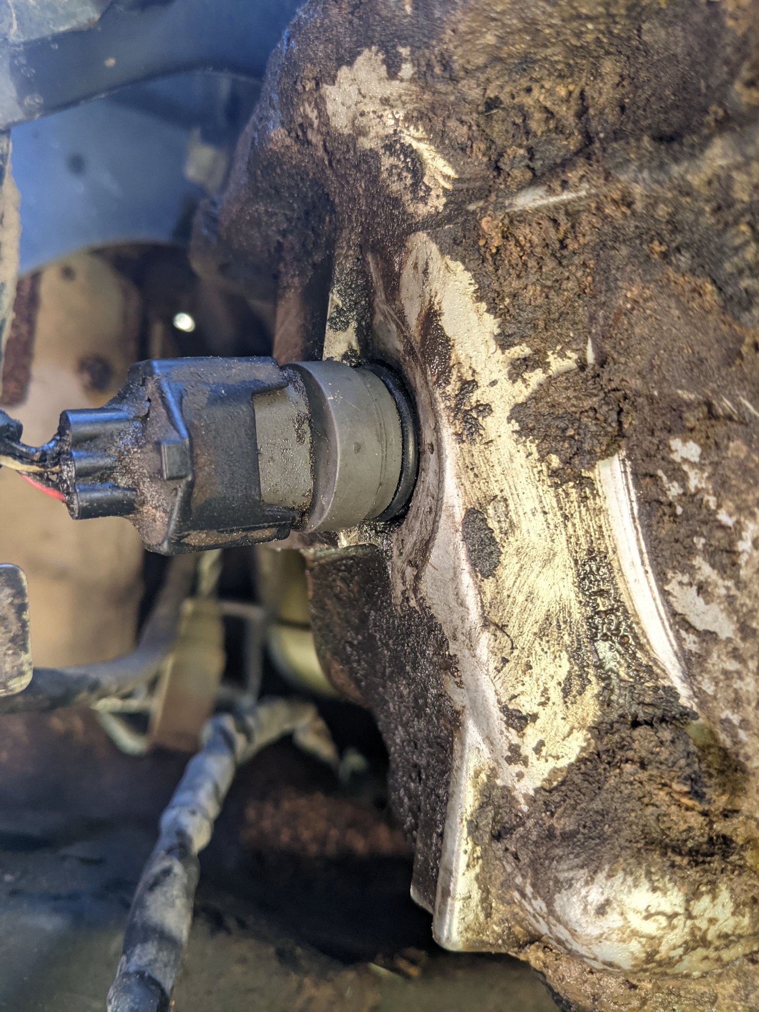

Is there supposed to be a bracket or something holding the top of the crankshaft sensor? I took the old one out and it was fairly loose when I took it out and now the new one doesn't seem to want to go in all the way and It's also loose.

no bracket, just one small bolt and a connector.
That is all the way in completely lined up with the one bolt.

I guess I'm missing a little plastic piece now that I look at your picture.

there's no plastic piece, that's the primary O2 sensor wire. I have 4th gen exhaust manifolds with Warpspeed Y-pipe and the primary O2 sensors are halfway down the Y-pipe instead of on the exhaust manifold. I used 2002 pathfinder left side O2 sensors since the wires are a lot longer. that's just how I routed that side to keep the slack from getting into the radiator fan. looks like my crank sensor is missing the o-ring. I don't think the crank sensor would keep power from getting to the fuel pump. I'm guessing it's an NATS issue.
I wouldn't think it has much to do with not getting power to the fuel pump either, It's just something I noticed when looking over the car. It doesn't seem right for the crankshaft sensor to be that loose and for the o-ring on the crankshaft sensor to not even sit properly.
