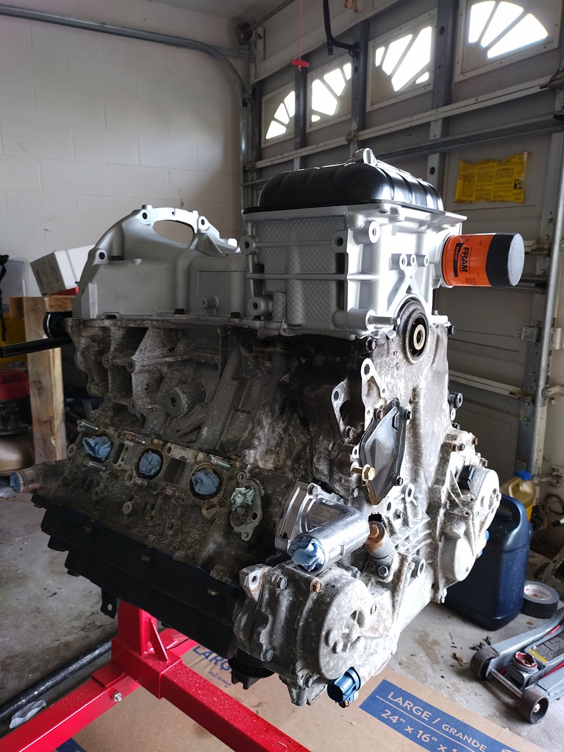

you won't know for sure what's leaking until the transmission is out but at that point it's best to do the rear main seal and upper pan due to the way it's designed. it's a little tricky to put on too, I had to do it twice because I pinched the seal putting it onto the crank.
when I first got my 02 ( December of 2012 with 175,000 miles) the throw out bearing went out and after the car was towed with a wheel lift I spotted a leak on the driveway. I assumed it was the rear main seal but it was actually the half moon gasket on the upper oil pan. I only did the rear main seal since I had the tranny out..
I would do the upper pan first and see if that solves it. it's a pretty easy job but you gotta make sure to do some good prep on the pan and bottom of the block . I even waited 24 hours for the ultra gray to fully cure before I even put oil into the engine and drive the car. I even had the oil pan media blasted and cleaned. it's been 10 years and I'm at 327,000 miles right now and I still have no leak. consumes oil like a mufuka but no leaks..
here's a pic I took of a pan I installed on my 7th gen engine that I'm prepping. even though my engine still runs strong I hear a slight knock. I don't think it's a rod because it hasn't gotten worse and I beat the **** out of this engine, the ECU was flashed by Nisformance and I'm constantly bouncing off the 7,200 RPM limiter. I'm thinking it's a timing issue cause it has a slight hesitation around 7,000 RPM.. the engine has had start up rattle since I first got it 10 years ago.
I also get a quick puff of smoke out of the exhaust when I let it idle a long time..
ignore that Fram filter, I just threw it on to keep any debris out... I normally use the Fram Ultra XG7317
