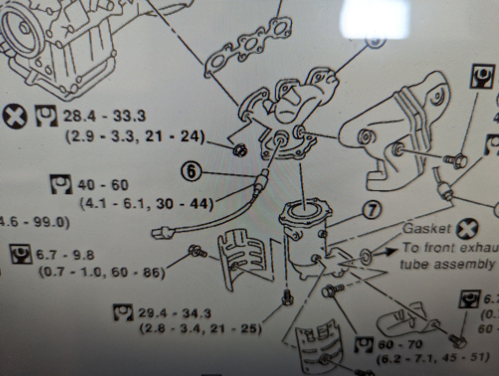

Actually the outer ring around the catalyst material is gasket, it's like ring type crush gasket...
TL"DR
Anyone know that bank 2 pre-cat have gasket or not?
Mine look like this when I remove it, nothing fall out or extra... Thanks
Full story:
Today I had remove both pre-cat to replace the leaking steering rack, but I'm sure that pre-cat has been removed by workshop before judging by the nut is not even hand-tighen at all. After remove it I didn't notice any metal gasket or wire gasket at the manifold to pre-cat mating surface, is this normal? Or maybe I just overlooking something? Thanks

No gasket

It appears you are missing 20840-3Y110 and 20822-3Y100.

Clean the flange and use copper RTV.
There's definitely a gasket stuck around the cat material. Mesh crush gasket, iirc. Slather it all in RTV and reinstall.

You guys must have different cars. I just installed a set for a customer 2 weeks ago. No gasket.
Rear cat does have a crush ring

I just went through replacing these. Its a crush ring gasket.

Again. No gasket for bank 2 but there is a gasket on bank 1
I think you are looking at a 3.5.
Lolol
yep. I'll check a Cali spec de-k tomorrow. Didn't even pay attention to the title. Just saw the pic and mind went right to 3.5
Called it. There is a ring on the Cali spec de-k.
