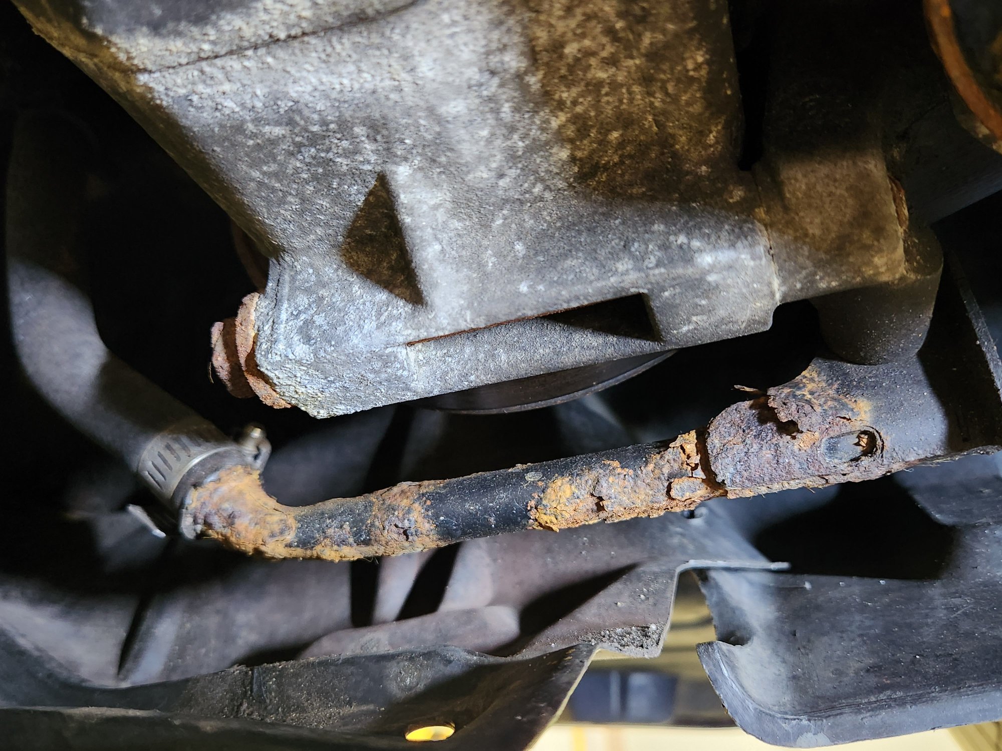

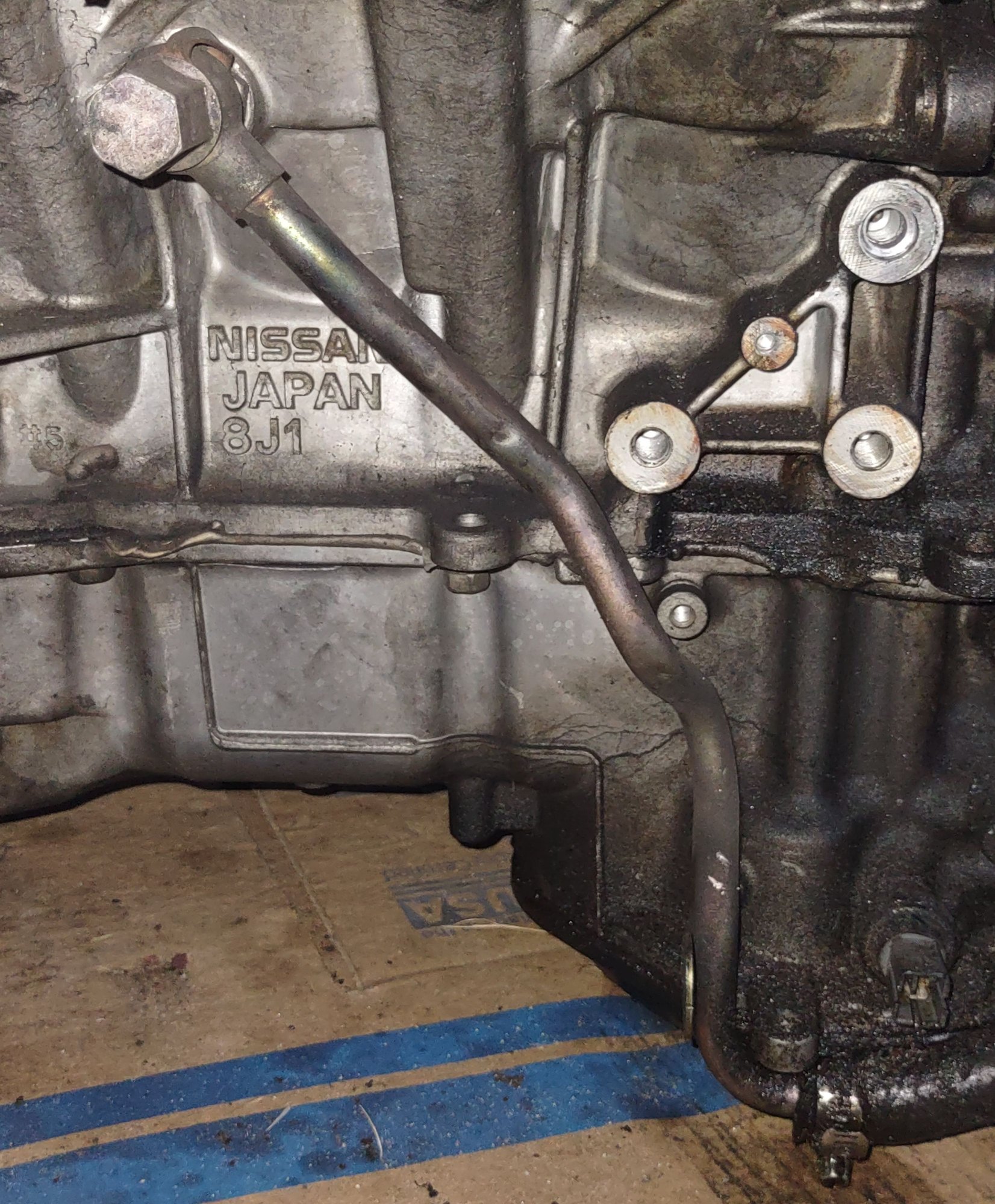

Hello,
Question for those that have encountered the issue of these pipes rusting. See photos attached.
I'm afraid to even touch these pipes at this point as they may crumble.
The pipe that goes from the back of the engine block to the oil cooler (Photo A), this one looks like a PITA to remove from the engine block. I was thinking about cutting it where the rust stop and just getting a new longer curved hose (will be a pain to source one but probably doable)
The pipe that goes from the oil cooler to the thermostat housing (Photo B) I can't even find anywhere. The only one I found was on amazon and Ebay for like $315.00. I am not paying over $300 for a piece of metal pipe. That's a rip-off.
What is everyone doing to replace these 2 pipes?

If it ain't broke, don't fix it. It's likely surface rust anyway. I'd lightly remove all the flakey rust, then spray it with some rust prohibitor.
How's your coolant mix? 50/50? Too much water and not enough coolant encourages rust.

If it was me I would just clean up the rust with sandpaper and if nothing is rusted through or close to rusted through, get a small paintbrush and paint on POR-15 after cleaning it up ol

It may very well be surface rust but last time this scenario happened, I poked a hole through so I'm not removing any flakes or even sanding. That's looking for trouble. I was hoping someone was able to source at least one of the pipes from somewhere and not for $300.
Nah, they rot to nothing in the rust belt. I've replaced these for people a decade ago. I've seen pics of big holes through em lol
Exactly. I'm trying to be proactive by seeing what options I have. Don't want to get stranded out there.
Now, that I also recall, It happened with the oil pan also. I sanded down the pan as I thought it was surface rust. Next thing you know, a pinhole surfaced and there went my oil. A forced oil change

I deleted my oil cooler when I did my swap to simplify things under the hood. I still have the rear oil cooler tube on the block which is still in the garage and it has no rust, Florida car. if your interested just pay for the shipping and it's yours. the rest of the stuff already got picked up by the scrap metal man..

yea i had this go on me in the past, its common in rust belt, i think the shop ended up replacing it with silicone, done. i remember buying the correct part for a shop to replace, they said it wasn't correct and then replaced it with silicone which in hindsight the better thing to do. i can take a pic but yea, very odd design if you ask me, because IIRC that little bit of metal tube just goes into silicone anyway.

These are a common failure point. Every 02+ I have worked on has needed them replaced. Either bypass them or replace them ASAP. They will crumble if you touch them in any way.
The A33 doesn't seem to have a cheaper aftermarket replacement like all the other chassis. I tried the Dorman for other FWD 3.5 vehicles; doesn't fit, different shape.
Thanks for your response, i wouldn't mind seeing a pic of it, thanks.
As jsutter said, the second you touch it, it may crumble, so I'm not going near it!!
On that note, I have plans to try to paint every other tube that's not rusted on the engine. Will take some time

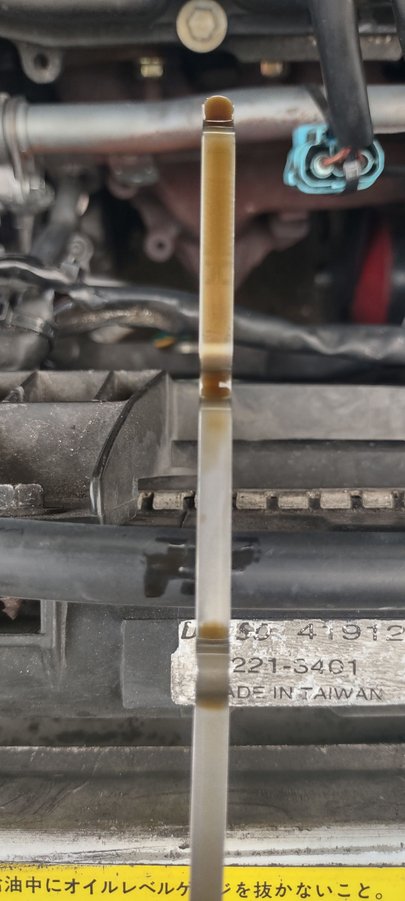

I think a good quality synthetic oil will do just fine without an oil cooler. from what I read online, synthetic oil doesn't start to break down until it reaches 450 degrees fahrenheit. this is how my oil is looking at 4,700 miles with no oil cooler. I'll be doing an oil change in a few days..

That looks good after 4,700. I do run Synthetic blend. It seems to help with Oil burning vs having to add oil more between oil changes. If I do delete the oil cooler, hopefully, the blend will still work ok.

Delete it before it leaves you stranded on the side of the road. Nisformance sells a kit:

thanks for the link. I did check with them and it's out of stock for a few weeks. I did get some info from uptown and what I need so we'll see. Still trying to decide if delete or not. Sometimes, although I don't beat on it, sometimes I'm on the go and just get in it and start driving.
