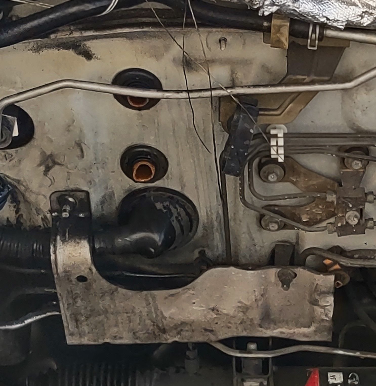

A very big warning on these Pastic Heater Core Water Connectors!
Any GEN5 with its age (mine has 24 years!) and especially high mileage (mine has 251,821 mile), be forewarned that these Water Connectors made of Plastic is just a newer Engine waiting to happen.
I installed a newer Engine November 2022 as the Radiator and Coolant reservoir tank went dry and over heated the original Engine! I blamed it on an After-Market Thermostat and now I am very certain it is these HEATER CORE "PLASTIC" Water coolant Connectors that screw onto the HEATER CORE! If you see wet condition at the Front Passenger floor area then, these are plastic water connectors are your Big Problem and keep an eye on Coolant level should you continue to drive the vehicle.
Here is my thread when I replaced the Factory Engine:
https://maxima.org/forums/5th-genera...er-engine.html
The Entire Heater Core plus these Plastic Water Connectors (Quantity 2), comes out to $500 US assuming you get the Geniune article parts. Labor is extra and let me tell you the removal and replacement is a Pain in the ASHE!
At the best price for just these two (2) Plastic Heater Core Water Connectors (Inlet & Outlet) cost $80+ US each, plus shipping!!
Today, I went ahead and used a Gates 5/8 - inch diameter Water Bypass tube for the two hoses that went to the Heater Core Plastic Water Connectors and therefore, left the Heater abandon in place!
I live in Central Florida and never use the HEATER, even in winter! What Winter???? HA!
This was my solution and it works! Saved me $900+ US by just leaving the Heater Core and those ugly Plastic Water Connectors abandon in place!

UPDATE: Running great and zero leaks!
Just like to follow-up that my 2000 Nissan Maxima GLE is running great and there is zero leaks dripping down on the Front passenger side!
Keeping an eye on the Plastic Coupler that tied the two Heater Hoses together and that GATES product seems to have solve the issue, of course I have no more heater and thereby, will NOT have any Heating.
Living in Central Florida does not present an issue by NOT having a functioning heater as we only have two days of below 32 degrees, at best.
For less than $4 I was able to avoid a very costly Heater Repair!
Keep it on the road good people!

I am in the same boat, both my heater core plastic outlets snapped off as I was pulling the engine. I live in central florida and barely use the heat so I bypasses it above the bellhousing.
