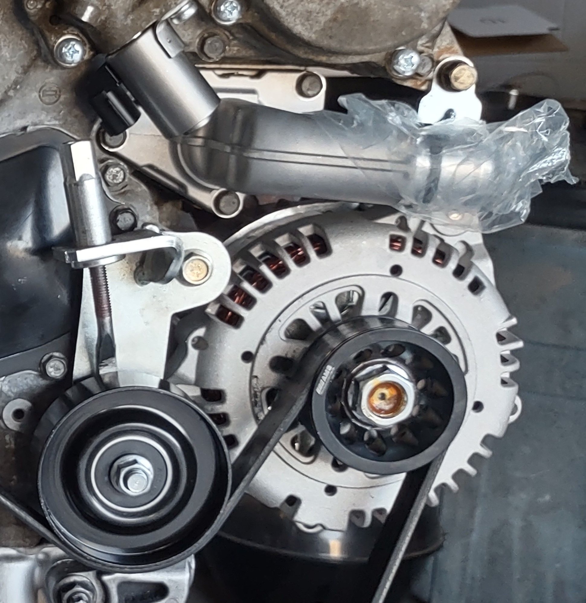

I did my alternator a few times, the pulleys on the Duralast alternators kept coming off. it got easier each time I did it. when I swapped in the 2014 engine I returned the Duralast unit to Autozone for a refund and got a 4th gen 125 amp alternator from Rockauto. I also put a lightweight Z1 motorsports 350Z alternator pulley on it and used orange Loctite on the nut. the extra 15 amps really helps when my stereo is cranked up,I have a small amp for the door speakers and another for the sub.
