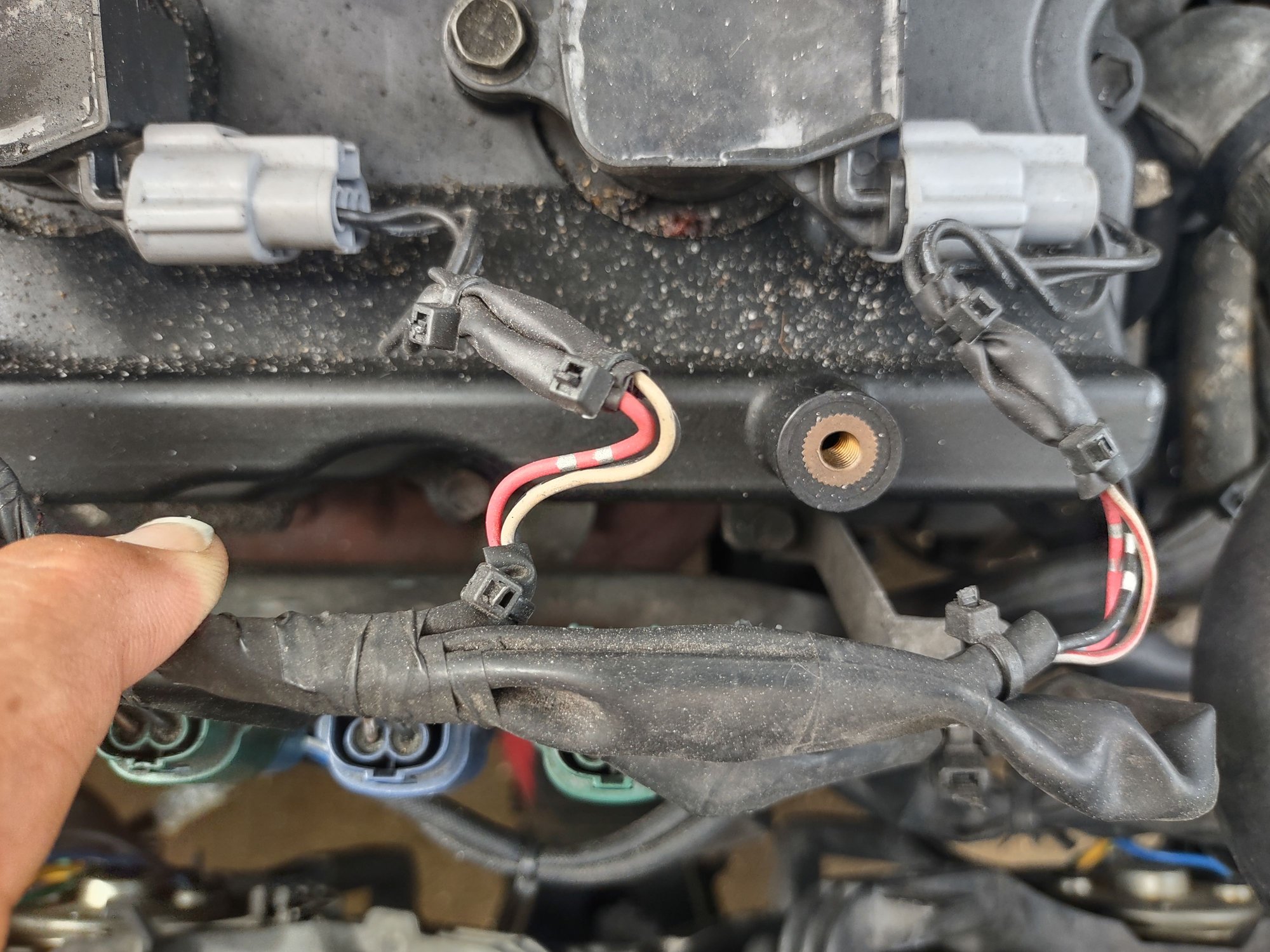

first thing, I would make sure that no oil is getting into the spark plug tubes or cam position sensor connectors.
what brand MAF sensor did you get? I saw a night and day different when going from a new Duralast MAF to a salvaged OEM MAF. engine had smoother and more stable idle along with more power. ...
when my 2002 had the same issue you're describing, new coil connectors solved the problem...
