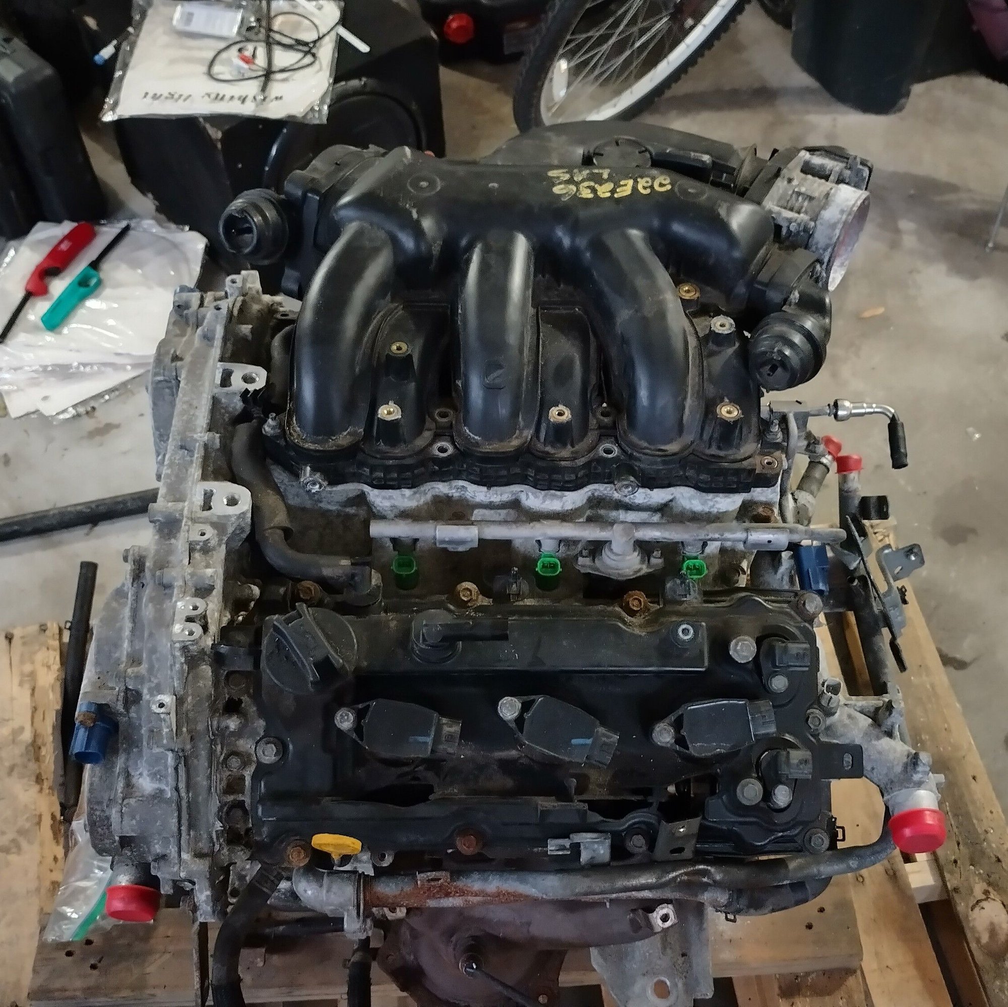

I've been getting a P0021 occasionally since I did my swap but the car runs fines. I'm thinking maybe a sensor issue since the engine came in with valve cover damage from a frontal accident..
