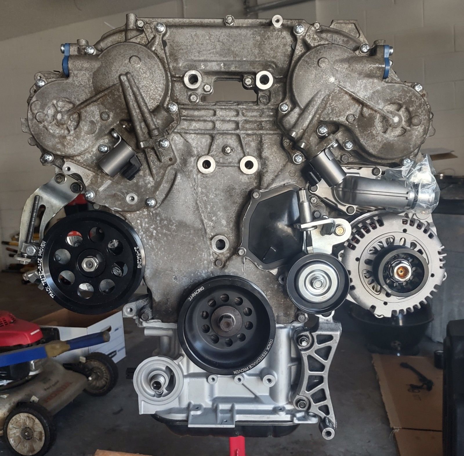

not as much of a pain with the engine out but still time consuming. when it comes to sealing the timing cover as well as oil pan you gotta do serious prep work as well as let it fully cure before putting in oil for a lasting seal.
Old Mar 7, 2024 | 11:30 AM
uptownsamcv's Avatar
Joined: Dec 2012
Posts: 1,345
From: Kissimmee FL
I didn't even wanna pull the timing cover off my engine when it was on the stand lol

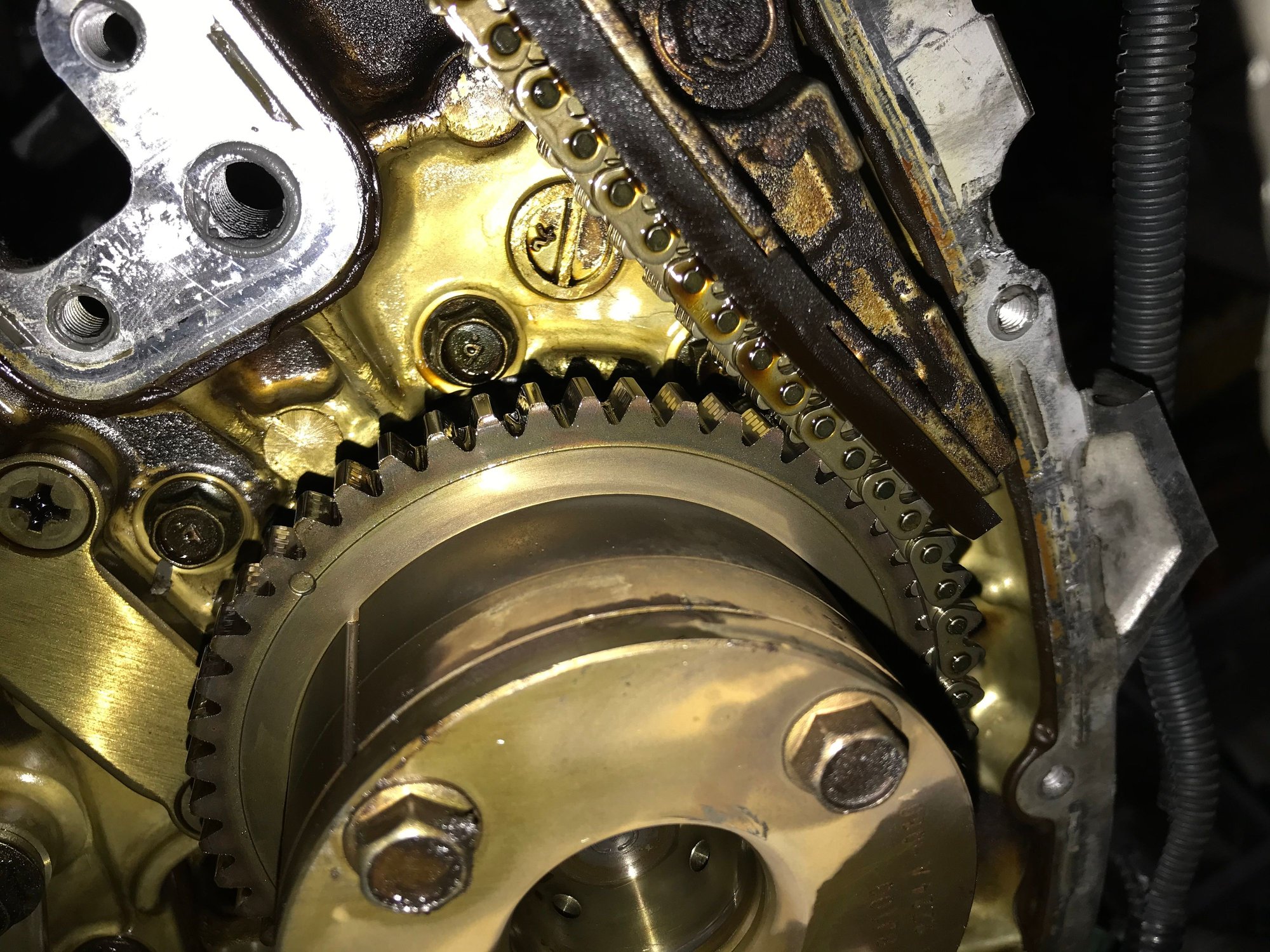

It is possible to fix the problem without removing the engine. I am gifted with small hands and my timing chain problem happened during COVID lock down. So I had lots of free time with nowhere to go.
My skill level is probably similar to yours. My most complex fix until the timing chain tensioner was replacing my entire AC system. My car is 2003 and purchased in 2006. I got plenty of use out of it over the last 2 decades.
My thinking was this. I can’t find a local garage to even give me a quote. I knew that the dealer will charge me more than what the car is worth to fix it. Given my situation and lots of free time, I got brave and tackled the job.
I took a chance and was successful but I was mentally ok with it if I ruined my car and I had to get a new one too.
This picture is upside down but this is what you are looking for once you open the timing chain cover.

Yes - I did it without removing the engine. I took my time and lots of breaks whenever I got stuck but I persevered. I have driven over 15,000 miles since the fix. Engine runs great now.
Given this is an advanced fix, there aren't many YouTube videos on the topic but this is one that I found the most useful for removing timing chain cover without removing the engine. It is a 3 part series. Best of luck if you decide to tackle this job.
