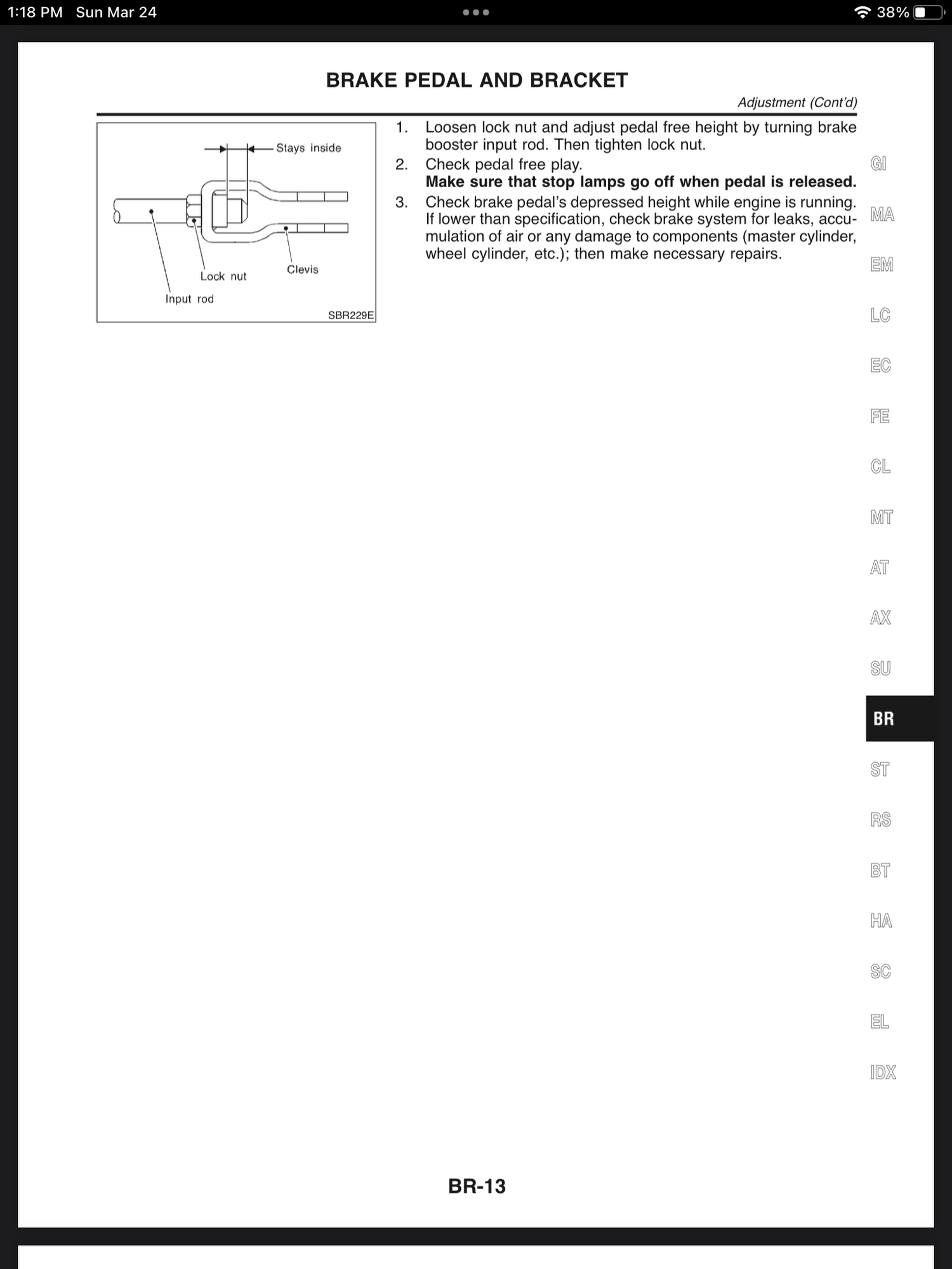

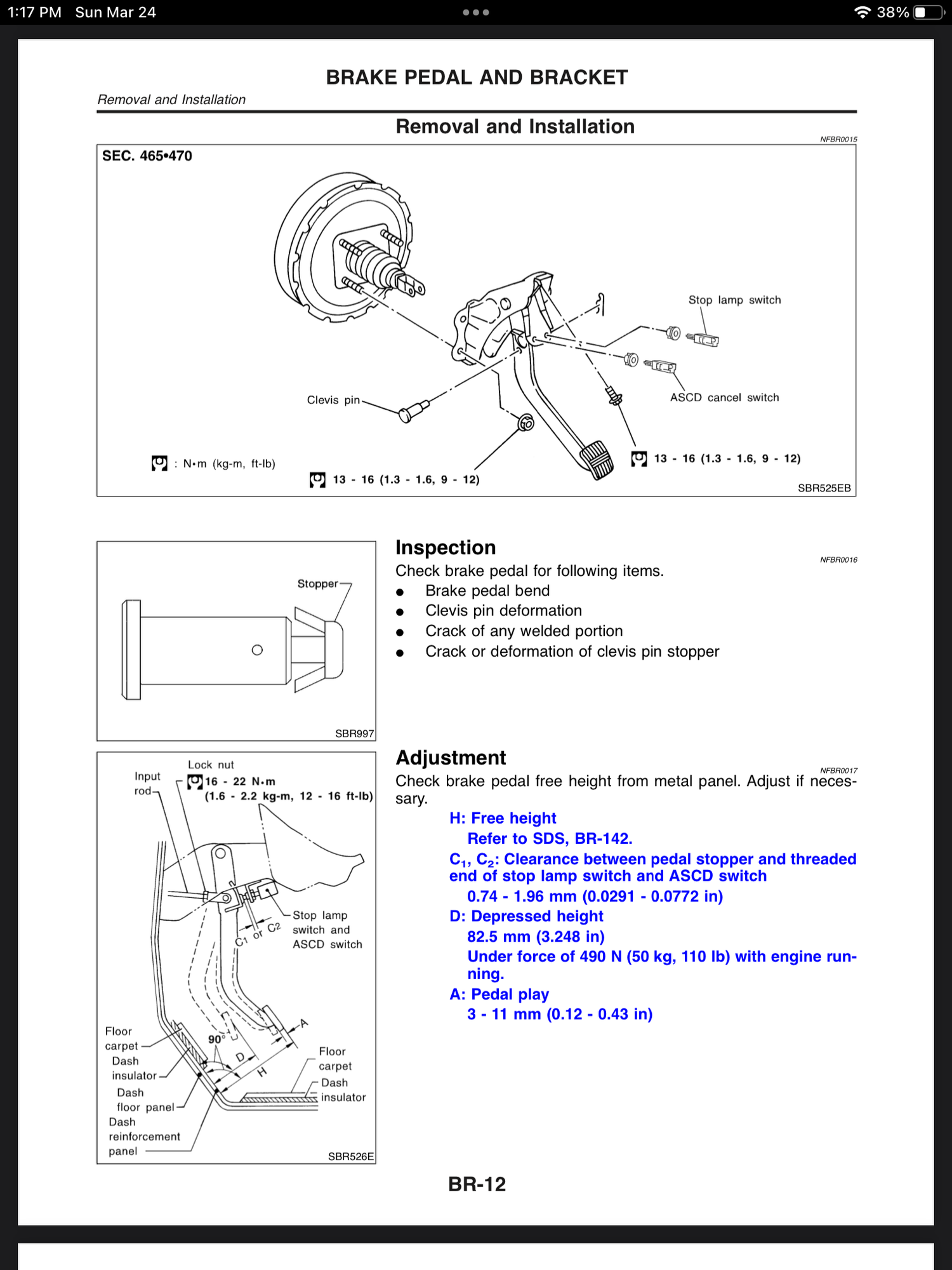

Here is info. from the FSM for the 2003 M.Y.
I’d suggest looking at these items, most notably the condition of the brake pedal clevis pin.
If that turns out good, I’d say replace both switches (stop lamp and cancel).
