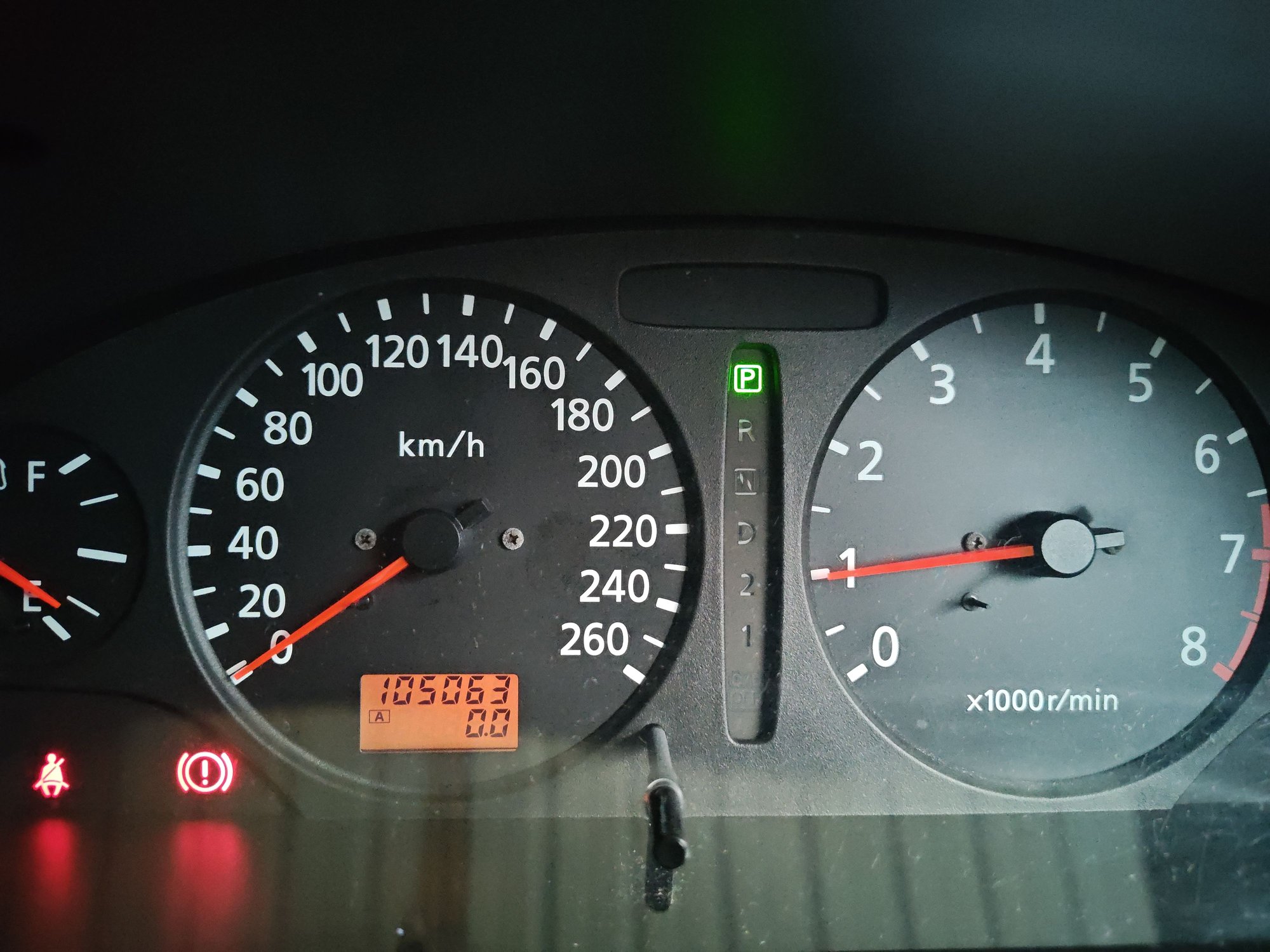

- ODO 101k during purchase - not accurate anymore (due to engine and gearbox change) or pretty much is fake

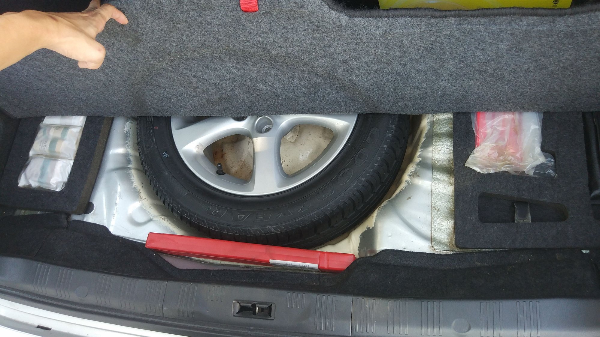

- emergency equipment included: emergency sign. first aid kit, jack, tools.

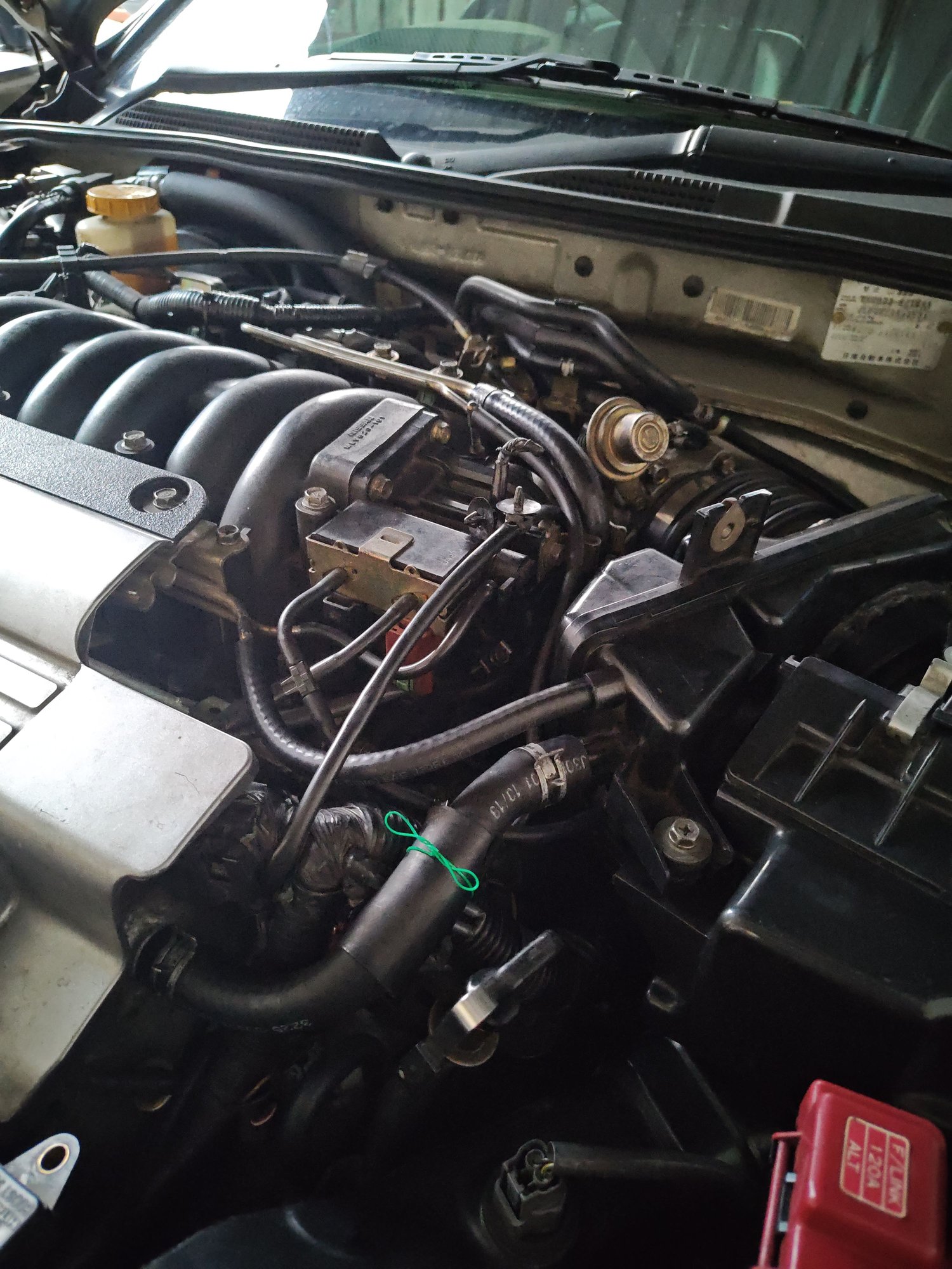

Changed some vacuum pipes last friday:
- "blow-by hose" connecting from front valve cover to intake resonator
- small hose connecting from power steering metal vacuum line near front plug coils to the intake resonator
- PCV pipe (valve already replaced earlier, but the old pipe is leaking)
Not much difference after the vacuum hose change:
- during warm start, no longer surge to 2000-2500rpm the moment the engine is starting like when cold start (now will surge up to 1500rpm only)
- idling not much difference, almost same as after MAF replacement at around 890rpm to 1100rpm.
- little more responsive during low speed driving, however acceleration still lacking when driving at 3rd gear (reluctant to downshift)
Overall, I can't complain much, current state is extremely satisfactory to me already. Able to idle around 1000rpm is good enough. Fuel consumption decreased to about 1.7 liters/hour from 1.9 liters/hour after MAF replacement, as per readings from Consult II.

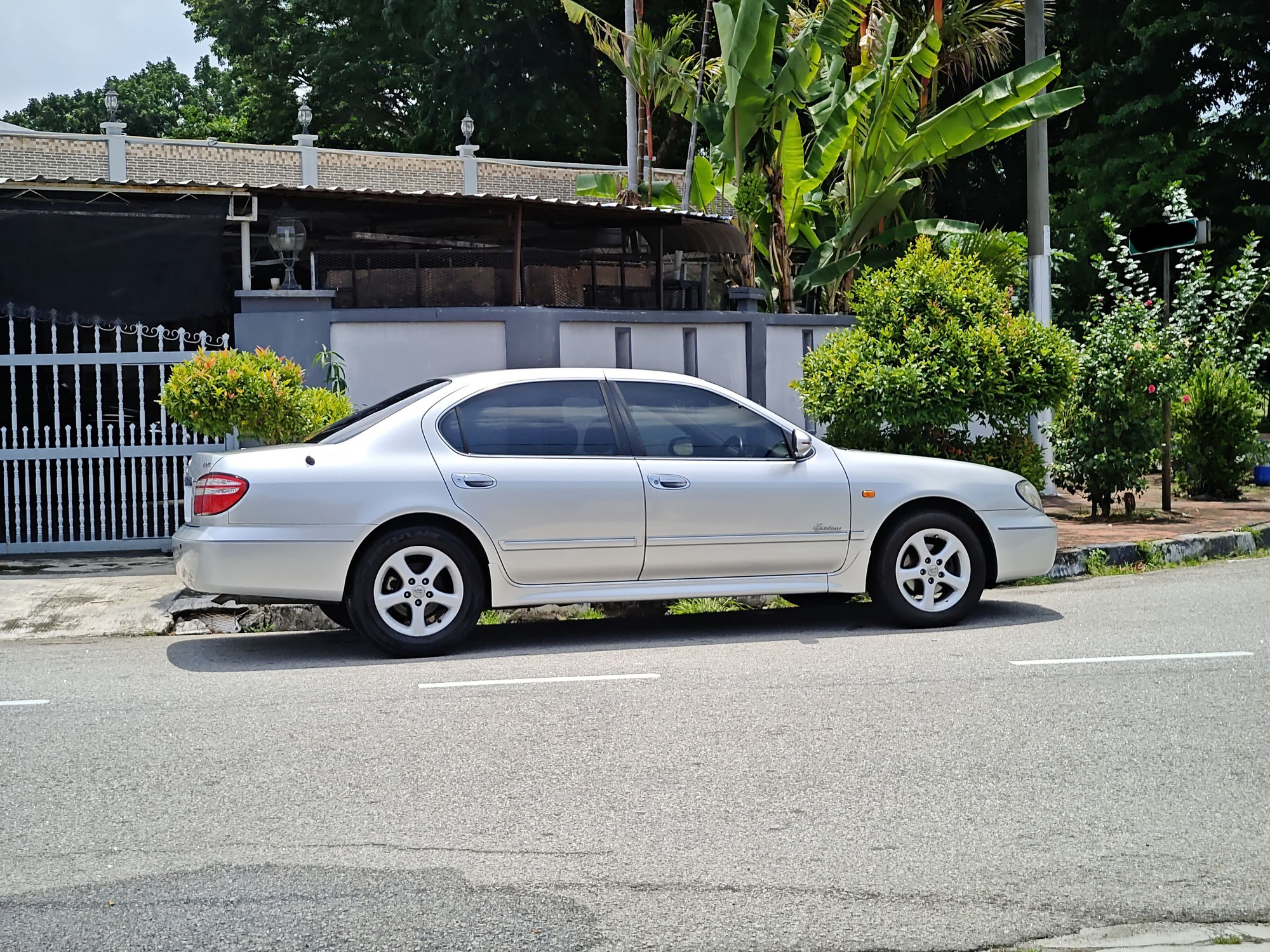

Latest side view photo, taken after changing vacuum pipes and gave her a wash.

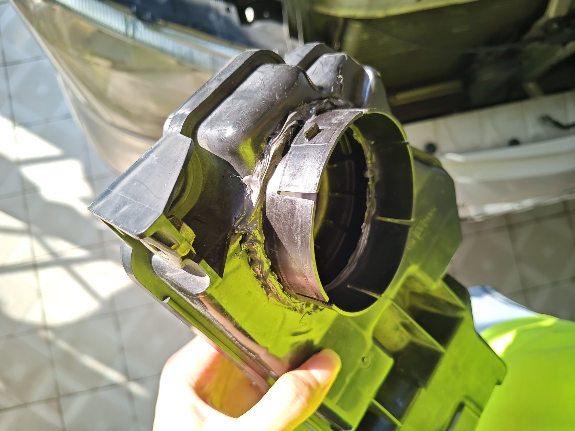

Changed 3 vacuum pipes, the one from the valve cover to intake resonator (the one with cable tie) is hard to insert. Can consider +1mm when choosing the hose size.
And also the S shape is pretty difficult to bend for a stiff hose. I was worry it might damage the intake rubber hose at the throttle body there, as the pipe is trying to straighten itself, exerting a lot pressure to push the resonator box towards the firewall. Hopefully over time the pipe will form the S shape by itself.
Idling around 1000rpm. Can't complain much for now. Attempted idle relearn just now after about 2 hours city driving, unfortunately relearn still can't work (NOT CMPLT after about 30 seconds). Not going to waste further time on this anymore. It's good enough for now. Probably some other stuffs at the engine bay yet to be fixed. (I'm using EconTool app to perform the relearn, as the manual procedure never worked for me, can't get the check engine light to blink).
Seal back broken intake resonator hose connector tube using RTV gasket - holds up pretty well so far.
Glad I try to fix it. Almost bought entire new intake resonator from Nissan for about $50, as unable to find a second hand unit locally, as well as from online.
