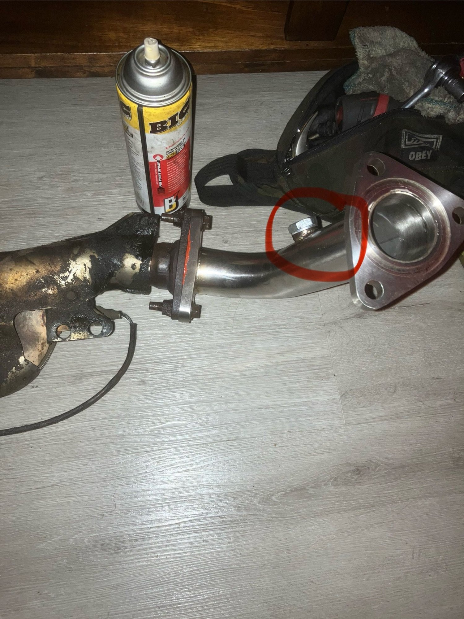

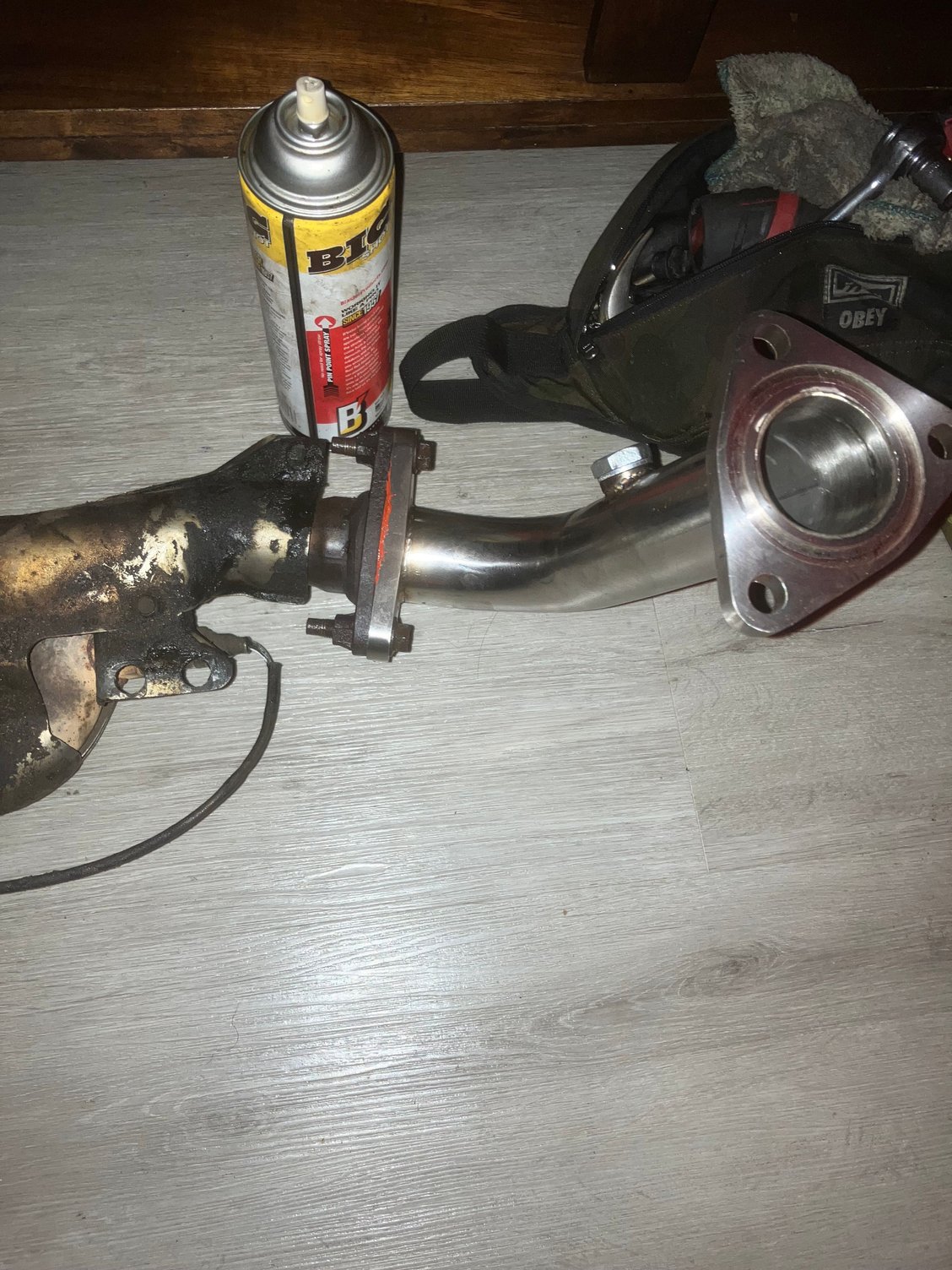

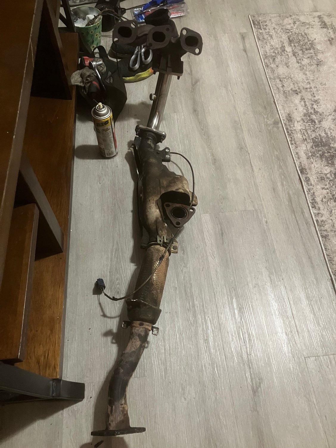

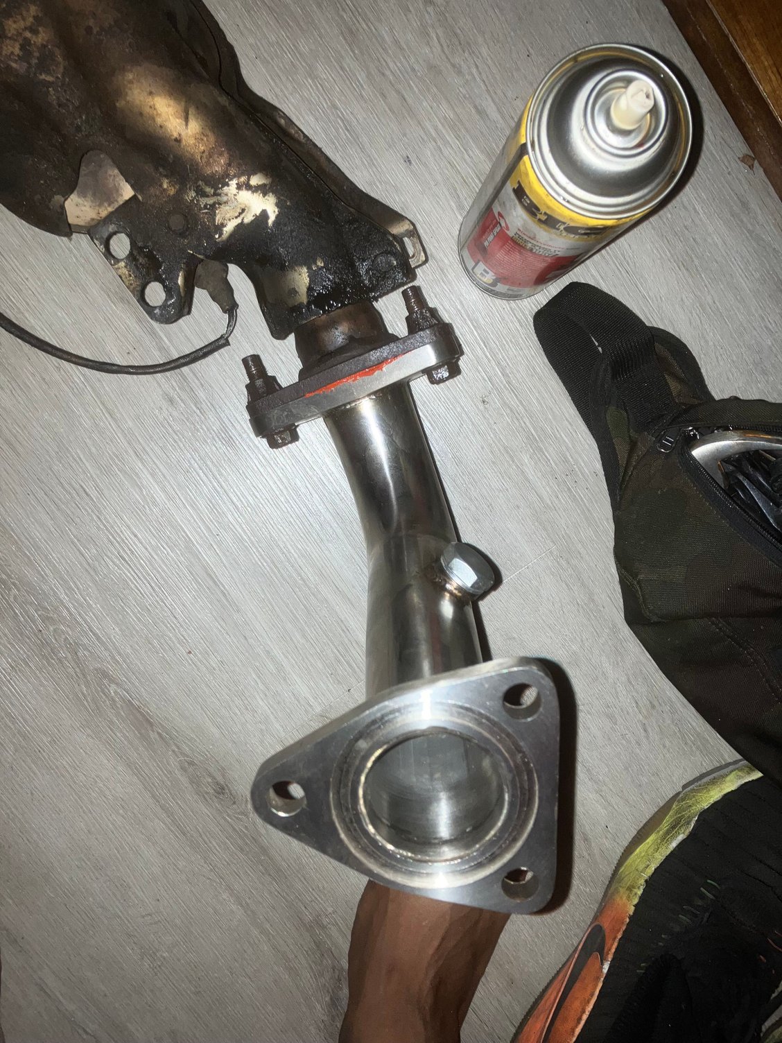

Oem y pipe with precat delete pipe

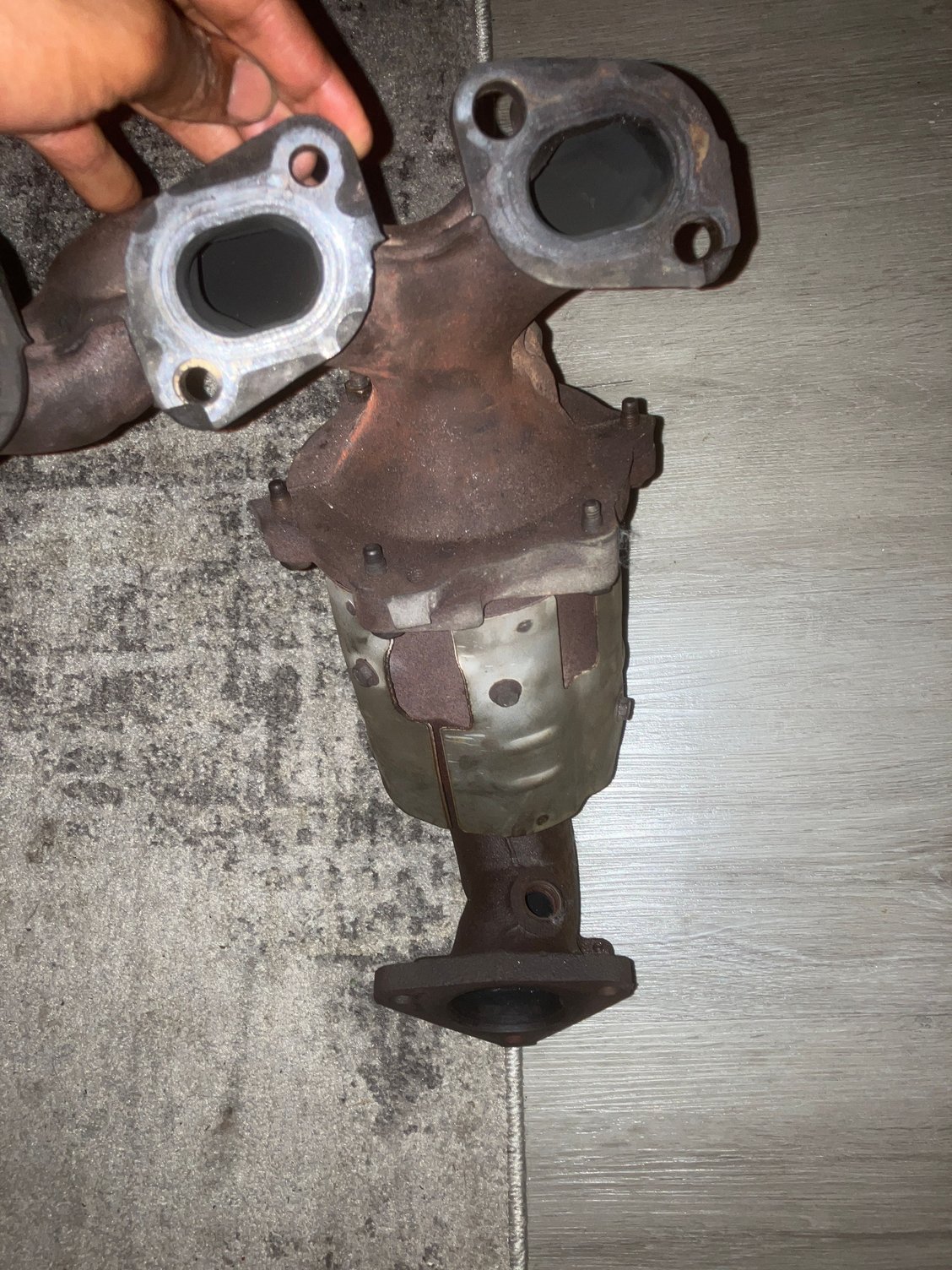

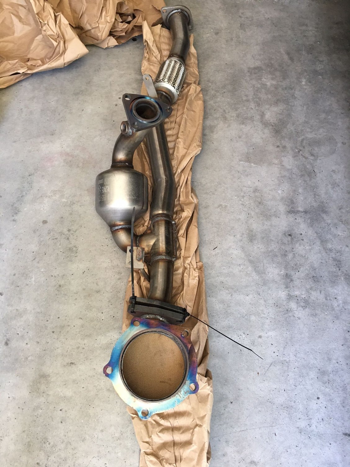

Precat and exhaust manifold off of my 2003 Nissan maxima (restrictive & has a different design from the obx after market y pipe and different design from 4th gen maxima y pipe. If you take your precat off a 5.5 gen maxima you’re going have to replace both manifold and precat with 4th gen manifold and use a flange pipe like mine to delete the precat or get a warp speed y pipe I heard it’s all put together)

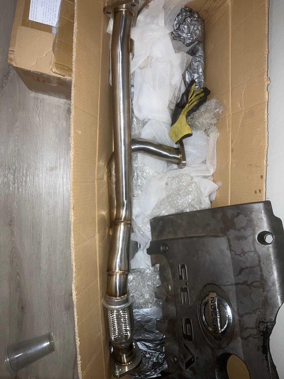

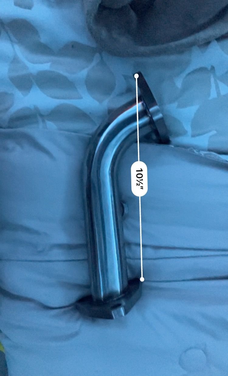

Front precat delete pipe that comes with obx y pipe
OBX Y Pipe that deletes precats ooff 5.5 maxima. Fits good imo will update when installed.
I would like to show you guys my project. I have a 2003 Nissan maxima 3.5L. I already did my first mod BOP install. This is going to my 2nd mod when I install the full y pipe. So long story short my car was throwing a code for random misfire and precatalyst inefficiency. My car was running rich and I had definitely had a misfire in my 2nd cylinder caused by that Stupid fat precat in the front that’s restrictive. I’m guessing it’s blowback. So I took the front manifold pipe that replaces the pre cat off the y pipe I ordered from OBX racing. I then took my oem y pipe off my car and grinded the lip off that sticks out from the y pipe and bolted the pipe together with the oem y pipe and used some exhaust gasket maker. And for the last part ik your all wondering what about the headers well I decided to take a risk and get some 4th gen oem shorty headers off a 4th gen maxima since there less restrictive and installed it into my car and y pipe and it all fits nice. I didn’t bother the rear manifold for now but I plan on doing the rear one when I replace the whole y pipe. I plan on installing the y pipe at a friend so I can safely tilt the motor to get to the rear manifold This is my temporary fix because I did all of this in my parking lot at my apartment it only took me roughly 4 hours using a power drill deep sockets PB blaster!!! And a grinder no special tools needed. And 22mm wrench for those o2 sensors.
If you guys are thinking bout doing this don’t be scared and try it you’ll save some money and you’ll have fun doing it. Trust yourself and take your time and become comfortable with your car. I will be updating throughout build.
obx y pipe- https://www.walmart.com/ip/Stainless-Flex-Pipe-Fitment-For-95-thru-01-Nissan-Maxima-By-OBX-RS/1467687900?wmlspartner=wlpa&selectedSellerId=10119 4874&adid=222222222281467687900_101194874_14997124 4636_18620663426&wl0=&wl1=g&wl2=m&wl3=661038408860 &wl4=aud-2225087347867la-2081188045379&wl5=9011572&wl6=&wl7=&wl8=&wl9=pla&w l10=652721567&wl11=online&wl12=1467687900_10119487 4&veh=sem&gad_source=1&gbraid=0AAAAADmfBIqT3Aitv8S AzZtkLVfMzKSmg&gclid=Cj0KCQjw7ZO0BhDYARIsAFttkCgM-NcWwGteO52juA20uvfVQsOK9h1iaL6QqB_F4Xp3HJCTtAMkJLU aAnL2EALw_wcB

Nice find on that y pipe. Wish I knew about it when I threw some stock dek manifolds in my last 4th gen.
Where'd you get that front pipe?

It came with the y pipe that I ordered from Walmart online. It’s the obx y pipe it does not say it includes that piece of pipe but it Does come with the y pipe.

the front pipe comes with the obx y pipe

Welcome to the Maxima forums! Nice work with the pre-cat delete. I'll be installing the Magnaflow front and rear pre-cats soon on my 01 AE to pass the CA smog

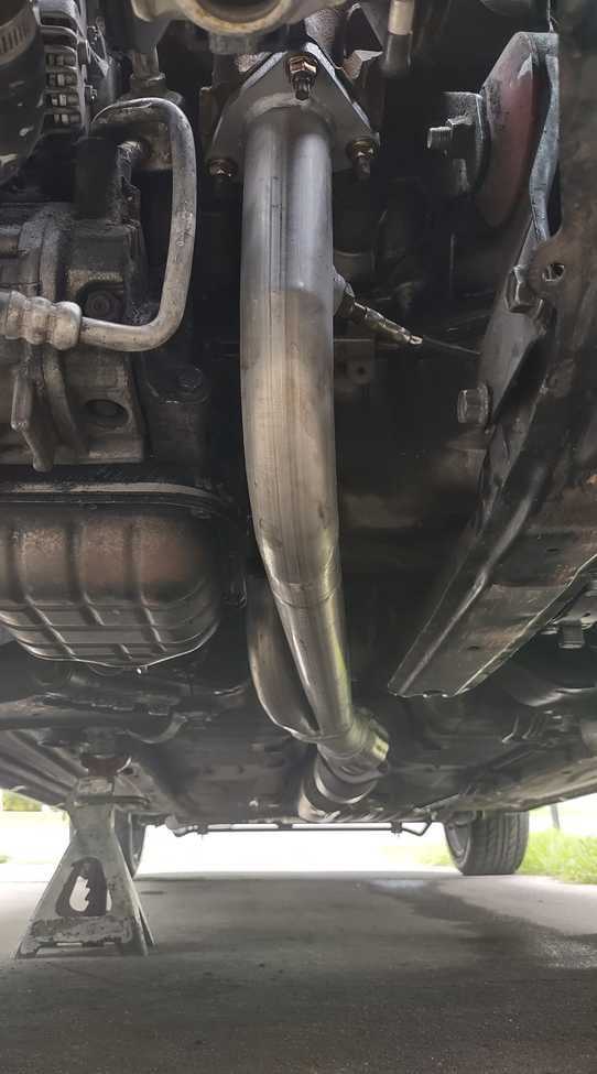

F
Front precat deleted
stock Y pipe and rear precat is still on
3.0 front exhaust manifold

Nice set up! It looks just like the Budget Y-pipe that I had on my Fed Spec 97 SE. The car sounded great with Frankencar intake and Y-pipe.

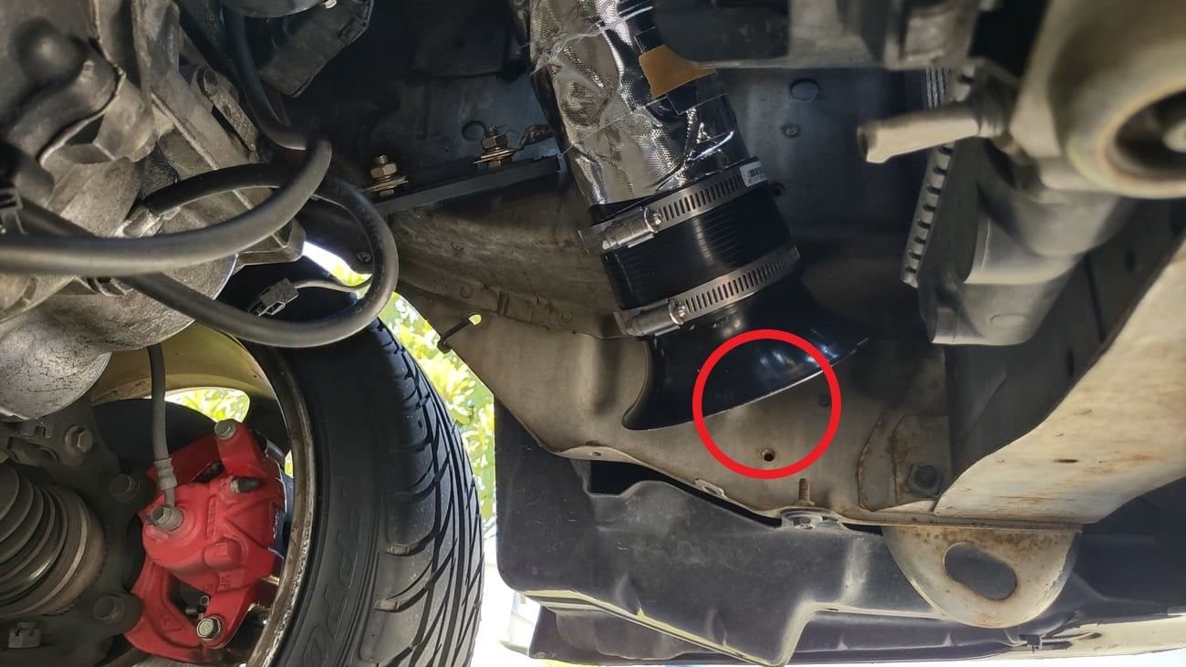

would your intake be considered a cold air intake now that it’s under the car in the position it is in.
Another question do you have problems with driving through rain or wet conditions? I’ve heard of cold air intakes water locking the engine that’s why I was looking of going down the Short Ram hot air intake route to be safe because I live in Florida the weather is unpredictable.

I live in central Florida and so far it's been over 2 years since I started running that intake setup with no issues. I knew the car needed cooler air cause of the amount of power it would lose sitting in traffic on a hot day. my car didn't come with the stock snorkel so eventually I got one which helped, than a bit later I made the larger snorkel. I plan to cut a hole as shown in the diagram to sock air from behind the fog light which I will probably get rid of because I'm tired of replacing them when they crack.

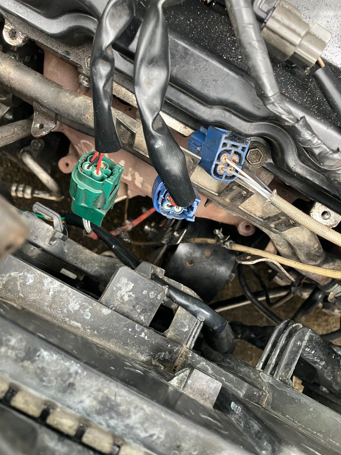

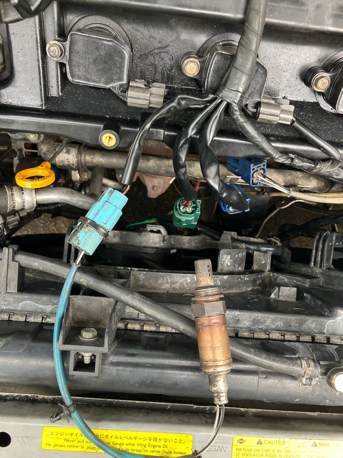

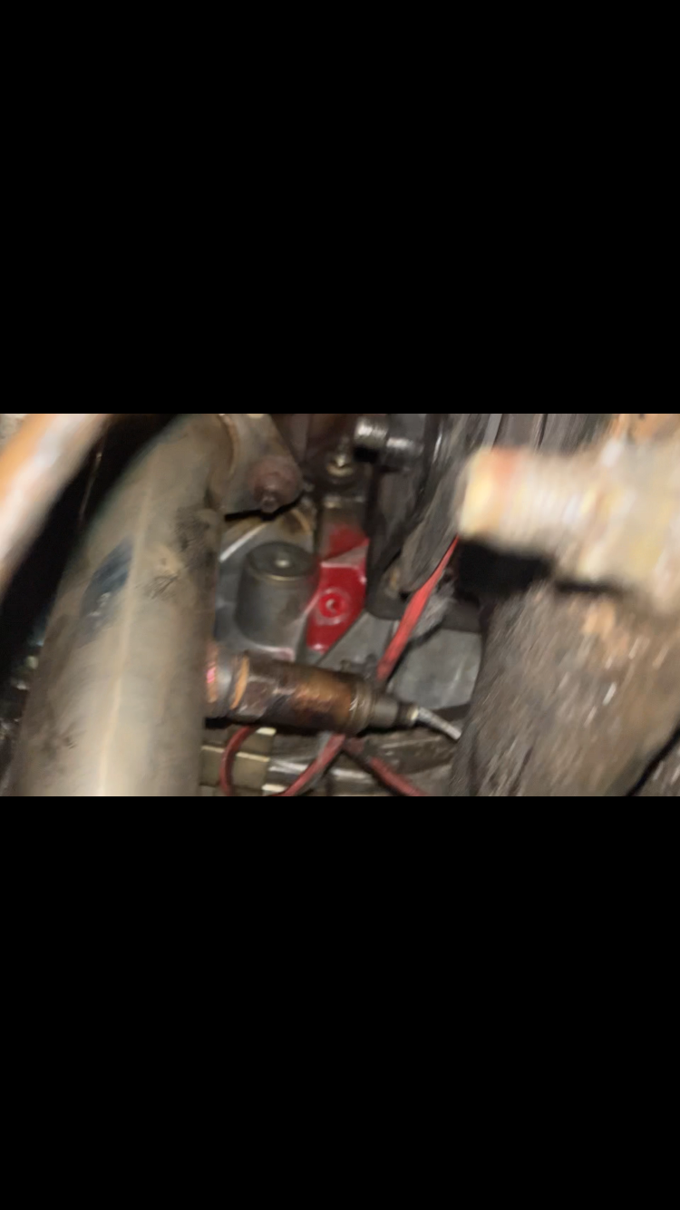

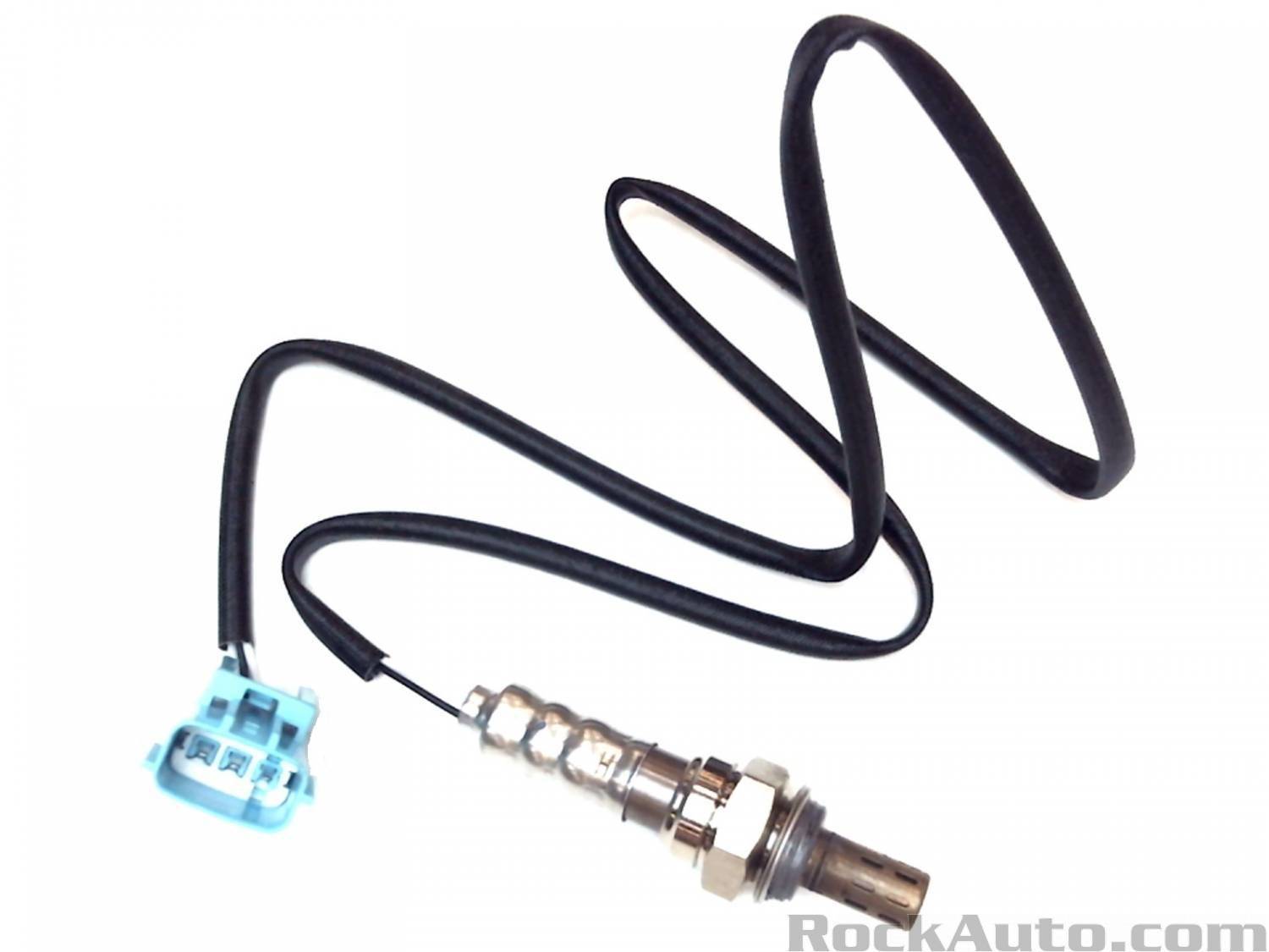

O2 sensor (bank 2 sensor 1)
After installing 3.0 exhaust manifold I run into the problem of not having anywhere to put the o2 sensor that was in stock 3.5 exhaust manifold. The front exhaust manifold on the 3.0 does not have a o2 bung. So I guess ima have to take the manifold off (not hard) and drill a hole in it. Any of you guys run into this problem or heard of this problem I would like to hear other solutions.

my ECU is flashed to delete the secondary O2 sensors. it's best to add O2 bungs to the Y instead of the exhaust manifold.
if you haven't flashed your ECU yet it's a must. with the intake cam timing adjusted and other tweaks it makes a huge difference up top. the DE is just a choked and detuned base model Z engine. same heads, cams, and pistons.

You need to keep the sensors that were closest to the engine. They are necessary. The O2 sensor that was in the manifold will go in the new Y extension. The O2 that was after/with the cat will need a new home. You can put it anywhere and do the spacer trick with it. The best place for it will be after a functioning cat. Do you have the rear most cat?

I HAVE one o2 sensor not connected. The precat o2 sensor is installed.
this sensor was in my old exhaust manifold and now has no home there is no bung on 3.0 exhaust manifold.
I have not bothered the rear o2 sensors or the y pipe o2 sensor

drill and weld a bung into the y-pipe after the manifold flange. i would recommend against drilling and tapping the cast manifold for an o2.
Old Jul 10, 2024 | 12:07 PM
Krisko's Avatar
Joined: Jul 2024
Posts: 15
so I would weld another o2 bunge above the one I have now right under the manifold flange?

correct. above/below/next to. doesnt matter.

yes, add another O2 bung and use a spacer for the downstream 02 sensor..
one thing I discovered is that the 01-02 Pathfinder left side upstream O2 sensor has long wires if needed.

I will go to the junkyard and find that o2 sensor for the pathfinder. And I’m going to buy an o2 bung clamp that eliminates that use of welding just drill a hole and clamp the sleeve on. Thanks everyone for the advice. When I install the full y pipe I might try that ecu trick to delete that o2 sensors. I don’t want to send my ecu off I’ve heard mixed reviews so I might try and learn how to tune it myself with the vAFC or Safc. Whatever option seems easy for me to do

do it right or open yourself up for other problems.

never buy a used O2 sensor. a used OEM MAF sensor is the only thing I would buy used.
as for sending off the ECU, Darren at Nisformance knows what he's doing. exhaust and ECU flash really awakens the choked down DE

Went to the junkyard and all the pathfinder motors were pulled out or o2 sensors missing. Came back home and spliced the tape around the engine harness that comes up to the o2 sensor and spark plug connectors. It freed up a lot of slack. I’ll post a pic this afternoon. Will be installing aluminum radiator next week just ordered it. Won’t be posting in this thread no more until I do my rear manifold and y pipe install don’t want to get off topic from the the title of it.
