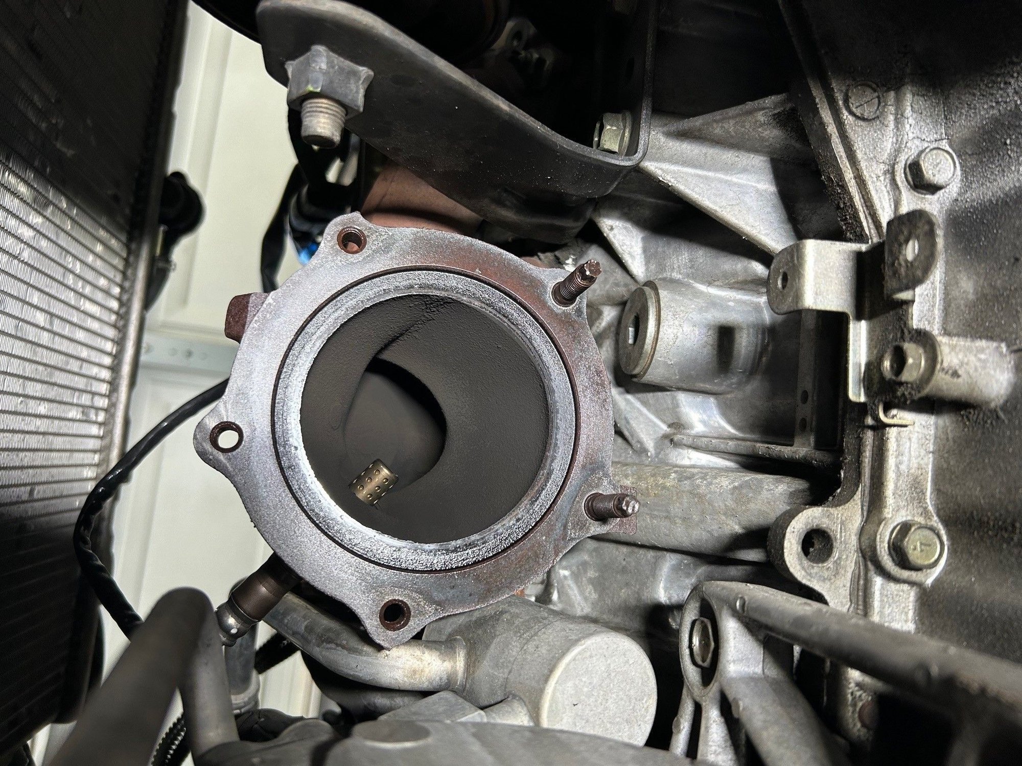

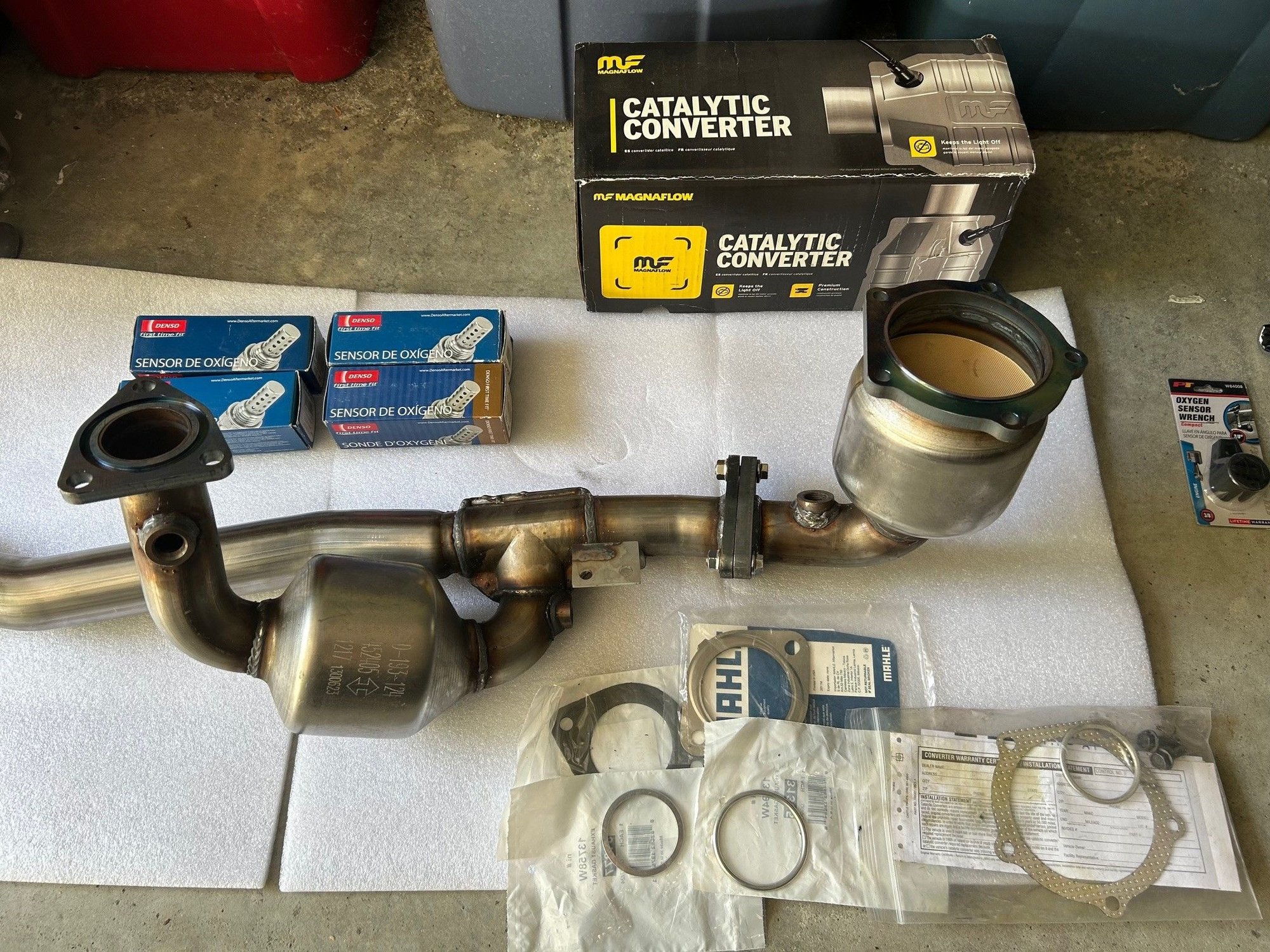

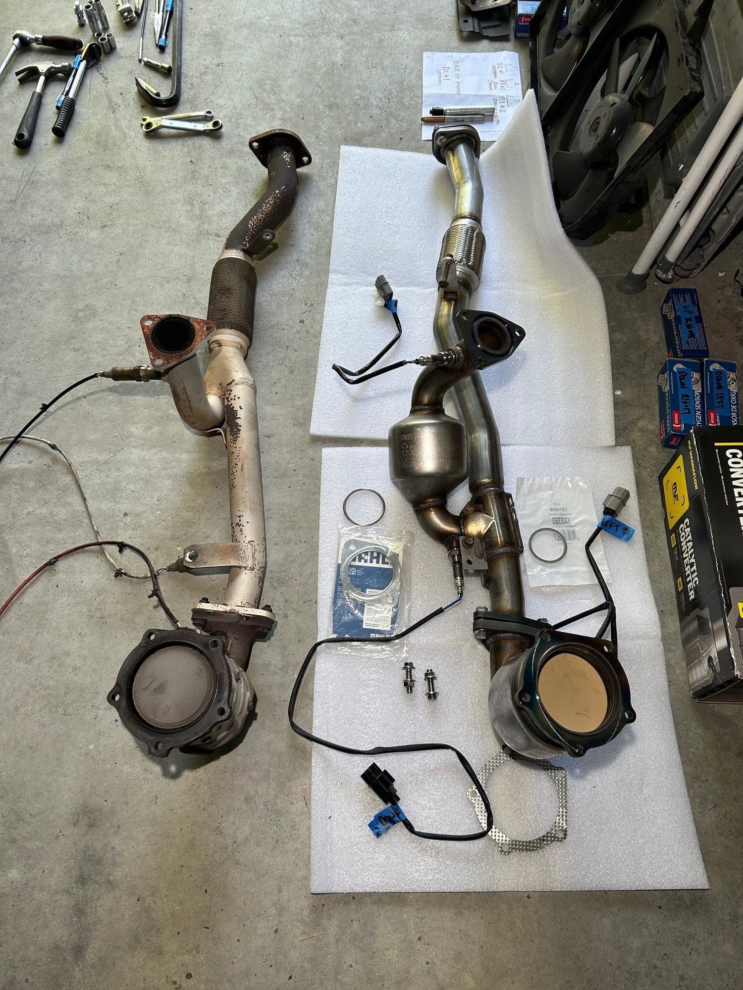

I recently bought 2001 SE AE 5 speed that came with an aftermarket Y-pipe with O2 spacers. Since I’m keeping the Maxima until the wheels fall off, and I live in CA where the smog stations do a visual inspection my car would not pass the bi-annual smog check without going for under the table smog and that gets very expensive.

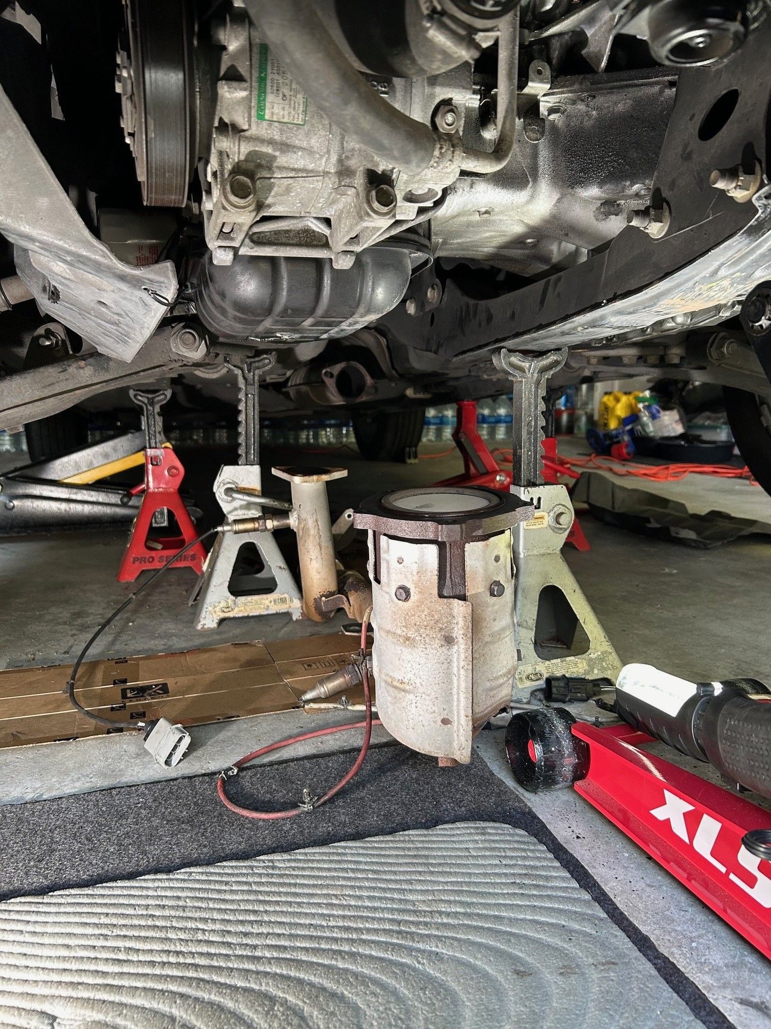

I decided to go with the MagnaFlow CA CARB compliant front and rear pre-cats since I was able to buy them on Ebay with a significant discount (damaged box) and I am happy to report that I was able to install them at home without having to cut/grind/weld anything. Also installed four brand new Denso O2 sensors, new gaskets and SS hardware.

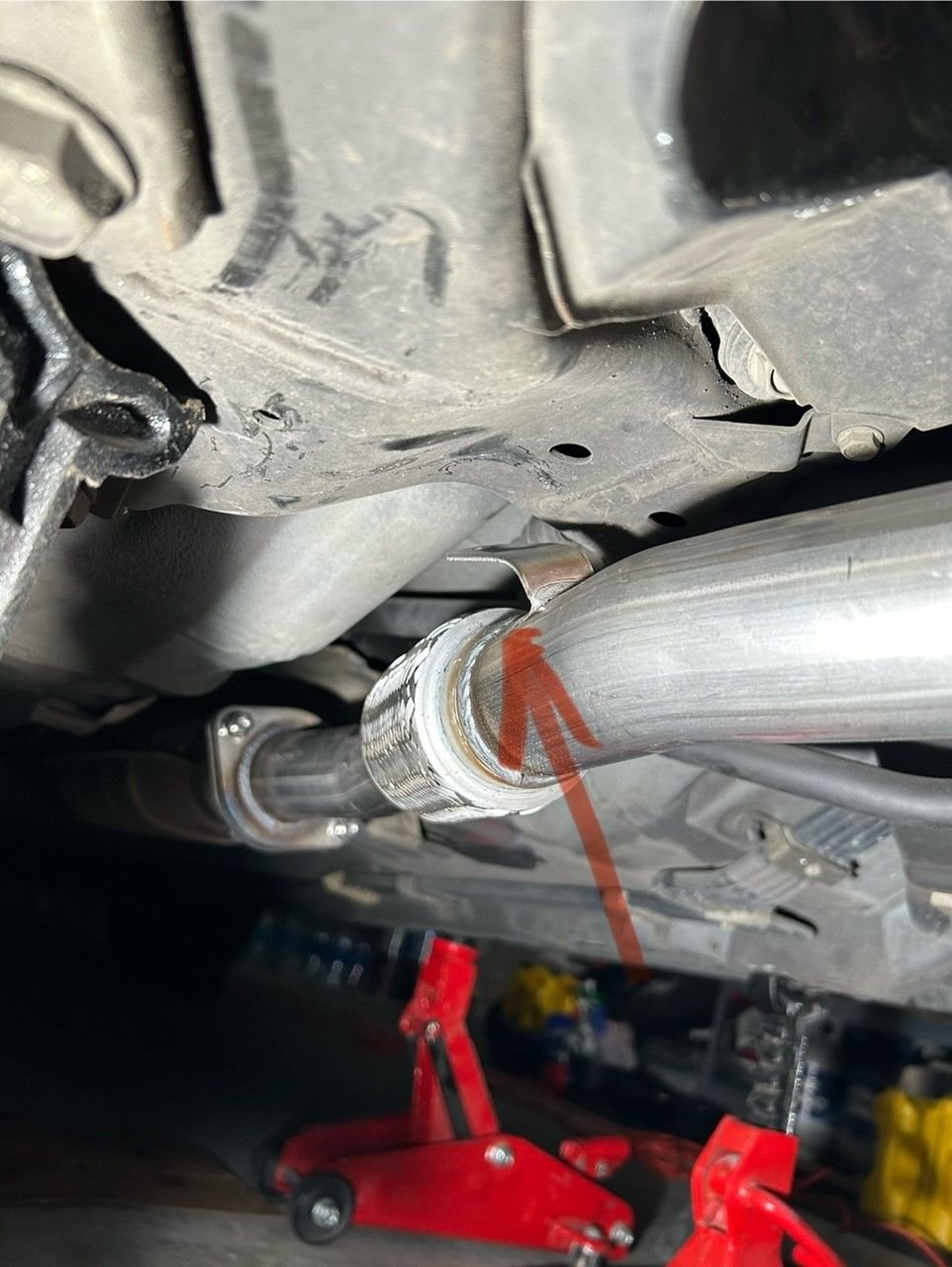

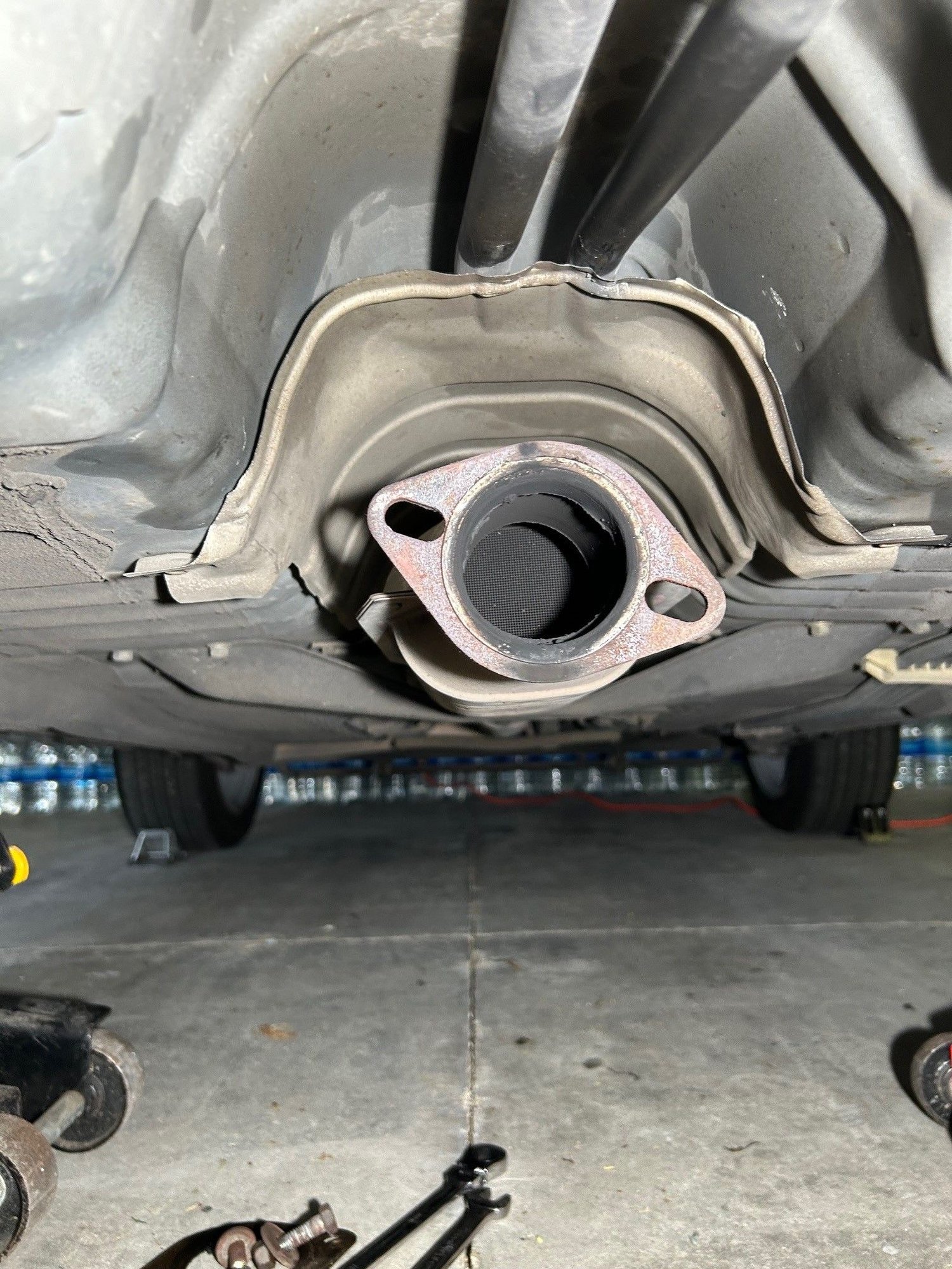

-Magnaflow welded the rear section mounting bracket in the wrong spot, so I had to bend the bracket about 90 degrees to clear the underside of the car and allow the Y-pipe to line up with the main cat flange.

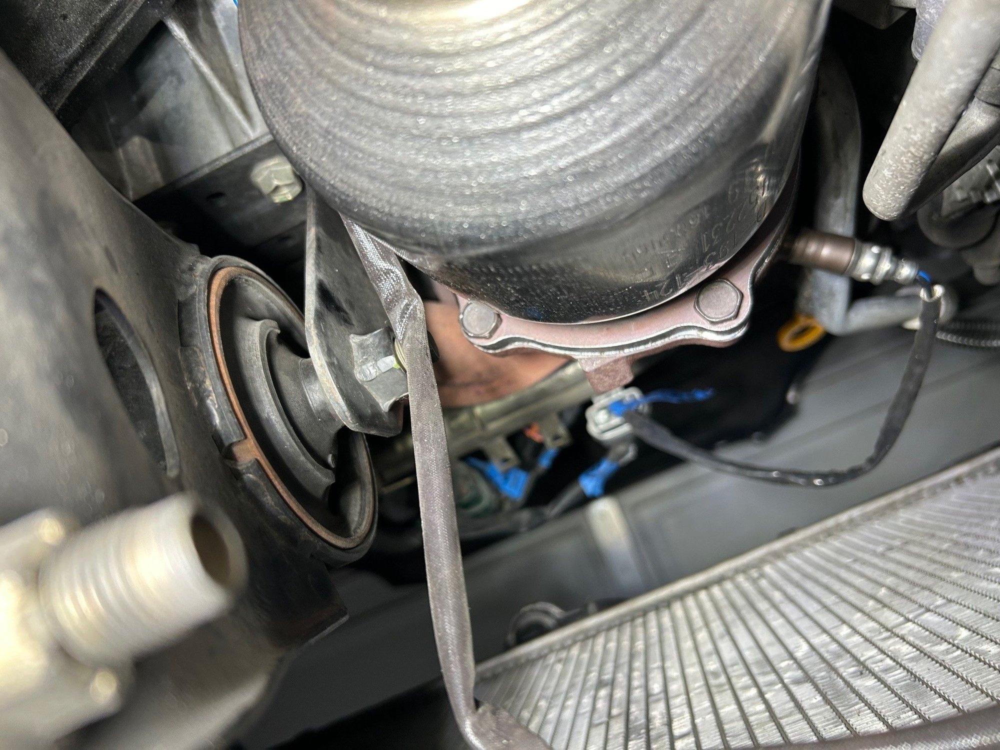

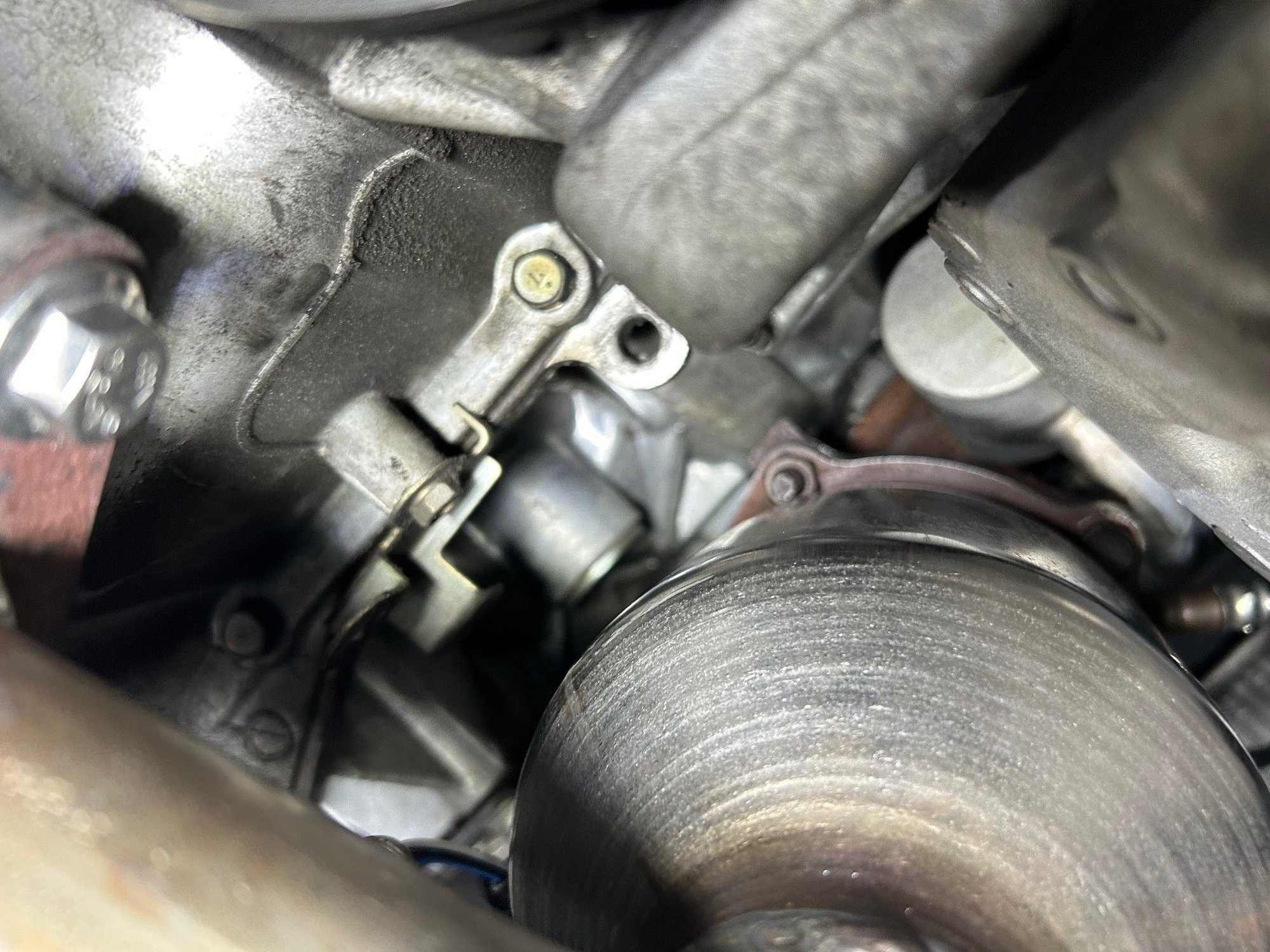

-The front pre-cat is rounder and fatter than the OEM pre-cat which makes tightening the 3 flange bolts and two 13mm nuts difficult since the access is very limited. I used a short stubby13mm open end wrench and even with that getting the rear two 13mm nuts was very difficult.

Fits well before final tightening
Had to bend this bracket 90 deg to clear

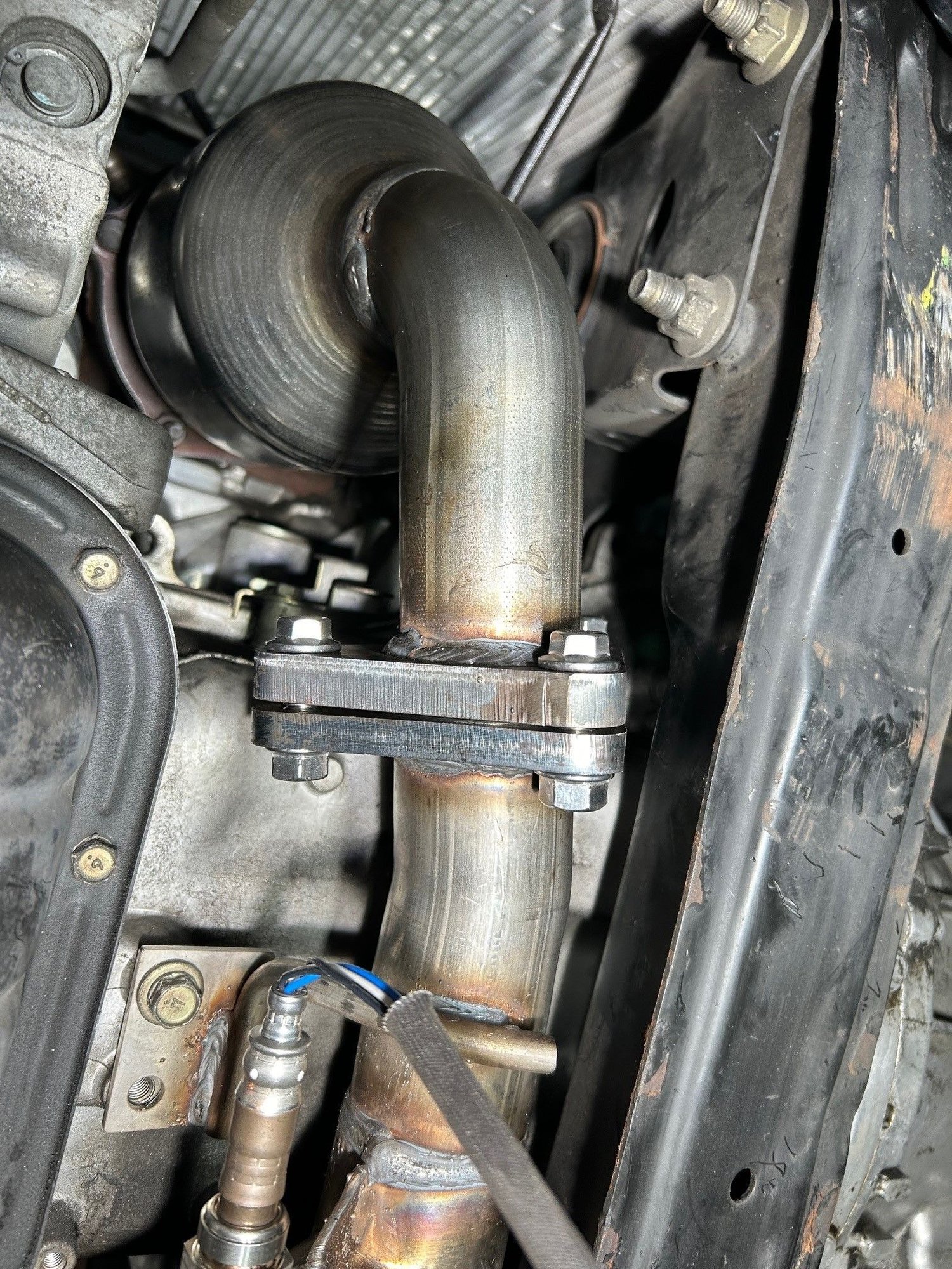

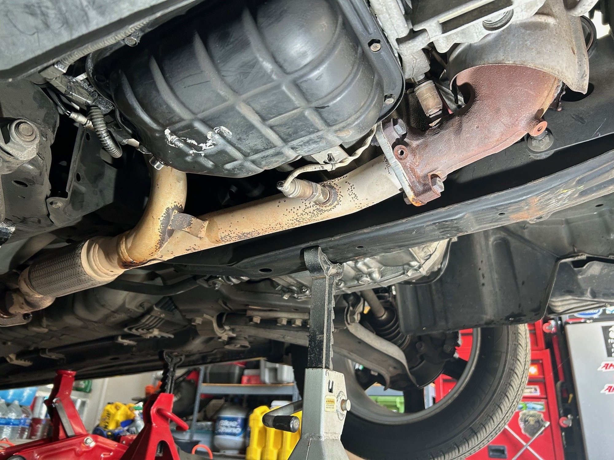

Not sure what brand the Y-pipe is
Happy that the previous owner didn't overtighten the bolts
New Denso O2 sensors from RockAuto
O2 spacers
Removed the front header heat shield and cooling fans for better access

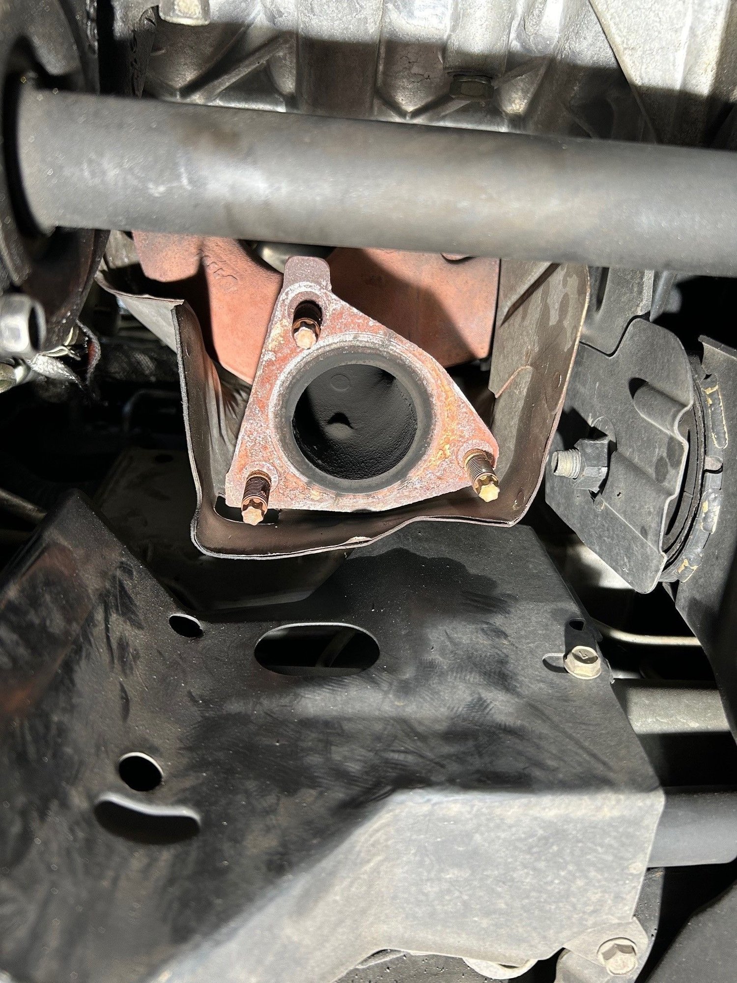

Three 13 mm bolts and two 13 mm nuts secure the front pre cat to the header flange
Bank 1 flange
Main cat
MagnaFlow front pre cat is wider and fatter and this makes the bolt tightening more difficult due to limited access
Used short stubby 13 open end wrench
Flange before final tightening
Magnaflow part numbers for 2000-2001 Maxima CA CARB
