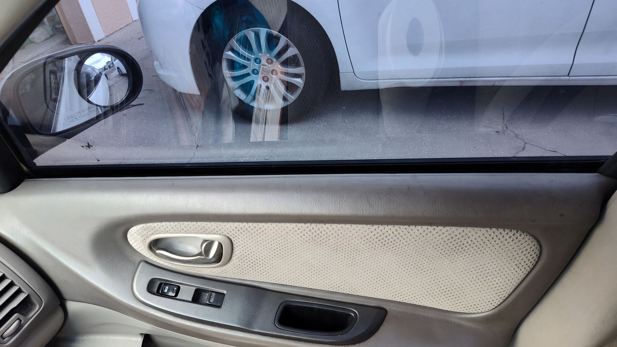

I've got 2 windows I cannot roll down because the inner door seal drags on the glass and slows down the window motor or stops it completely. This inner seal appears to detach itself from the door trim, starting in the middle, and disappears behind the top of the door trim as the window attempts to roll down. If I really wanted the window down, I have to help it by pushing down on the top of the glass after it has rolled down 2 or 3 inches, or enough to get my hand in the gap. Even then it doesn't really work, the rubber seal squeals a bit and you can tell the motor is struggling; I don't force it because I don't want to burn up the motors. Windows roll up fine, or as well as they can for a 20+ year old car.

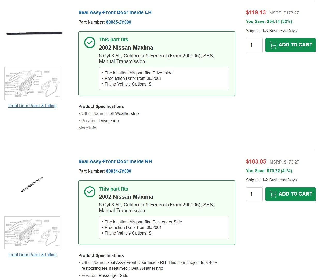

the inner seals have felt on them and once they wear out the window is sliding against rubber. I had the same issue a while back and once I looked up the price for each I just decided to remove them.

Oh wow, I did not know they had felt on them but knew some cars did. I just figured the Maxima was different and that something else was wrong like UV damage or age on the rubber, plus it's used and I am the second owner, so what do I know?
Was the felt attached or bonded only to the side that faces the glass?
And again fantastic, thanks for sharing the pics as well, speaks volumes. I will not be shelling out that kind of money on this old heap.
So lastly, how are your windows doing with the inner seals removed?
