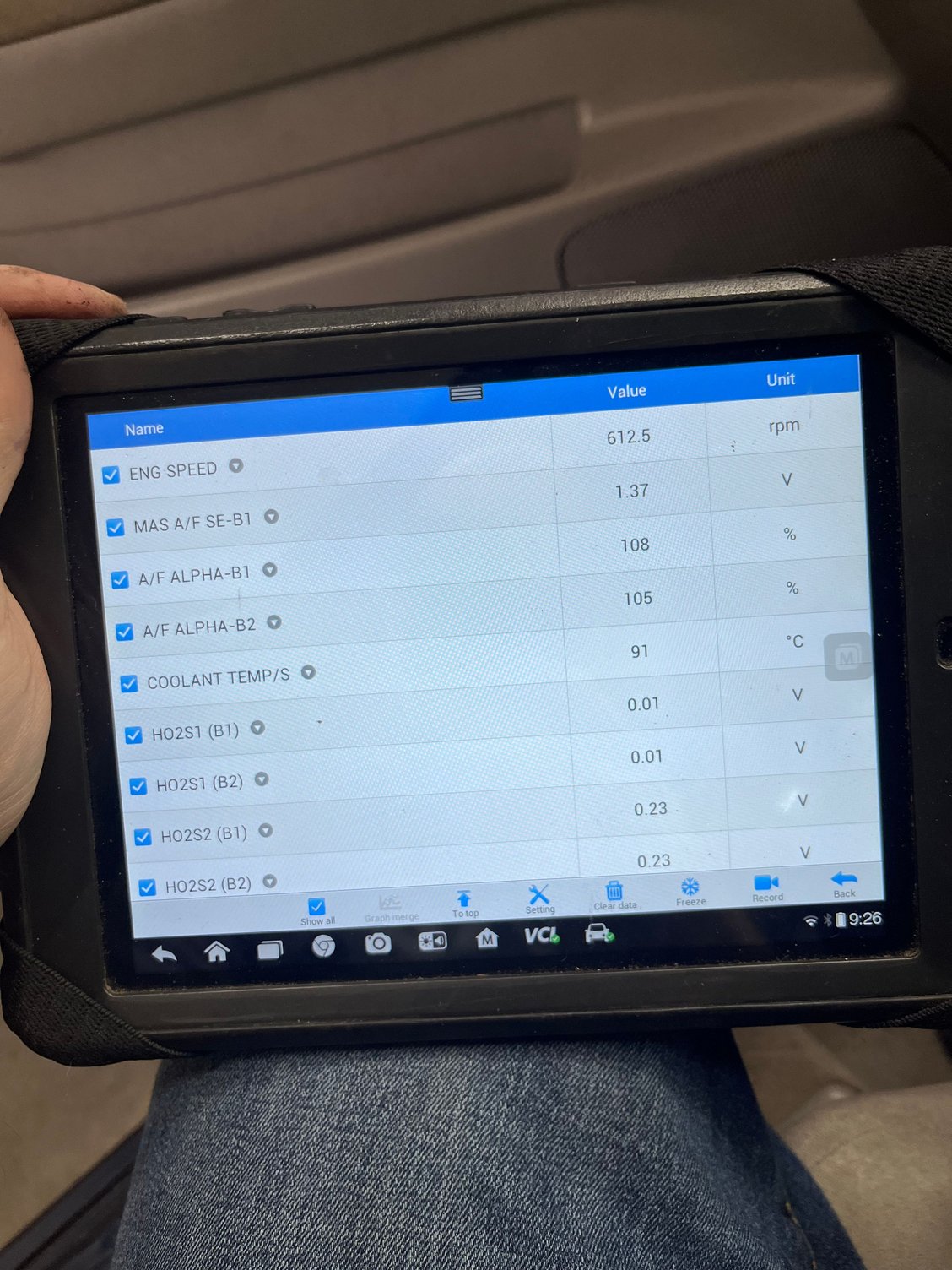

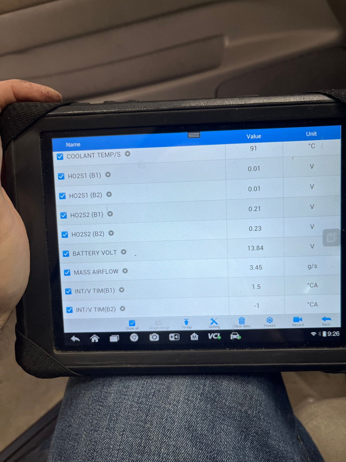

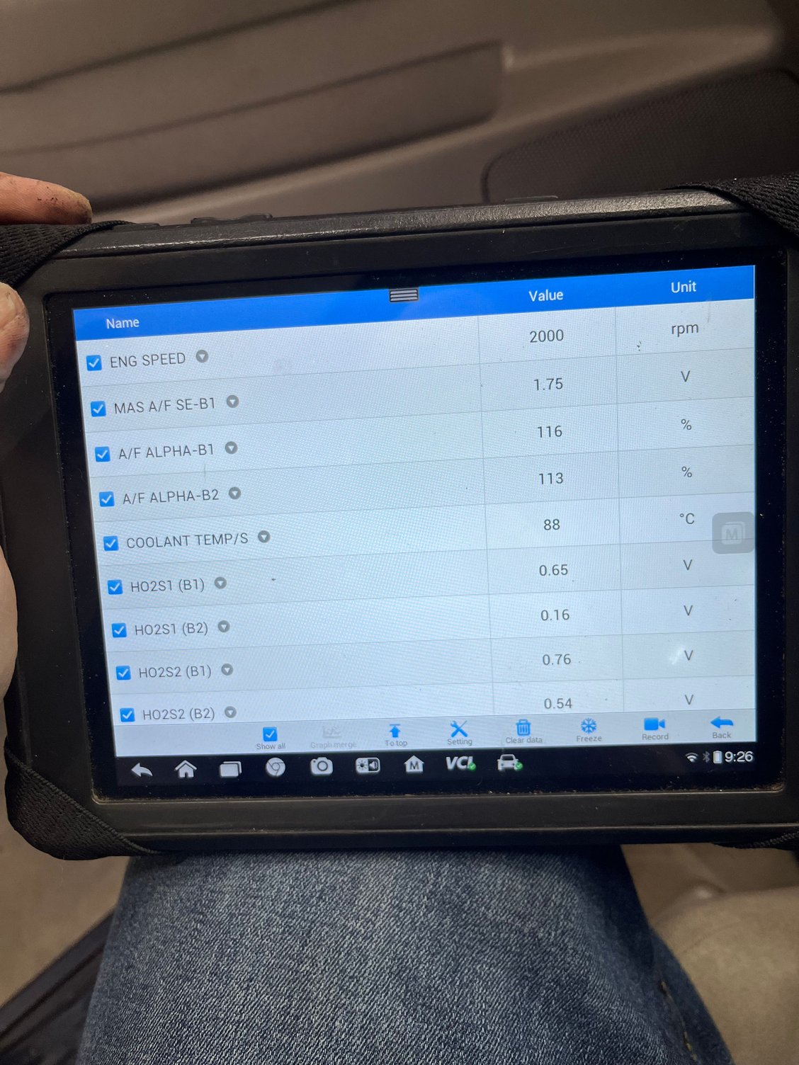

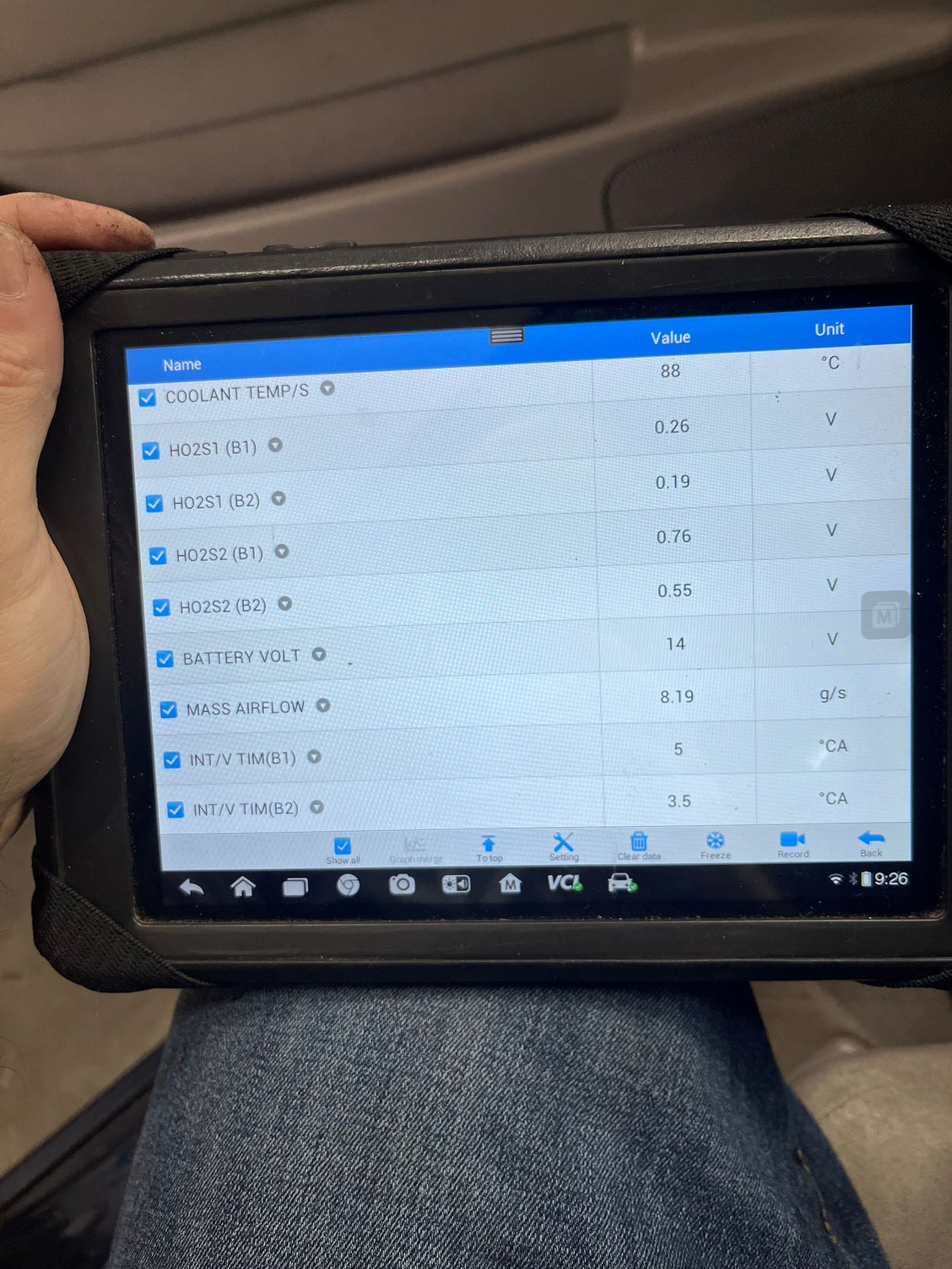

Ok so I now have replaced all coils with oem spec hitachi. Oem plugs gapped at .044. Replaced all intake manifold gaskets along with replacing fuel injector orings. Replaced pcv. Still same issue. I am going to attach pictures of live data at idle and holding at 2k rpm. You can see how much fuel it is adding and o2 sensors reading crazy
