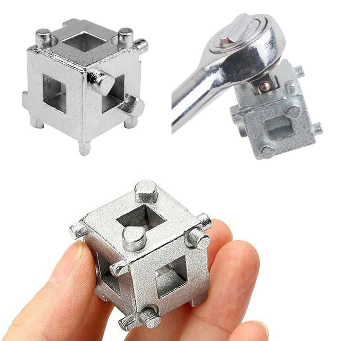

The rear disc brake has a parking brake that uses the main brake pads instead of a inner drum parking brake. How do I loosen the piston in the caliper? Does it turn? With a special tool? I tried to use a needle nose as a spanner but the piston didn't budge.

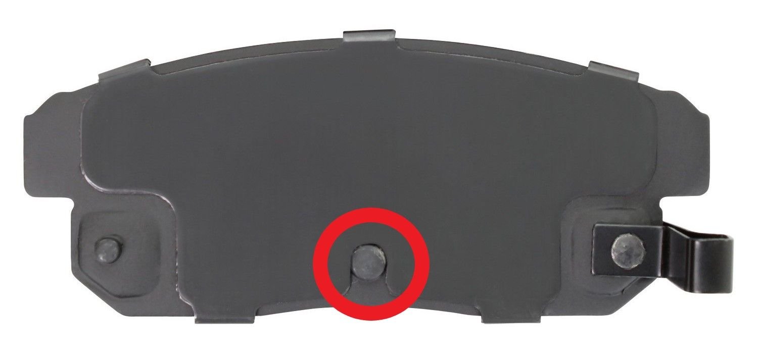

you will need a rear caliper piston tool to twist it. I also grind down the little bump in the middle of the inner brake pad where it contacts the caliper piston..

I did brakes on all 4 corners about 8 years ago, about 8000 miles ago. And I actually have one of those little cubes... somewhere. I remembered it as soon as I saw your picture. Thank you.
I ended up using the $20 kit in a plastic case from Amazon with all the adapter plates. It got the job done. I like the little Borg cube better! The thin metal bar handle on the Amazon kit immediately bent... just like the one in the video I watched.
