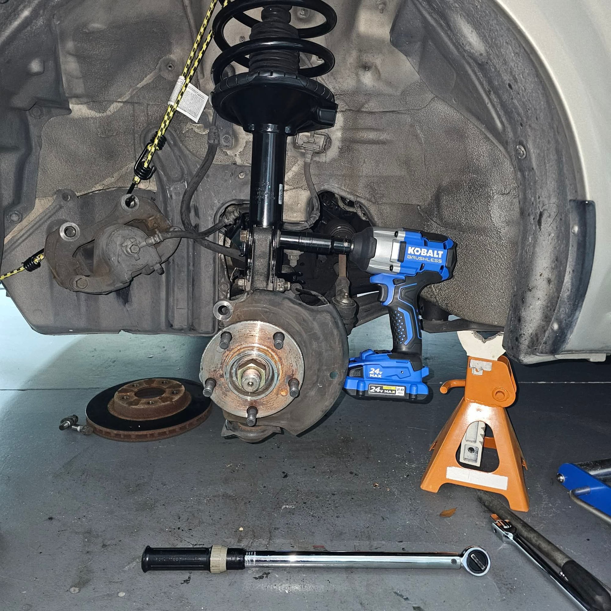

The lower control Arms was a struggle as they lifted the entire hub and had to get a pry bar (heavy duty) to lower the control arm down in order to insert the struts bolts.

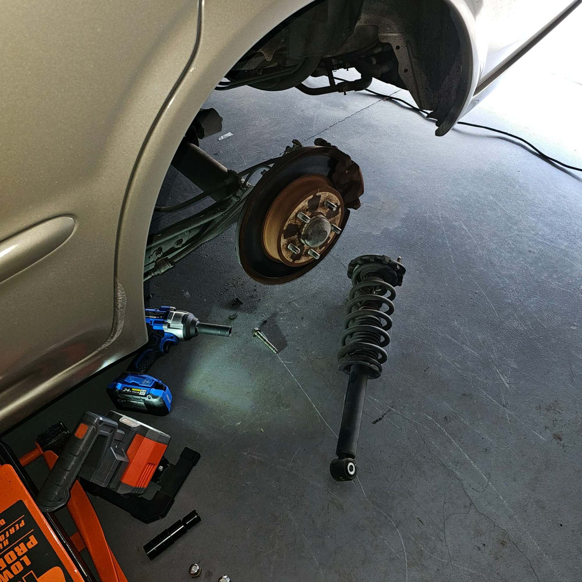

The Rear was a piece of cake, super easy and the old ones been there since the car was built!

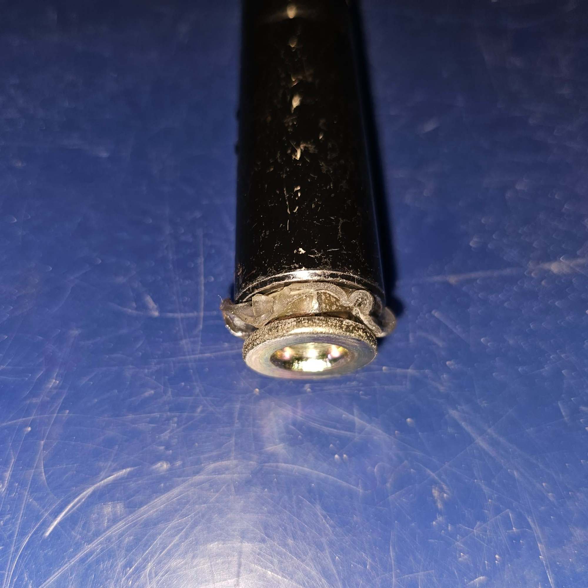

However, the Top securing nuts were placed in a larger socket 15mm (Instead of the 14mm) because I used Gorilla Double sided tape to keep the nut temporarily glued on the larger size socket so, I would not lose it and help volumes to provide a good install in an area (trunk) that is very hostile to work in.

Gorilla double sided tape to keep 14mm nut from falling at the inside of trunk for top mounting of rear struts.

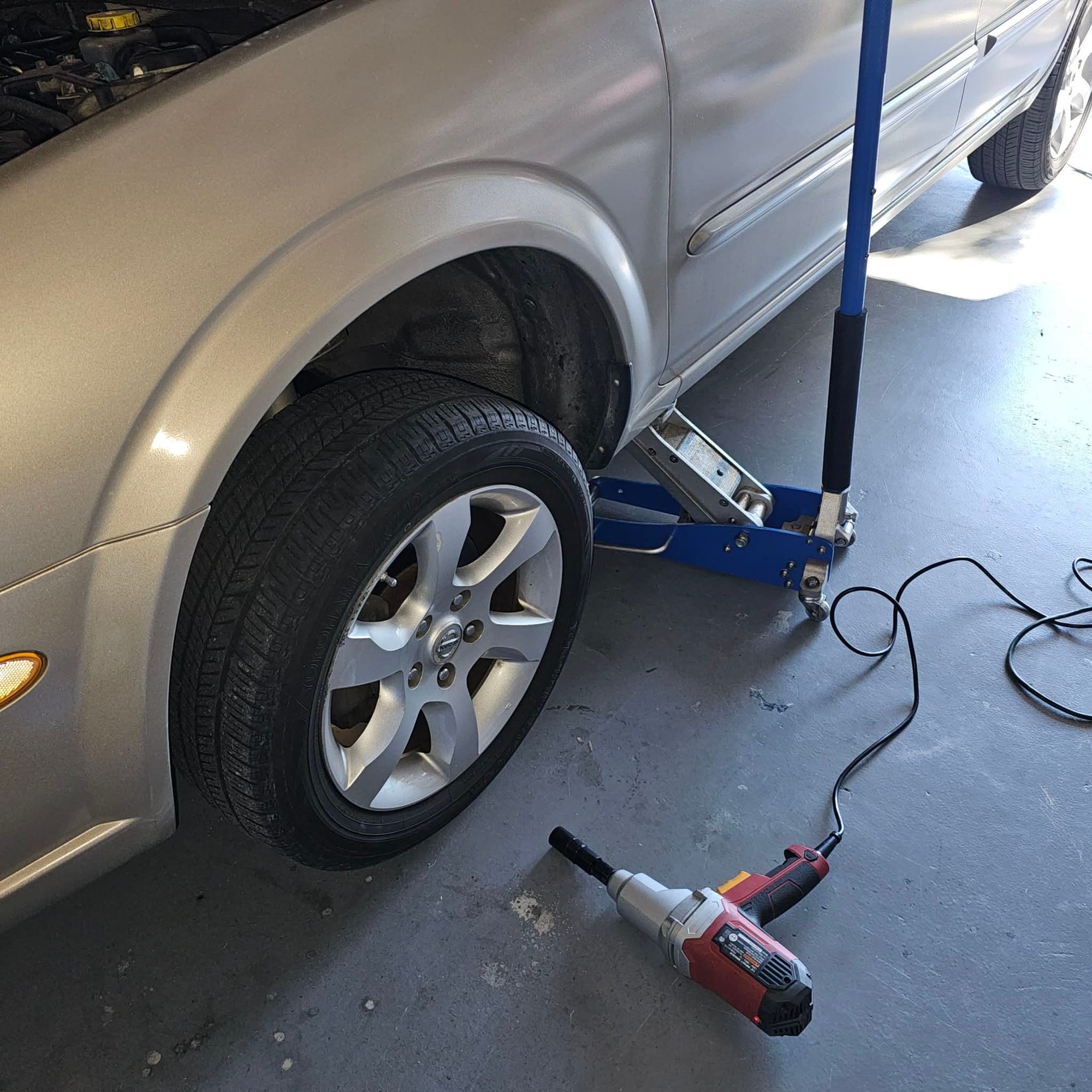

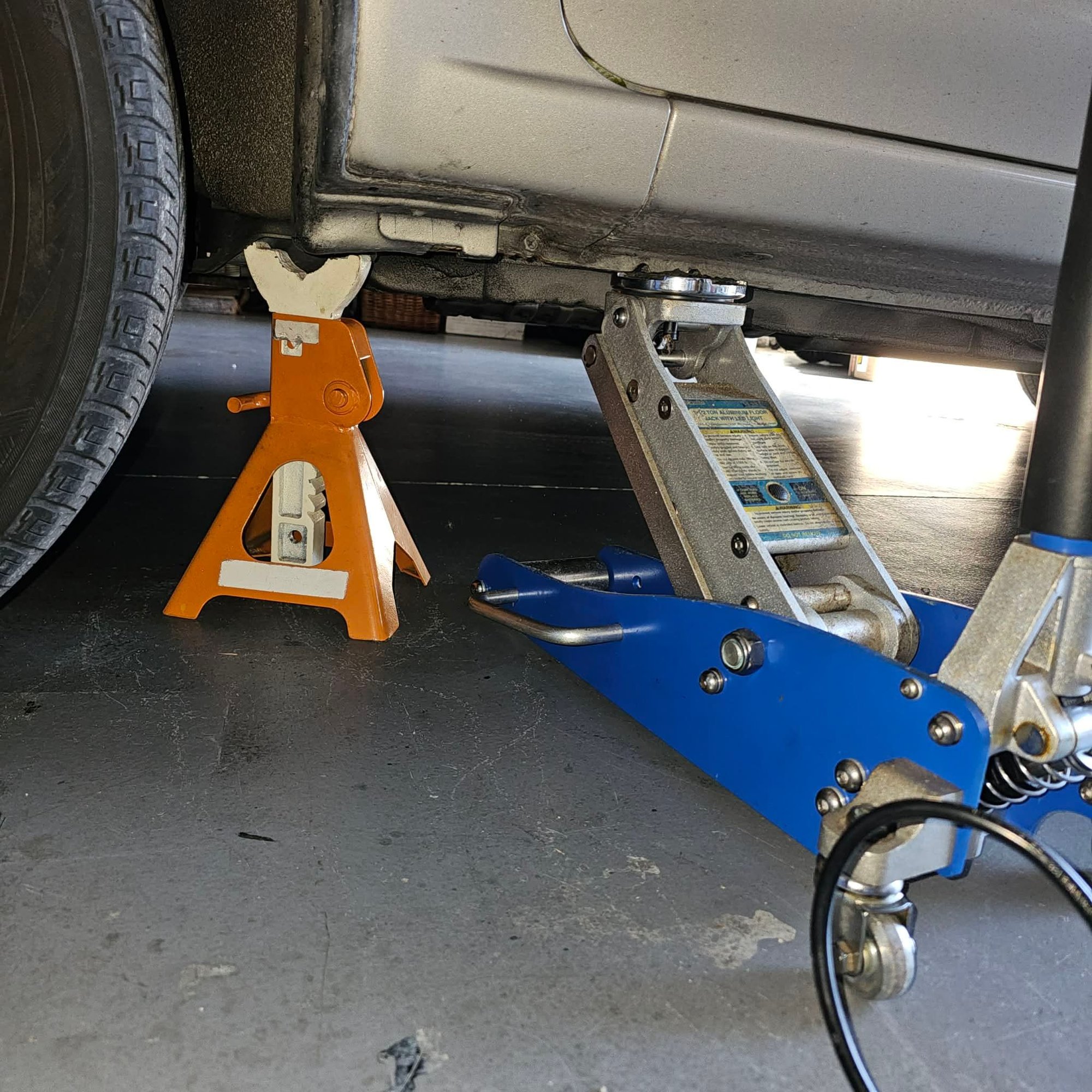

Safety first, used Jack Stands everywhere!
Used both Corded and Cordless impacts for the job.

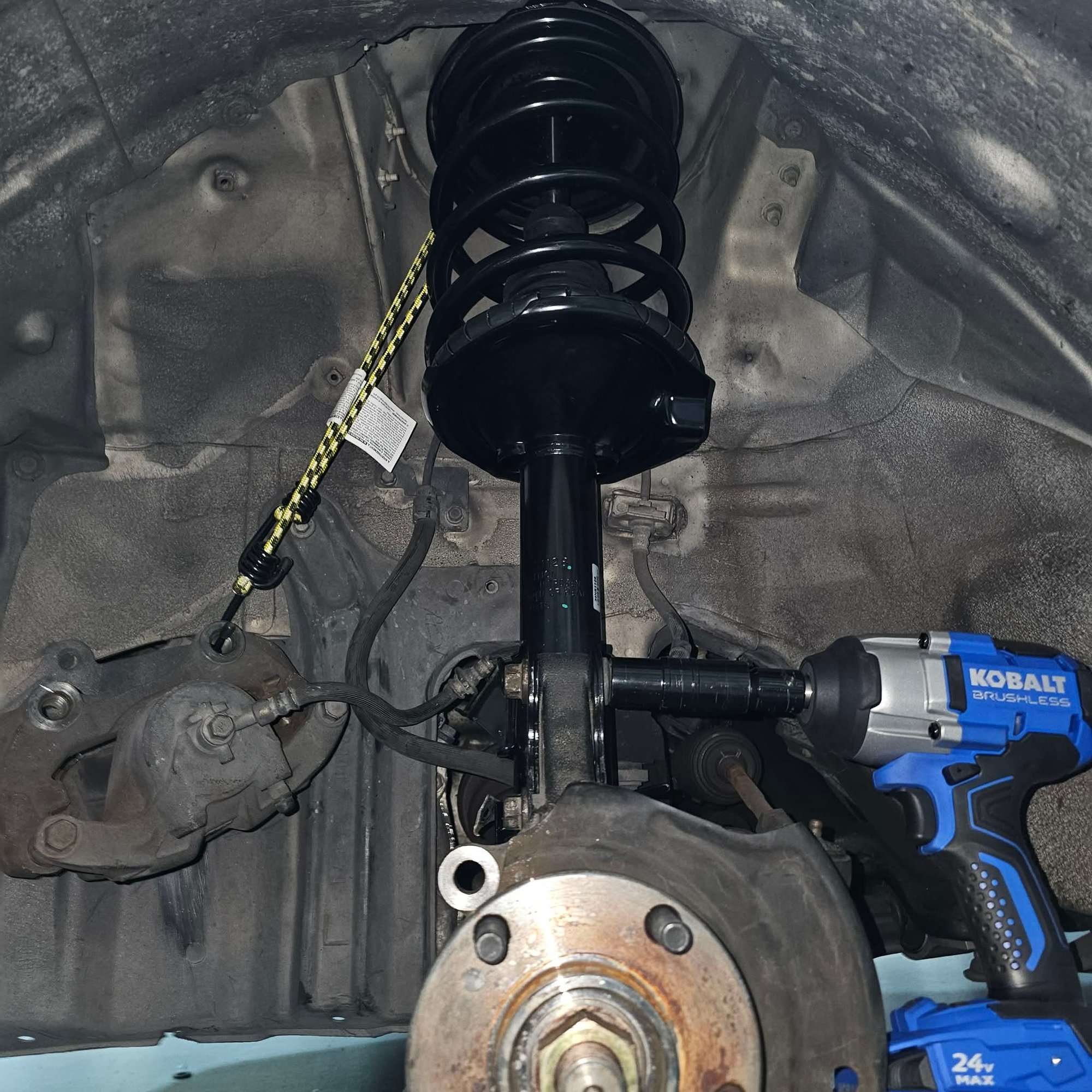

MasterPro quick struts for front.

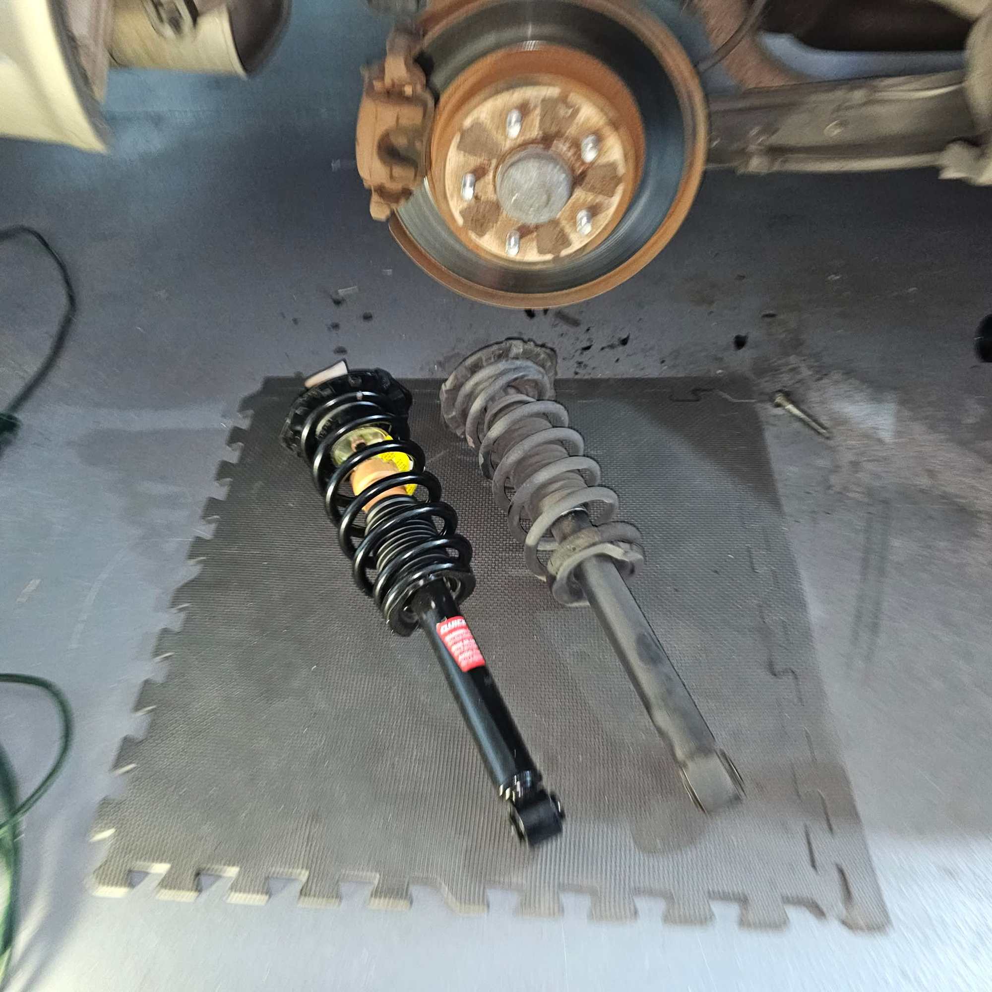

Monroe Quick struts for the rear (Black).
Cordless impact doing the job!
Love this new Cordless impact.

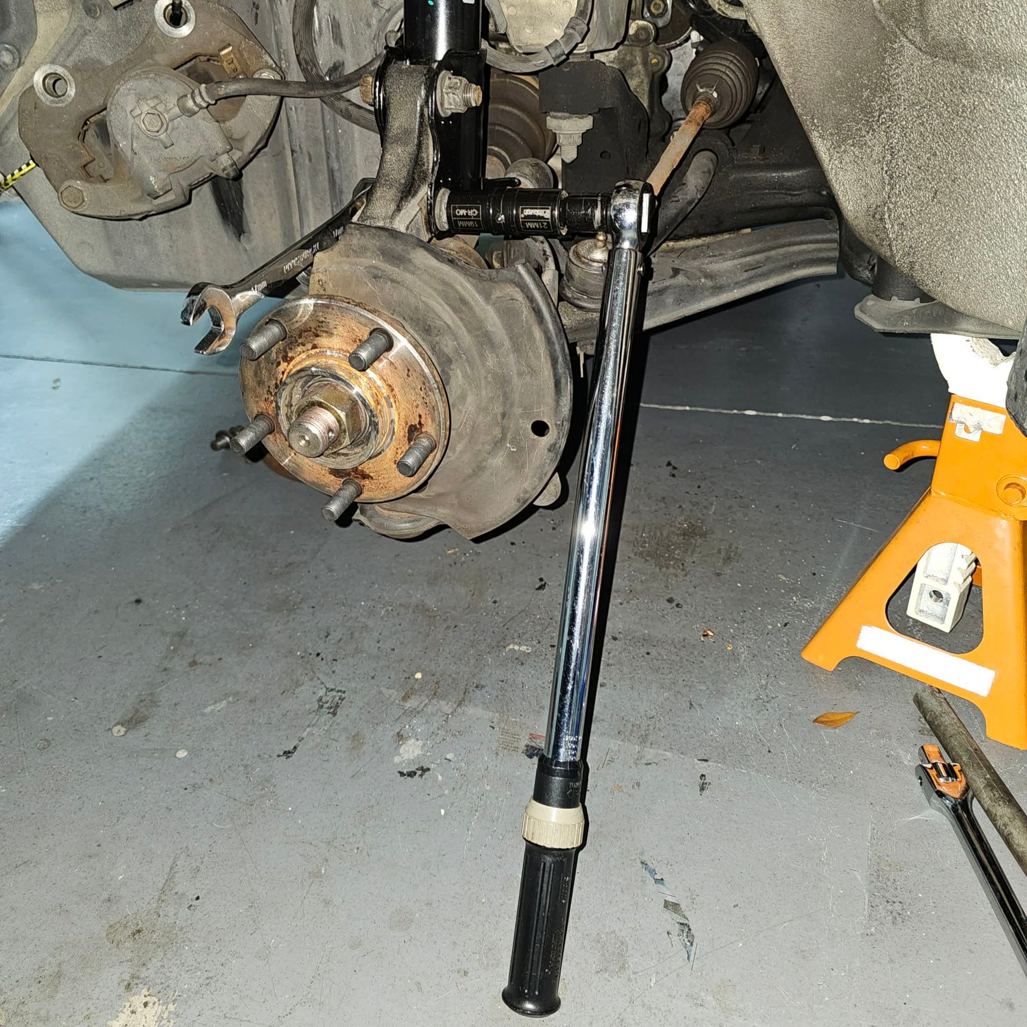

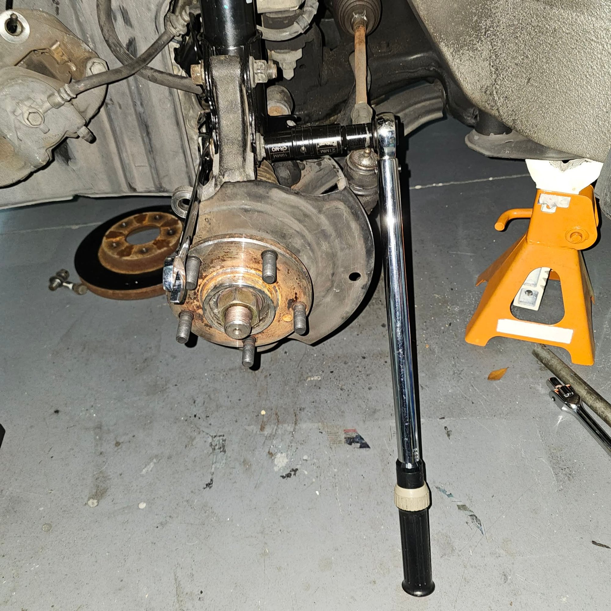

Torque wrench used to secure strut bolts
Easy does it!
Easy does it!

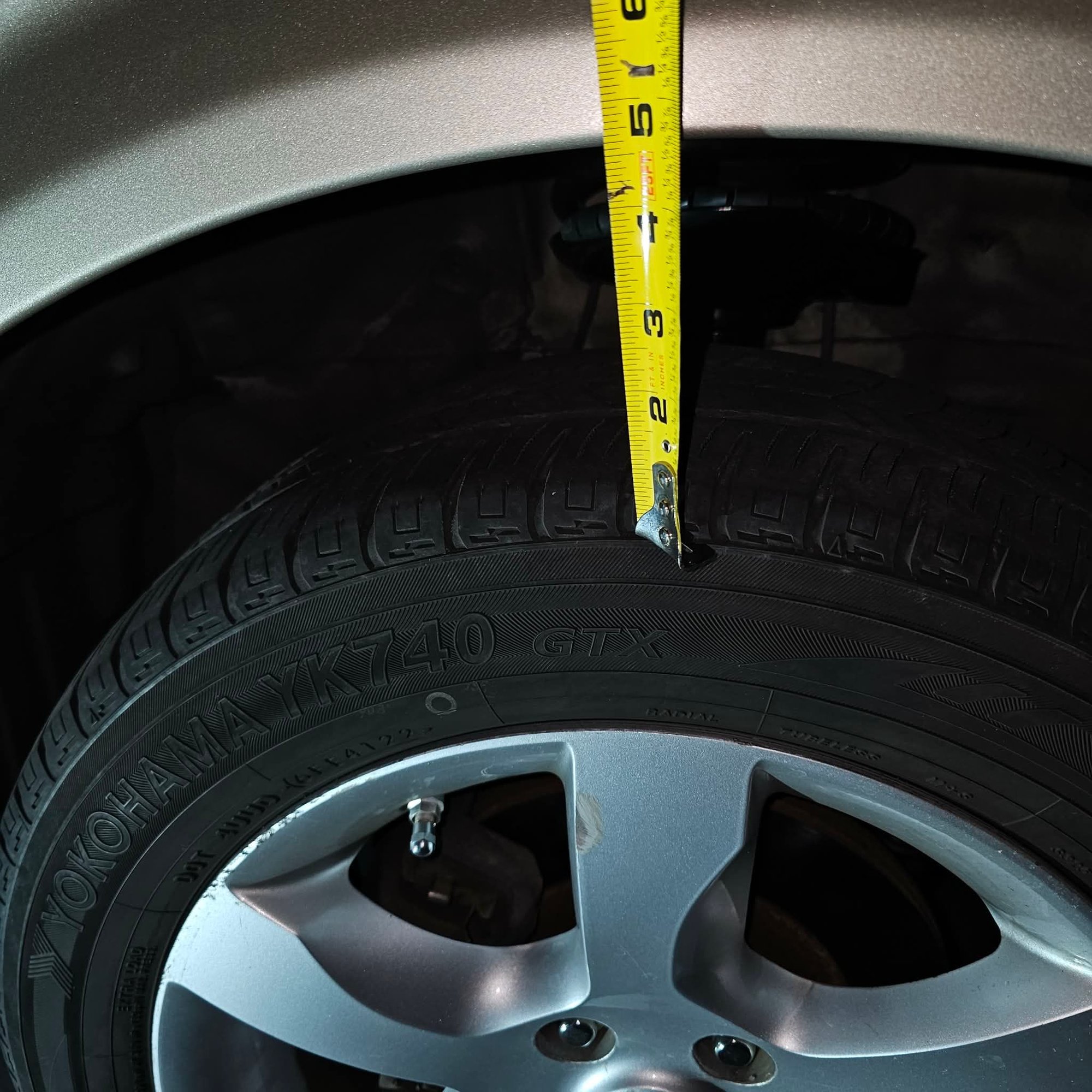

Just great ride height and corners like its on rails.
Just great ride height and corners like it's on rails.
