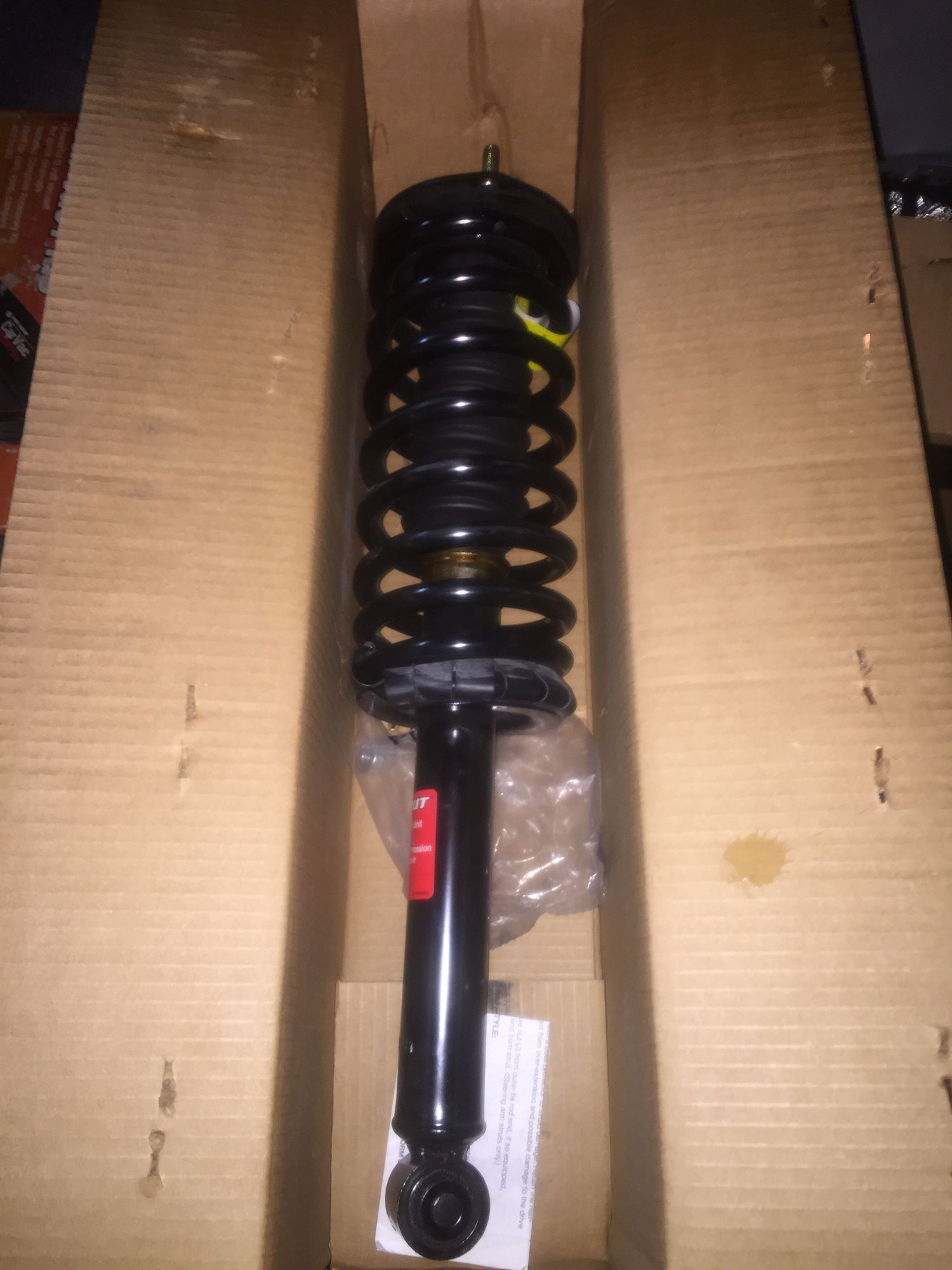

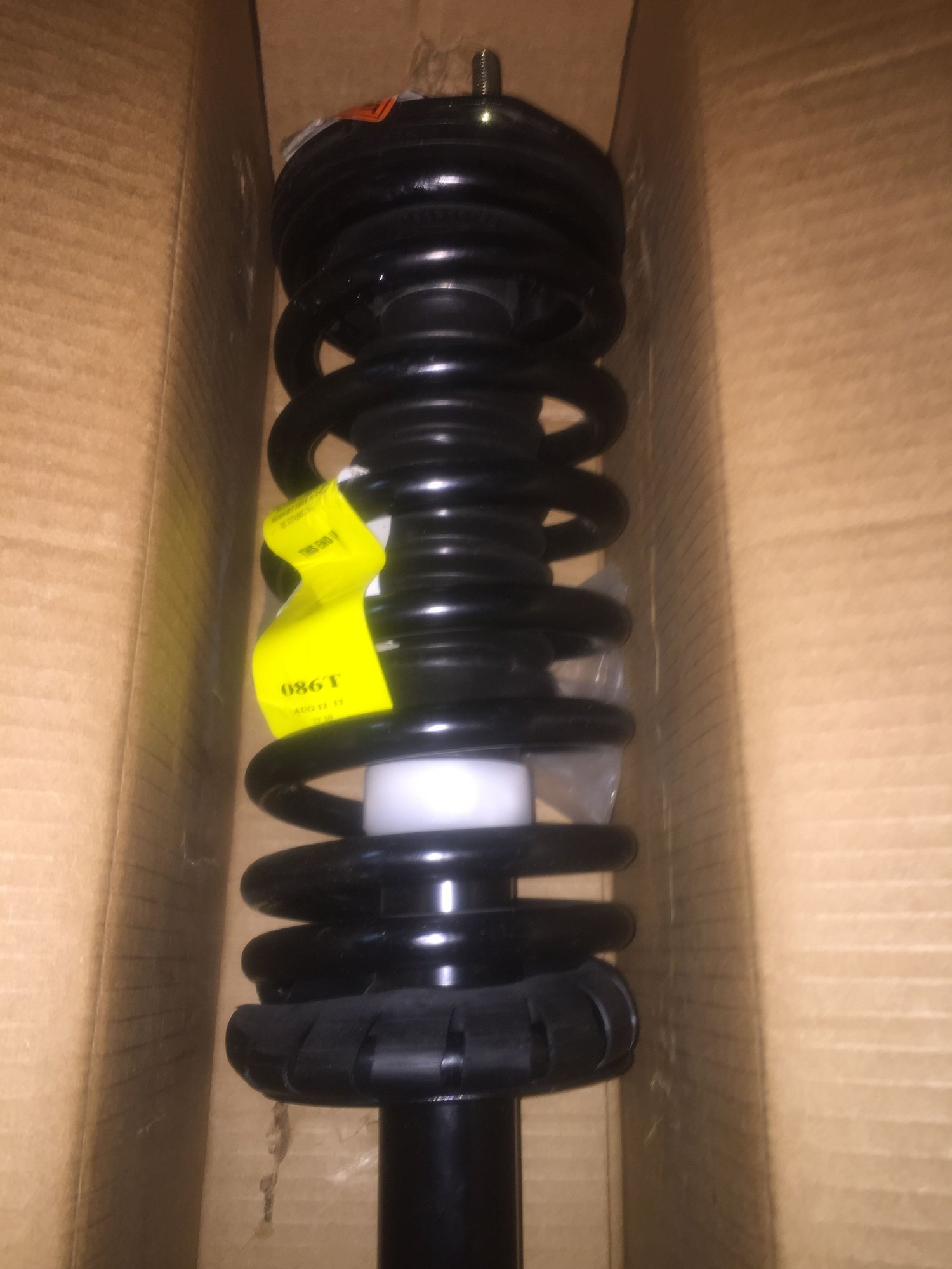

Photos of two more new in box quickstruts. They match each other in that their bumpstops are outside the boots - and that they both have the metal collar, not the white rubber bushing.
I think I need the bumpstop inside the boot, and the metal collar. Kinda hard to believe that Im having to sort thru **** rebuild jobs.
I shall await yet two more examples to arrive at the store and examine those.
This post is making Monroe Quickstruts look bad. Also - those OEM springs in the pic w the Konis dont look anything like any of these springs

There is nothing wrong with the new struts you just posted
The Koni pic that KP posted is of the front struts, not the rear you bought, which is why the difference.

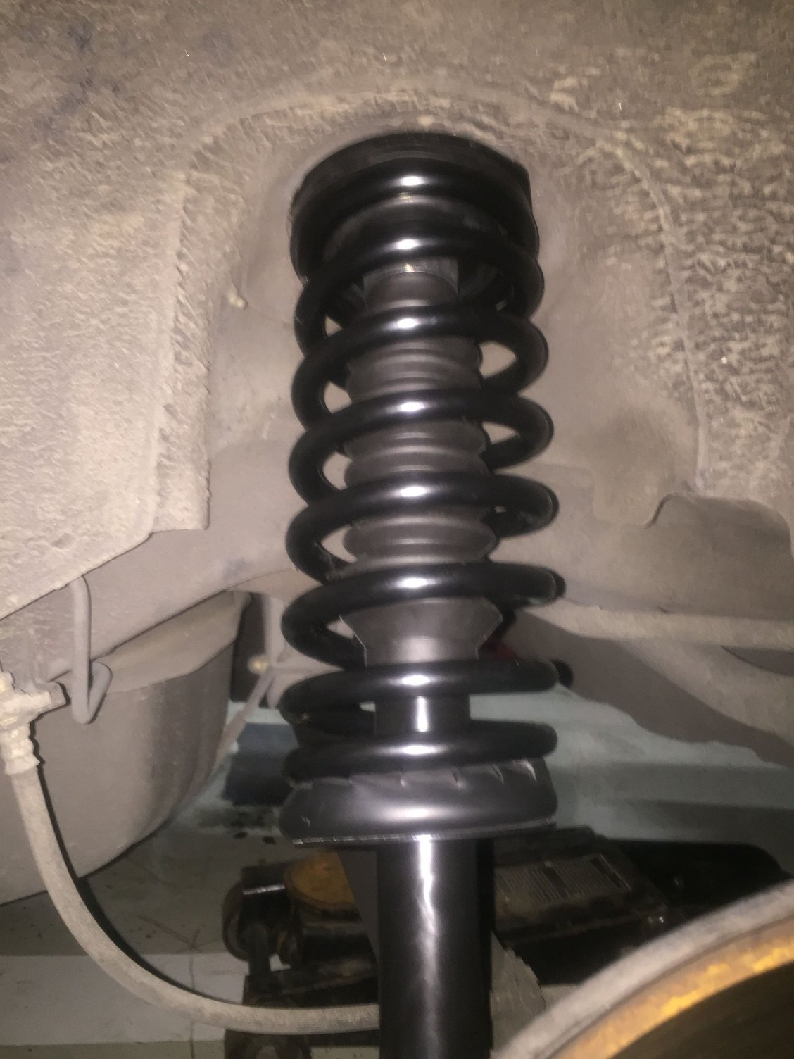

I got this done, Thank You. This is probably the second pair of rear quickstruts on this 120k mile car. The passenger side was leaking badly...
