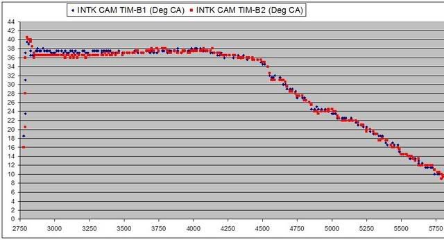

As for the TS flash, it does some nice massaging to our CVTC curves. They are modeled after the Z33 curves, and this is a benefit to us.
Stock FWD VQ35 curve (never been confirmed on the A34)
http://forums.maxima.org/showpost.ph...1&postcount=50
vs stock Z33
http://img.photobucket.com/albums/v2..._intakecam.jpg
vs mine (TS f-spec)
http://i4.photobucket.com/albums/y124/nmexmax/VTC1.jpg

NMexMAX,
Very interesting. I've seen some folks using EMU talk about the fact that EMU supports NVCS (Nissan) tuning. NVCS for anyone who doesn't know stands for Nissan Valve-Timing Control System. Is this one and the same in regard to CVTC or are we talking two different animals here? Haven't done the research myself yet on this point, but perhaps you may have already?
