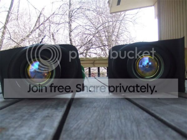

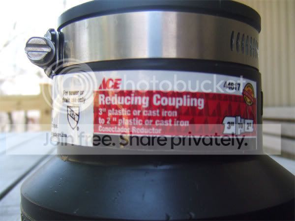

I had been getting some questions about what I had done to my bumper so I thought I would share in the experience.
Here are the supplies I used for the fogs.
1.07-08 Max fog light covers. $8 each
2. 3" to 2" rubber coupler from plumbing section $7 each
3. Auto door trim molding. $3 (not pictured yet)
4. Pair of Fogs from Checkers auto $32.
5. Demel (already purchased)
6. Mesh (left over from Grill mod)(not pictured yet)

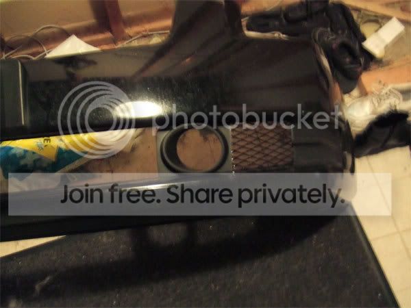

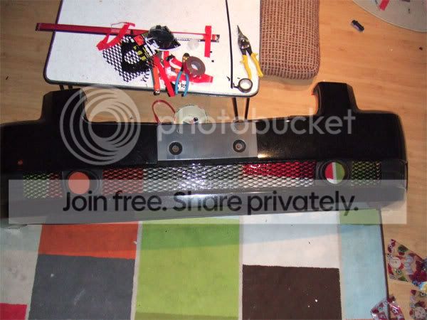

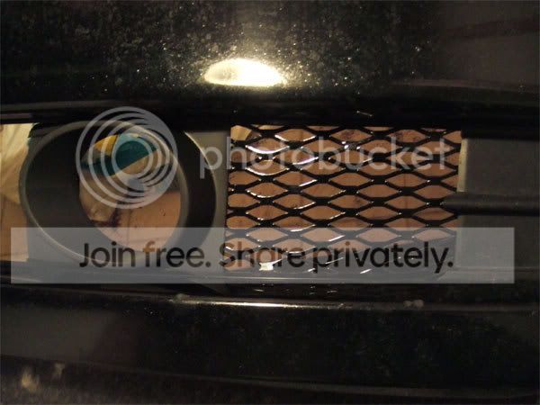

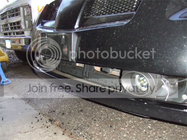

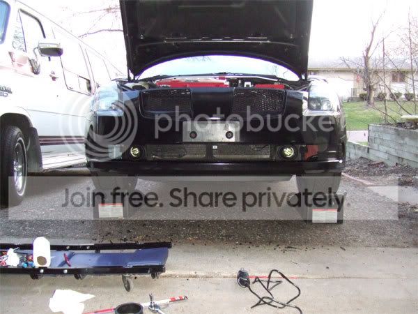

Here's some progress pics.
Show's more detail of the trim pieces I used to hide the cuts from the dremel.

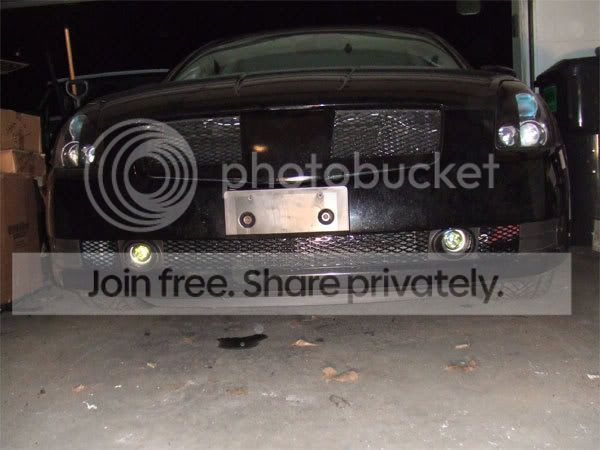

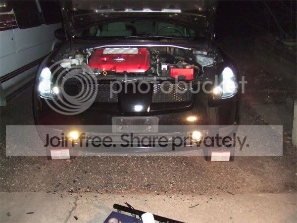

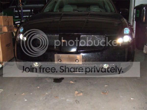

BEAUTIFUL!!! Its basically what I want to do to the rear (mesh opening) except I have to make the cut out by hand. Ill check out Autozone for the door edge guard material to cover the edge after I make the cut out. In my online research I found someone else had done this too. Can you get some day time pics with the sun shining on the grill so its more visible. How much did the project cost?

I had spare mesh from doing my grill, an 18x42" powder coated gloss black piece cost about $70. The other items for the bumper was just over $60.
