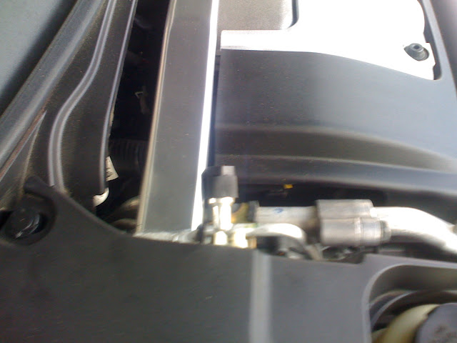

A/C line unclipped and moved forward.....oooooh sooo close
Weapon of choice
Oh yeah, since the A/C line is so close to the bar, I put a circular padding, the kind you put under a lamp or speaker to keep it from scratching the furniture.

Trim looks neat, good job. I would like to see you have a little more clearance at the AC line

You and I both. This tight fitting is unavoidable with the RacingLine and Stillen FSB.

This AC line will bend easily, apply pressure and bend to the front of the engine bay & down toward the engine just a little to get about 1/8" to 3/16" clearance

You can also bend the yellow piece of metal which the AC line sit on and add that little extra clearance. That's what I did and it works well. On the front strut tower bar, do you have a rubbing/grinding issue when you place you car in reverse and reve the engine? That happens with my stillen one.
