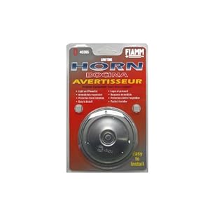

Also, I'm looking at replacing them with either of these model, which both appear to be direct replacement. I know I need both high and low, I'm just showing the low tone horn below. Which is better, can anyone tell? FIAMM's homepage didn't go into detail what was different about these two types. Amazon lists them both at 130dB; Thanks for any insight!:
FIAMM 40365 12 V Low Note One & Two Term W/ Universal Bracket
http://www.amazon.com/FIAMM-40365-No...2007&carId=002
And this one:
FIAMM 72112 Freeway Blaster Horn
http://www.amazon.com/FIAMM-72112-Fr...2007&carId=002

I went ahead and purchased the disk type horns, so really all I'm looking for is insight on the horn access. I vaguely recall they were under the batter tray, but when I was last in there I never actually looked to see if I could easily access them from there...

Turns out it was only one, a trumpet horn, not a disk. The disks sounded nothing like the original sound, very rice, so I'm sending them back.
