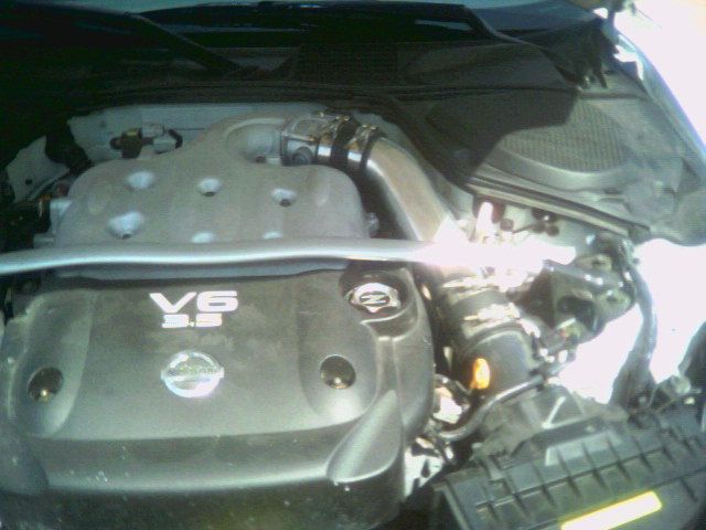

Here, ill take a picture of mine. This cost 60 bucks, filter and all.
i talked to a few performance shops and as to the placement of the maf, 6" after the filter is what everyone said is a rule of thumb for all cars.
all i used was a huge spectre filter, (good enough for large V8's) an elbow, and high quality stainless steel. I could buff it to a mirror finish, (shinnier than that elbow) but wasn't all that interested in it.
30 for the filter and 30 for the piping, hose clamps, grommet, longer vacuum hose and couplings.
