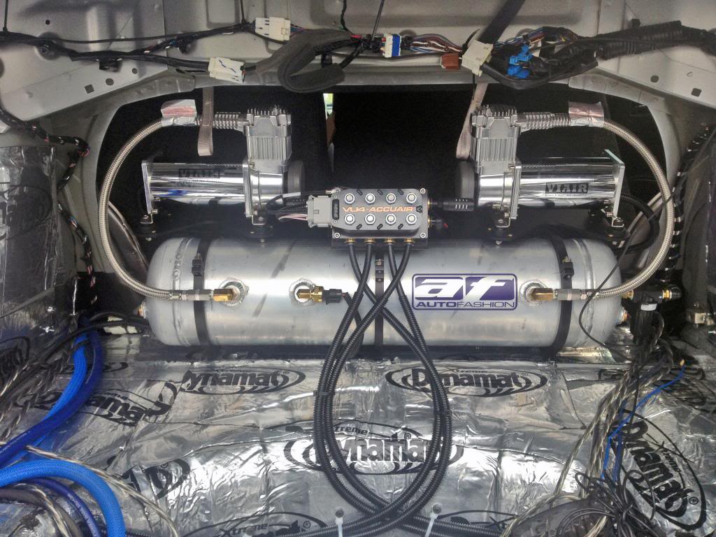

Just wanted to share a couple pics of my Accuair E-level on BC coils/UAS bags setup. I already posted this on the FB group and other 6thgen forum, but wanted to share this to other Maxima enthusiast and 6thgen newbs.
The trunk set-up

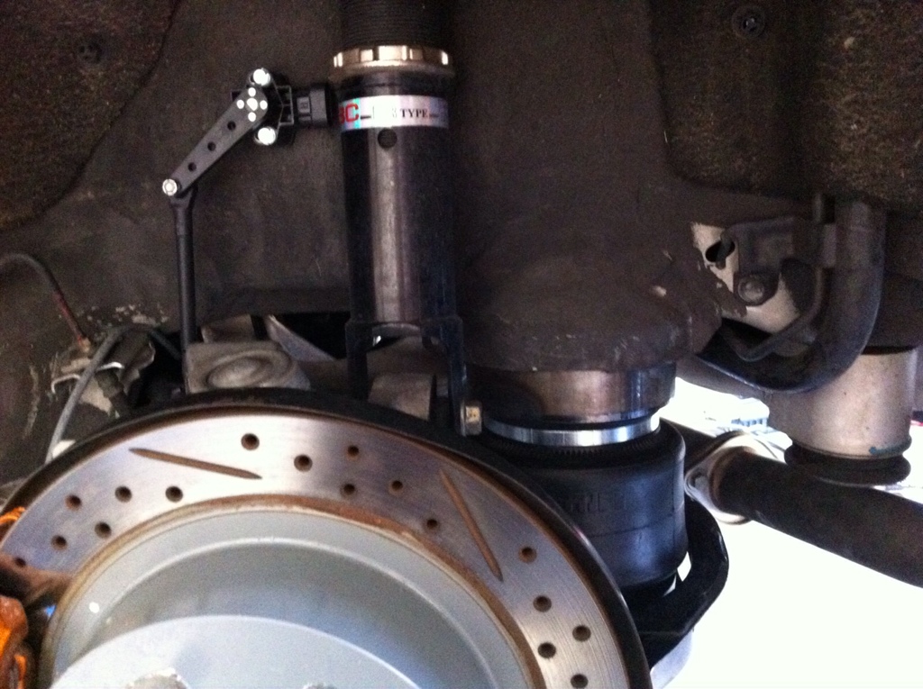

Bags

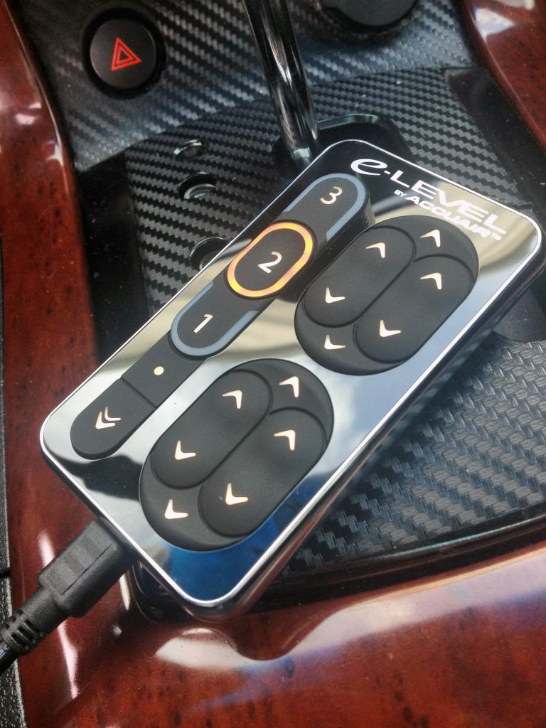

E-level controller, also have the new i-Level installed

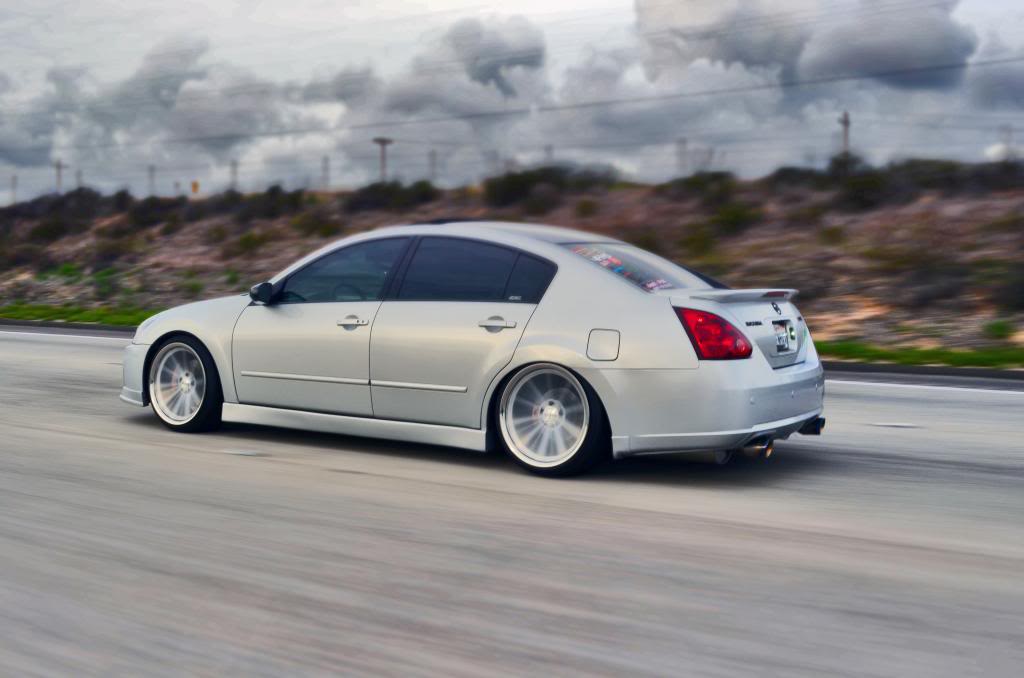

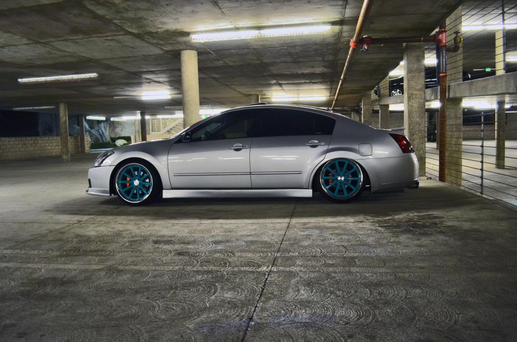

How it sits (would of wanted the front tuckin a little more thou :-/)

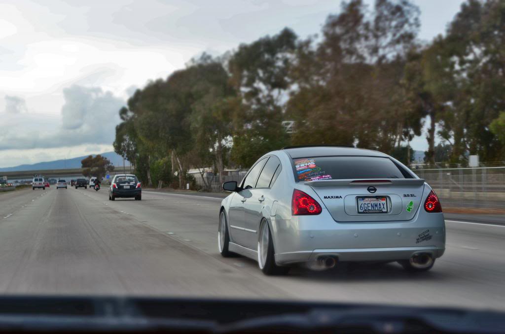

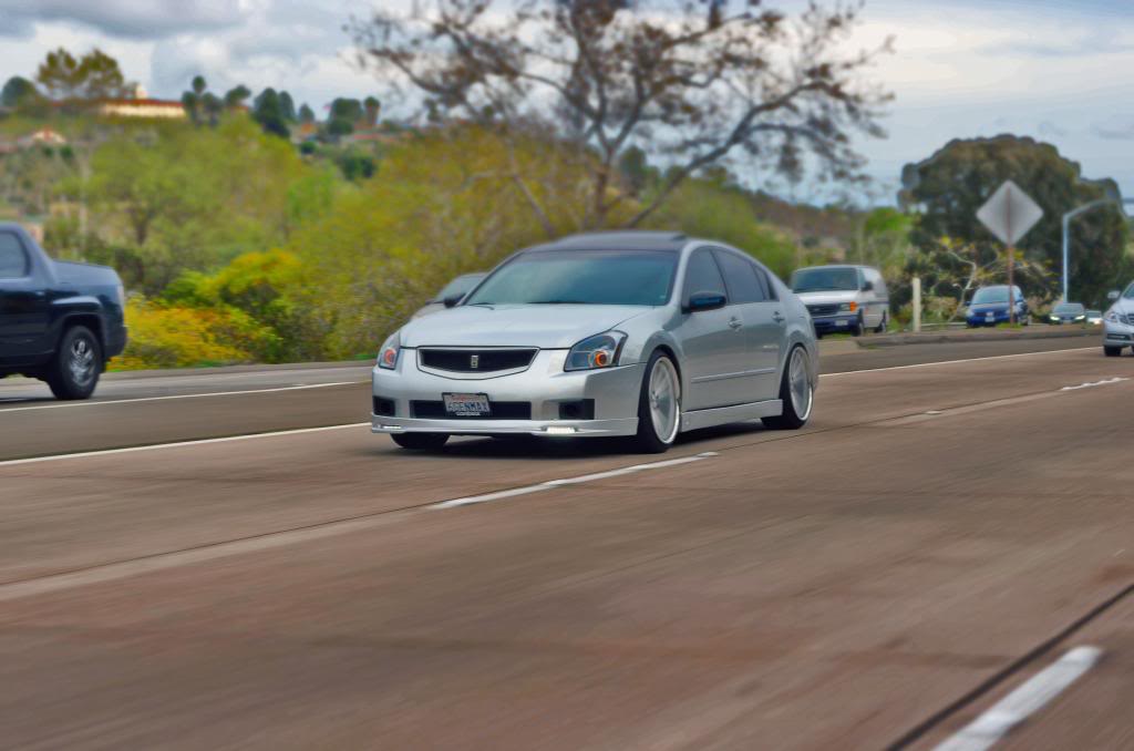

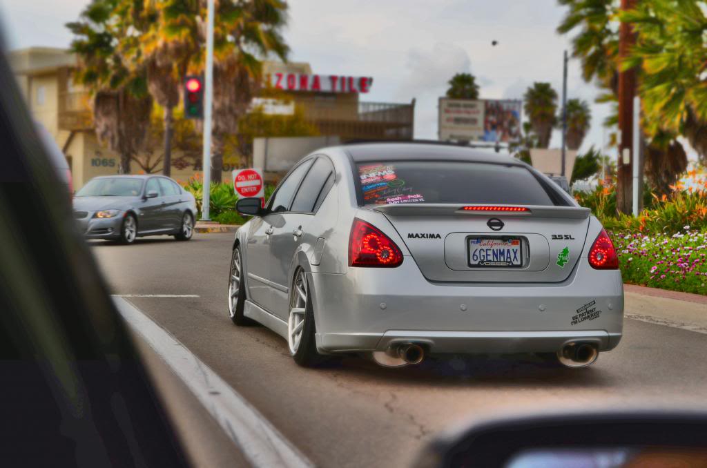

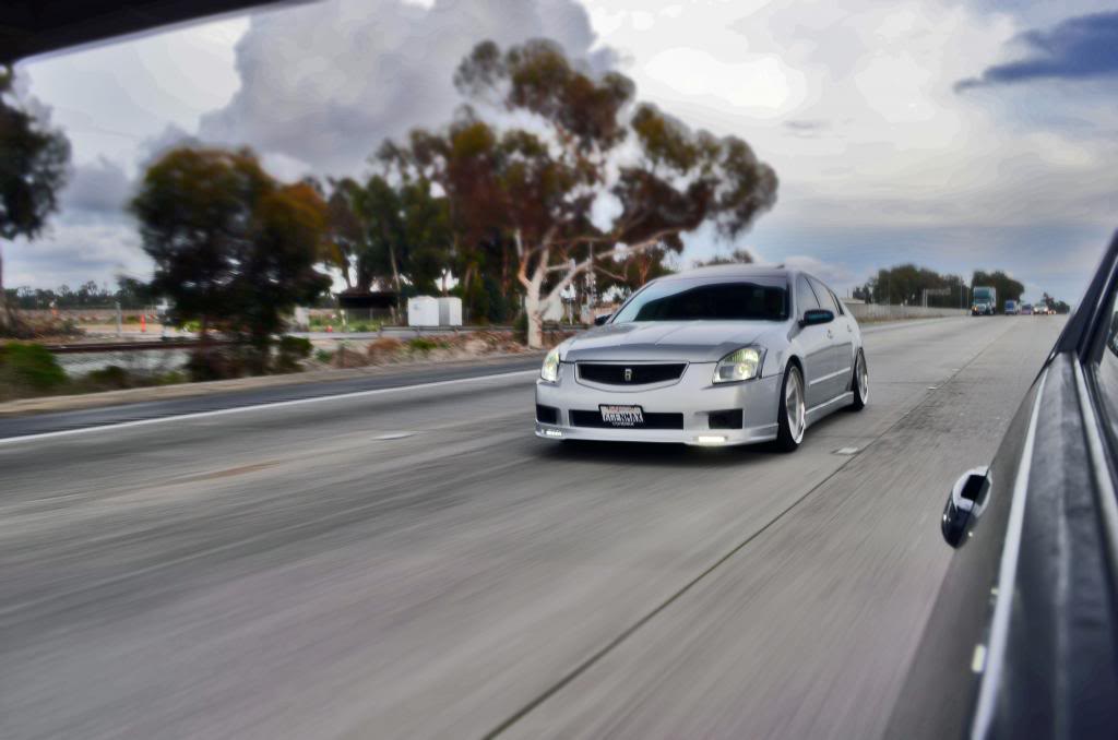

Rolling shots

Cant get that front down a little? It seems like even on your coils you're lower up front. Why would it have to be higher? Rear looks/tucks real nice!

Thanks guys!!
Sadly no, the UAS bags and brackets do not let it go lower. Combine bags and brackets are 5 inches taller and my coil springs. Working on getting a set of air struts later on.

The bags and brackets where $700, I got a promotional deal on the Accuair E-level with touchpad, i-Level, dual compressors, EXO mounts, mufflers and power supply for roughly $2700. I purchased everything from authorize dealer. If you do air skip the UAS bags and go with air struts.

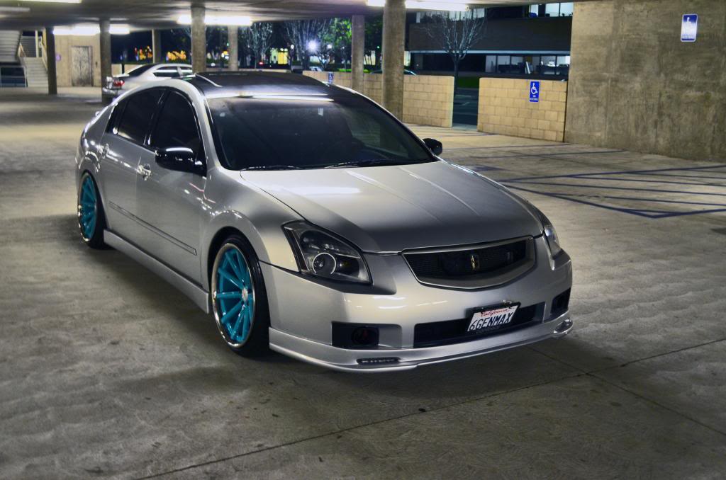

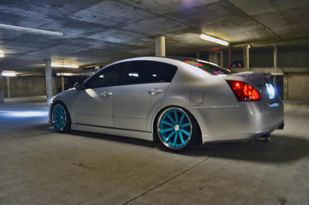

Decided to get my wheels painted this here's the outcome

Hero are your running spacers to get the wheel back out that close to the fender? I have 20x10 with a +40mm and they sit right about where your's sit. I'm looking at swapping wheels and going to some coilovers so just doing a little research, sorry to get off your subject. Your car is what I want mine to look like eventually, my Teins didnt get me that low.

20x10.5+25 is almost an inch further out than a 20x10+40, so I'm sure yours doesn't sit like ours. With these specs you have to run negative camber. You probably think it looks similar because you're looking at the top of the wheel and fender, but if you look at the bottom of the wheel you'll see that ours stick out more.

No spacers, and at -4 degrees camber

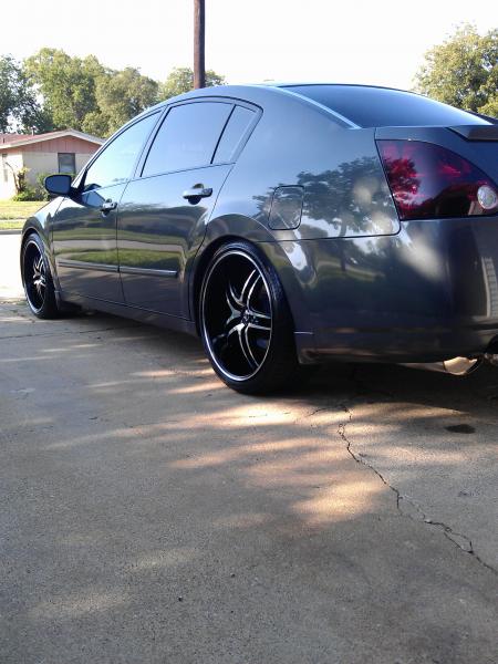

The new bag setup you got is nice. Stance looks good. Like some of the new changes to you made, grille flows a bit better with your theme than the old one.
Not too sure how I feel about the rims though. IMO it would've looked better if it were color matched.
