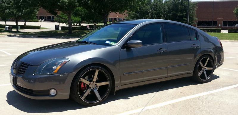

Hello everyone just needed some advice from everyone that's lowered. Currently I'm on Teins and want to go with some coilovers very soon. My question is what are you guys doing about the rubbing on the rear for the bumper support? Right now with my setup I get a slight rub on the tire with no damage to tires or wheels. I have rolled the fenders somewhat and don't see any interference there just on the bolt that sticks out towards the rear of the fender well that most of you have run into I'm sure. The pics show how low I am, I know it sags a small amount in the rear with a full tank of gas and the 12's in the trunk but I don't want to go lower till I know what I need to do with this bolt.

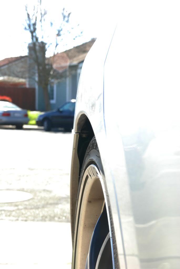

Yes, you'll have to drill a new hole an inch or two away and use a nut and bolt to hold the bumper to the fender. You'll also have to cut some of your fender liner off, especially the part that covers the original location of the screw because it sticks out so much into the wheel well. Here I cut off that portion of the fender liner and you can see how the screw and bracket protrude into the well.
