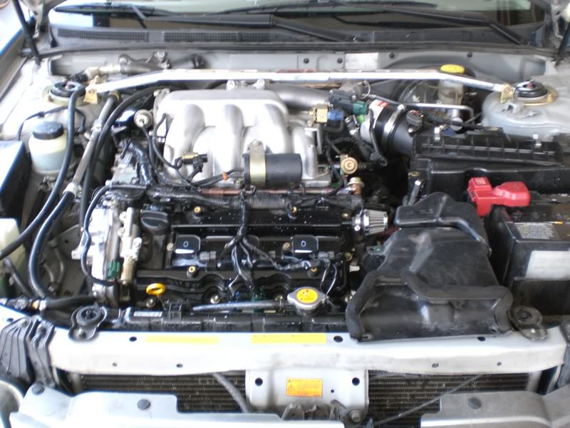

This is a stock photo I found online. The cap I'm referring to is above and to the right of the harness connection, on the opposite side from where the two vacuum lines attach.

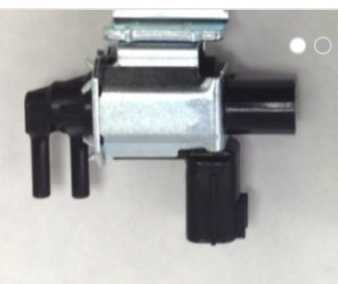

Here is another pic I found of a Vias with the removal of the plastic cap I was referring to, exposing the vacuum port. Any help would be greatly appreciated.

I appreciate you taking the time to post those pics, but my problem isn't locating it. My problem is the hissing (leaking?) coming from the vacuum port on the right side that is capped off from the factory. My concern is whether or not it's normal for it to do that. Secondary question is what purpose that capped end serves.
