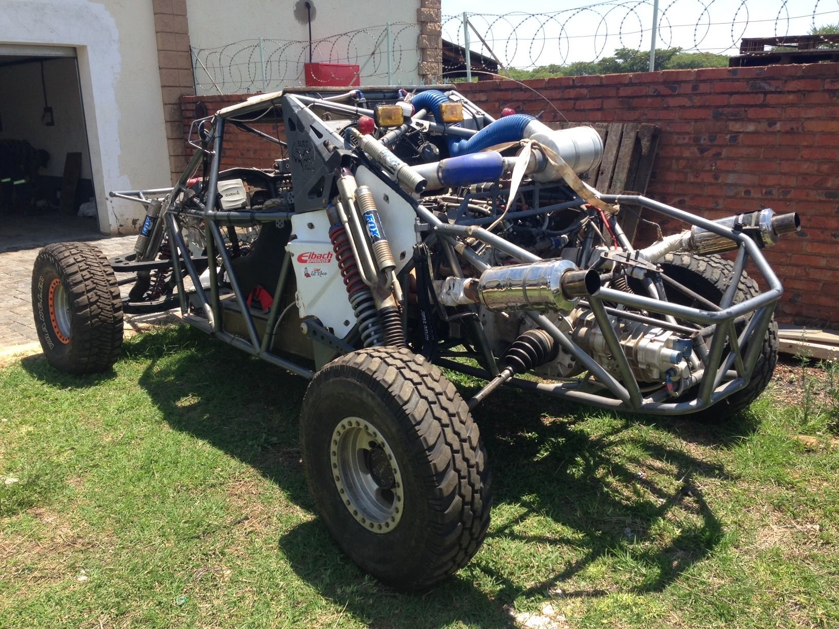

WA Sharky's Avatar
Joined: Jun 2015
Spec 1 Bat
This is without her covers. VQ40DE at the moment
Hopefully these work for you
Old Jun 16, 2015 | 06:14 AM
Brudface's Avatar
Posts: 361
From: Ottawa, ON
That is absolutely bad a$$ man. To answer your question as best as I can I am pretty sure the ONLY difference between the VQ35DE and 40DE is the stroke of the piston. Which I can't even remember if its the crank or if it's the connecting rods that increase the stroke. Pretty sure its the crankshaft. The HR heads are different than the DE heads.
Your buggy Needs torque correct? And if I am then your best bet would be to stick with the VQ40, find a way to see IF it's possible to use 35HR cams and OR give Brian Cower a call and get some of Stage 2 cams. This might sound silly but using a maxima Plenum that has been totally bored out with those cams would see a nice bump in torque down low, ESPECIALLY from the VQ40.
