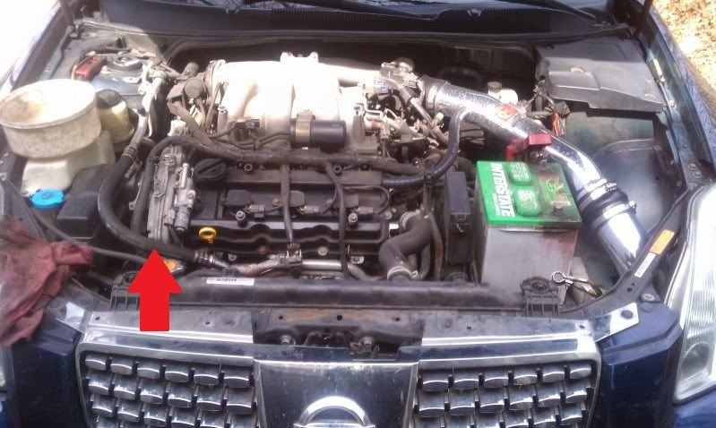

What hose/part is this?
This hose has a pin hole leak and I need to replace it but I have no clue what part this actually is. Can someone tell me what this belongs to or what the OEM part number is? Thanks.

That's the A/C suction hose. Is your A/C cooling? Part# is 92480-ZK30A.
Thanks. Its not amazing... I was thinking something was off with that.
