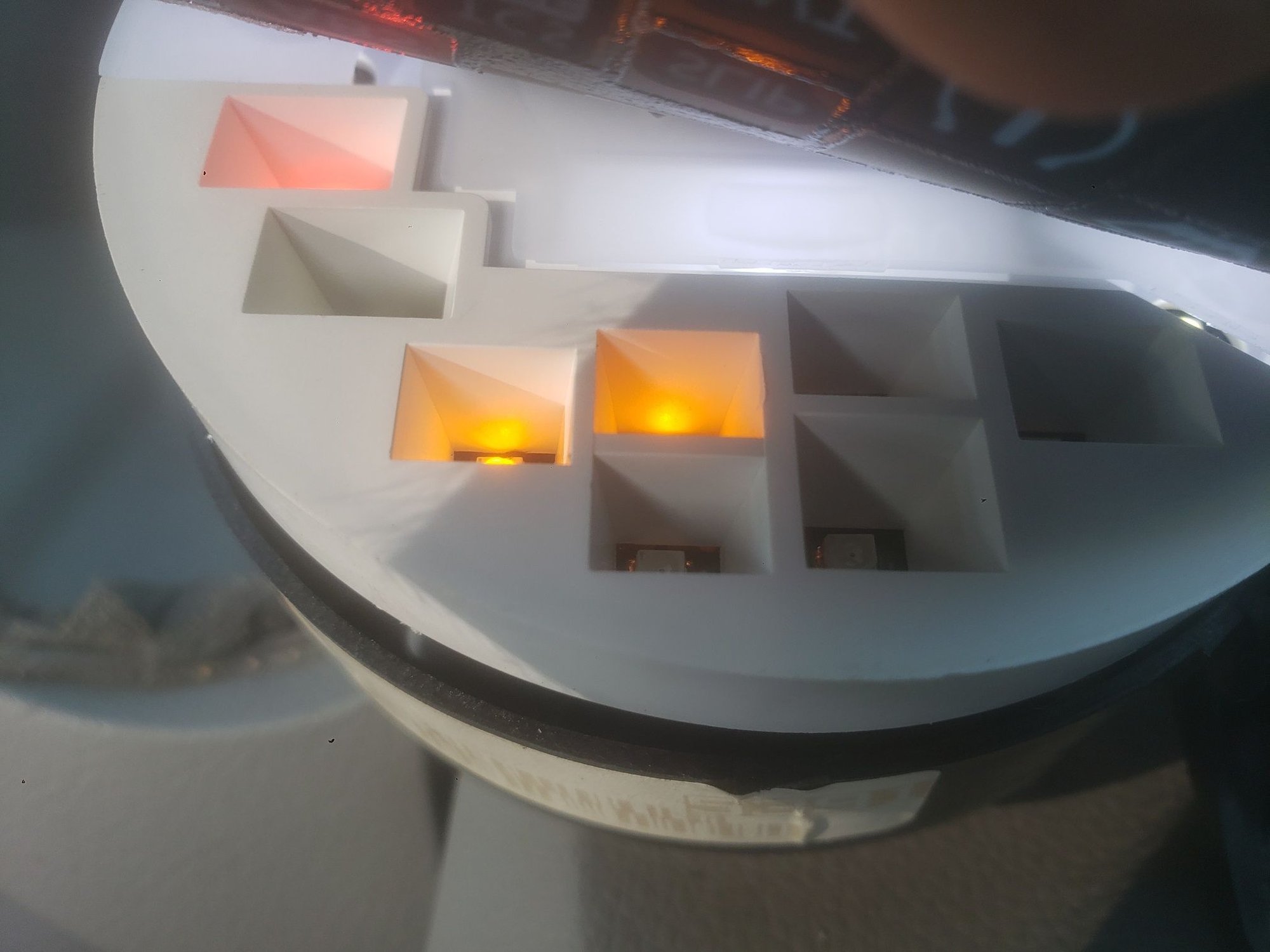

So I swapped the gauge cluster on my 2004 Maxima to this 07-08 cluster. My 04 does not have traction control, so is there a simple way to eliminate these LED's?

Since no one seems to have encountered this before, let me add another note to this thread. I would even be willing to simply damage the LED so that they no longer light if someone can help me identify which is which. Does anyone have any reference pics or documents that identify which LED's specifically are for "TCS OFF" and "SLIP"?

Since there have been 538 replies, but no responses, I will close the loop on this with the way that I solved this problem. I lifted the gauge face up enough to identify the LED's, then used a small drill bit to damage the (2) LED's that I did not want to light. This may be crude, but it worked. Hopefully this thread will be beneficial to someone else that is in a similar situation.
