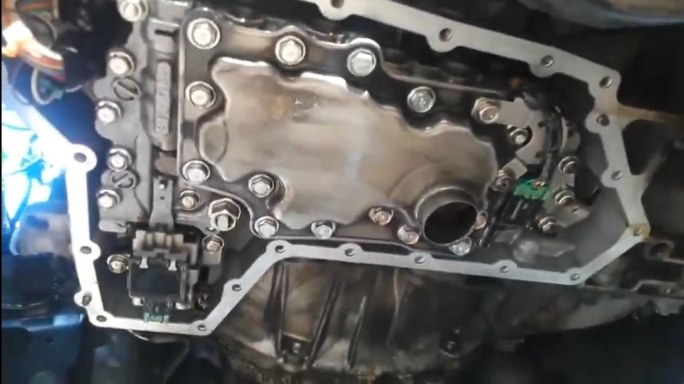

My 07 has 112k miles and I don't believe the fluid has been changed at all since I bought it at 104k miles. I found a radiator leak from the transmission line and I lost about 2 quarts of cvt fluid (fluid was black) not sure how long it was for. Thankfully I have no issues with slippage or rpm jumps but there has been a grinding/vibration when I accelerate at low speeds since I bought the car. I plan on draining the fluid and want to change the filter but I can't find the part for an 07. Every website shows a different shape of the filter than what it's supposed to be. This pic below is what the filter looks like taken from a YouTube video on an 07 but can't find any online.

This is the filter (https://www.courtesyparts.com/oem-pa...Y2LWdhcw%3D%3D)
It is on the exterior of the CVT. What your picture is detailing is the screen for the CVT fluid pickup. I have never changed that. Just get it from the Dealership when you get the 31726-1XE0A.

Thank you so much! So is it worth even taking off that screen and cleaning it with brake cleaner or whatever?

Well, I am of the position to not mess with the internals of it (engine/cvt) unless you have to. There is risk of contamination by taking that stuff off. So, I would just do the drain/refill and and throw the new filter on it. If it comes about that you have to drop the CVT pan, then that is what ya gotta do.
