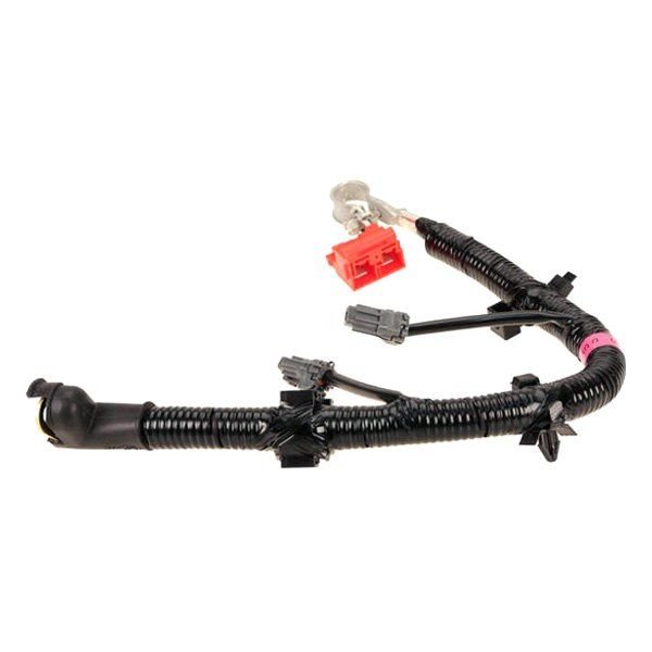

Can you post some pictures so we can see how corroded the connections are?
The OE part is 24110-44U00.

I cleaned them up pretty well so there isn't much visible corrosion now. If I replace that part of the harness, I suspect the trouble will be resolved. Thanks a lot for posting that photo and part number. Where would you order it from, the local Nissan dealer?
