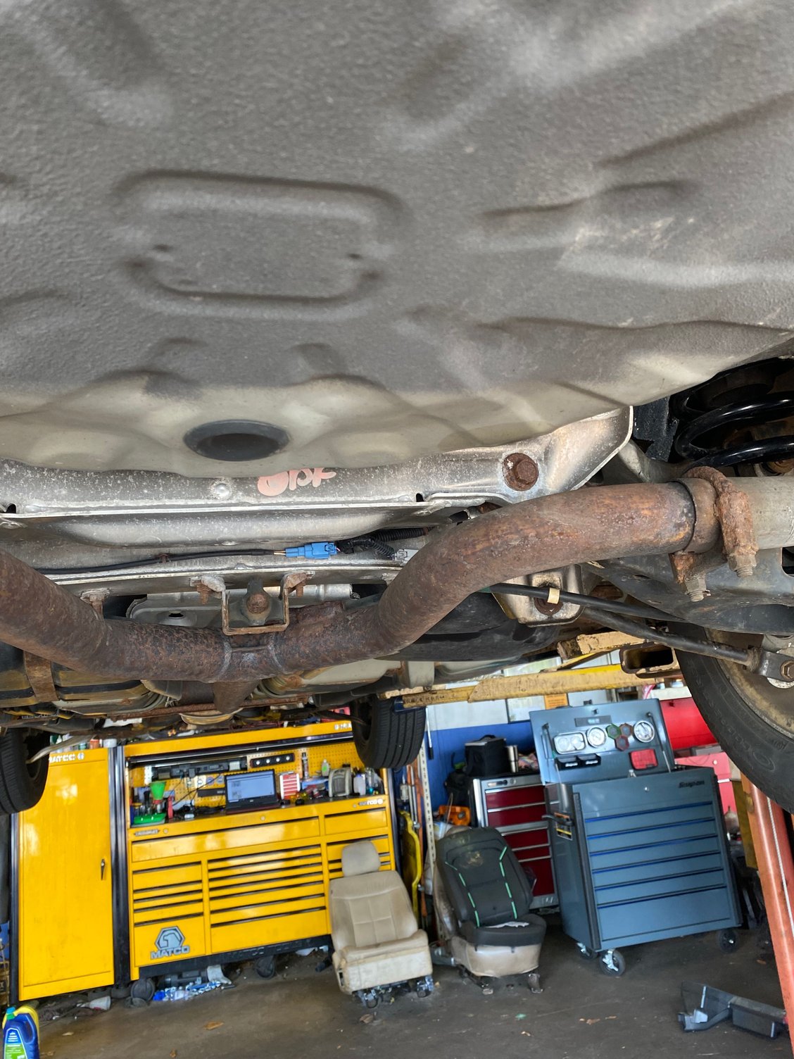

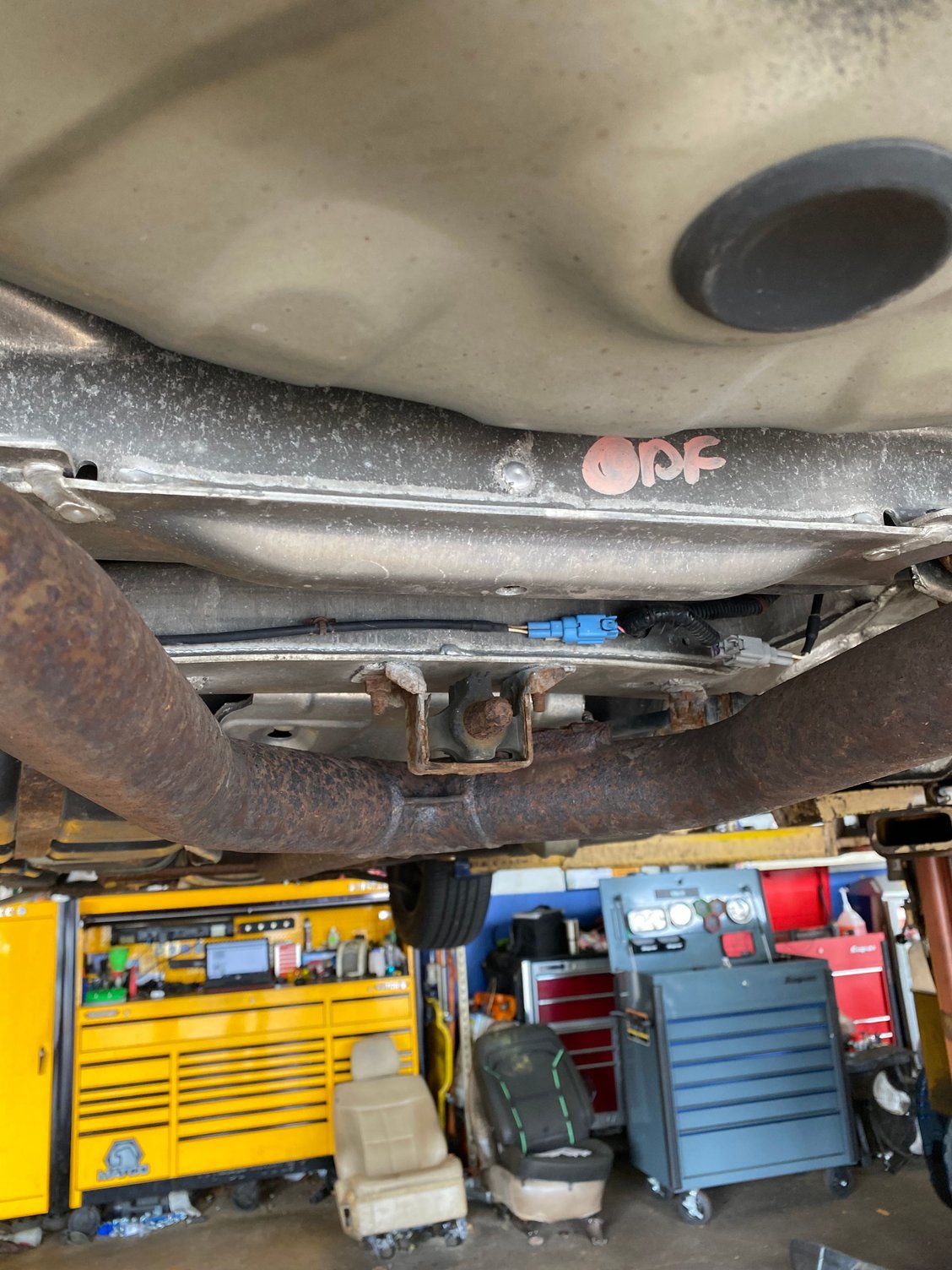

It's for my wife, but my name is on it. It's at 128k and came with:
-a minor valve cover leak (I can fix easily)
-possibly more than minor CV axle leak (hopefully not trans leak)
-warped rotors (thought I could fix, but....
-undercarriage swimming in rust and rotor bolts welded by rust
-caliper pins also nearly welded in by rust, but pads had some meat
-also the front shocks seem to be long dead because I can feel every bump on the road
-and the tires are very slightly separated

Shortly after posting this, I took the vehicle to a Pep Boys for a suspension inspection. I advised the writer I knew of many issues already and could fix them on my own, but that I struggled to get the rotor bolts out, hate doing shocks/struts, and was ill-equipped to replace the CV axle, so more than likely if their pricing was competitive, they'd do the work. I was called over to the lifted vehicle and advised that they would not be performing ANY work due to the excessive rust. I will upload some pics I took at the time and should note that some parts of the chassis have been replaced already with junkyard grabs. This gave me a strong suspicion that the dealer only replaced the few parts in an otherwise entirely rusted chassis just so it would feel more stable during test drives.
After contacting the dealer and voicing my dissatisfaction, he wouldn't relent to granting a refund or return of the vehicle and to the best of my knowledge such refusal is legal for him in Georgia, because the car is so old at this point. However, I agreed to keep the car as long as he would find a fabricator or exhaust shop that could make the vehicle mechanically fit and so far he is agreeable to that compromise. I must imagine replacing the subframe and a large percentage of the exhaust system is what we'd call a "big" job", but if anyone here knows of some tips to make it easier, cheaper, or quicker, please share. I finding tons of old/wrecked maximas to use as parts cars, but will I be better off just finding an OEM subframe (front & rear) and having that installed?
Do these subframes drop straight down or will everything have to be detached and engine hoisted/set on blocks so it's free of the mounts?
Or...should I demand a refund and threaten legal action? Knowing how the courts work here, going that route would mean the vehicle cost and other associated costs may not be recouped for years, so I don't think I want to go that route, but please share any legal advice if you have some about this.

Return the car to the dealer, and state that you feel unsafe driving it. Be ready to lawyer up.
Did you look under the car prior to buying it?

I am not sure what part of US are you in, but my 97 Maxima SE that I bought in Chicago had little to no rust when compared to this one. There are large sections of floor missing.
The structural integrity of the vehicle is in question, I don't think that this will be a cheap repair. Is the dealer paying for it?
I would go to hell and back just to get my money back. That is some shady dealer right there telling you that all it needs are the brakes.

I have an 07 Maxima in New York.... You just purchased a 16 year old car and it looks like from a rust belt state. Both your driver and passenger floor pans are gone the only thing stopping your feet from touching the road below you is carpet and padding . I replaced the passenger side floor pan, it was fairly easy and you need to do it right away. The other rust is surface rust under the car on the frame. The exhaust rust... is what it is ....and you replace parts as they fail. It needs some love. You do not have Rotor Bolts ...Your rotors will come off when you remove the wheel and calipers as that is the only 2 things holding the rotors to the hub . The bolts you are referring to as Rotor bolts are your 5 wheel studs that are on the wheel hub, that is pressed into the bearing on the knuckle. you replace the bearing and hub when needed . You can PM me if you have any other questions or need how to info .

You need to call NHTSA asap about this matter. You do realize that is the underside of the carpet Right. The floors are rusted out and gone. This car is not safe. Structurally it is not sound and should not be on the road. The rust on the subfame is not the issue, the Lug bolt attached inside the body appears to be pulled through. Take my advice, park it until you can return it. Call a lawyer and move asap on this matter. DO NOT fix anything on it. Return this car. pm me if you need to.

from the look of the photos look like it was flooded car sat in standing water that a lot of rust to see and definitely not sellable car or safety either. Return the car, they belong to the scrap yard! I hope you did your homework and what they hell are they thinking of selling the car, that dealer need to be revoked to be a selling dealer.

Take that car back, it is an accident looking for a place to happen.
