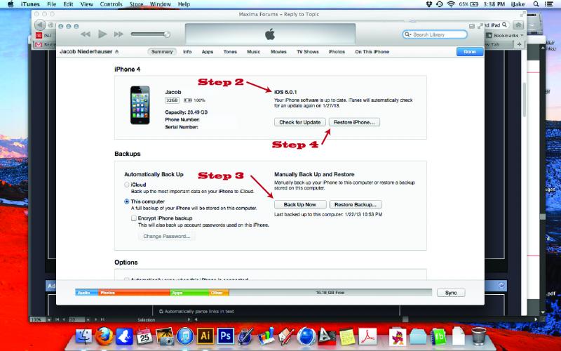

An update about pairing:
I took my Max into the dealership to have a backup key programmed today and asked if there was a firmware update or anything else that might fix my problem. All my firmware was up to date. I was about to give up but figured I'd give one more thing a try. I think I fixed my problem (phone wouldn't connect unless I went into bluetooth settings menu on my phone every time I started my car).
Here's what I did:
  1. Connected my iPhone to my computer via usb cable.
  2. Made sure my iTunes and iOS were up to date.
  3. Backed up my phone using the "Back up now" button in the "Manual back up and restore" section. (not sure if this was necessary, I think it might do it again automatically in the next section, better safe than sorry though I guess).
  4. Clicked "restore iPhone..." (located up top under where it tells you what version of iOS you have). This will reinstall your base operating system and then will set all your settings back and reinstall all your apps, pics, texts, ect.
  5. I went into bluetooth and selected "forget this device" for "My Car".
  6. Went into the settings menu in my car(left phones bluetooth off for this part, not sure if it matters) and clicked "forget this device" for my phone.
  7. Turned bluetooth back on on my phone and "re-paired" my car and iPhone.
Everything seems to be working great after doing this. Hope it helps!
