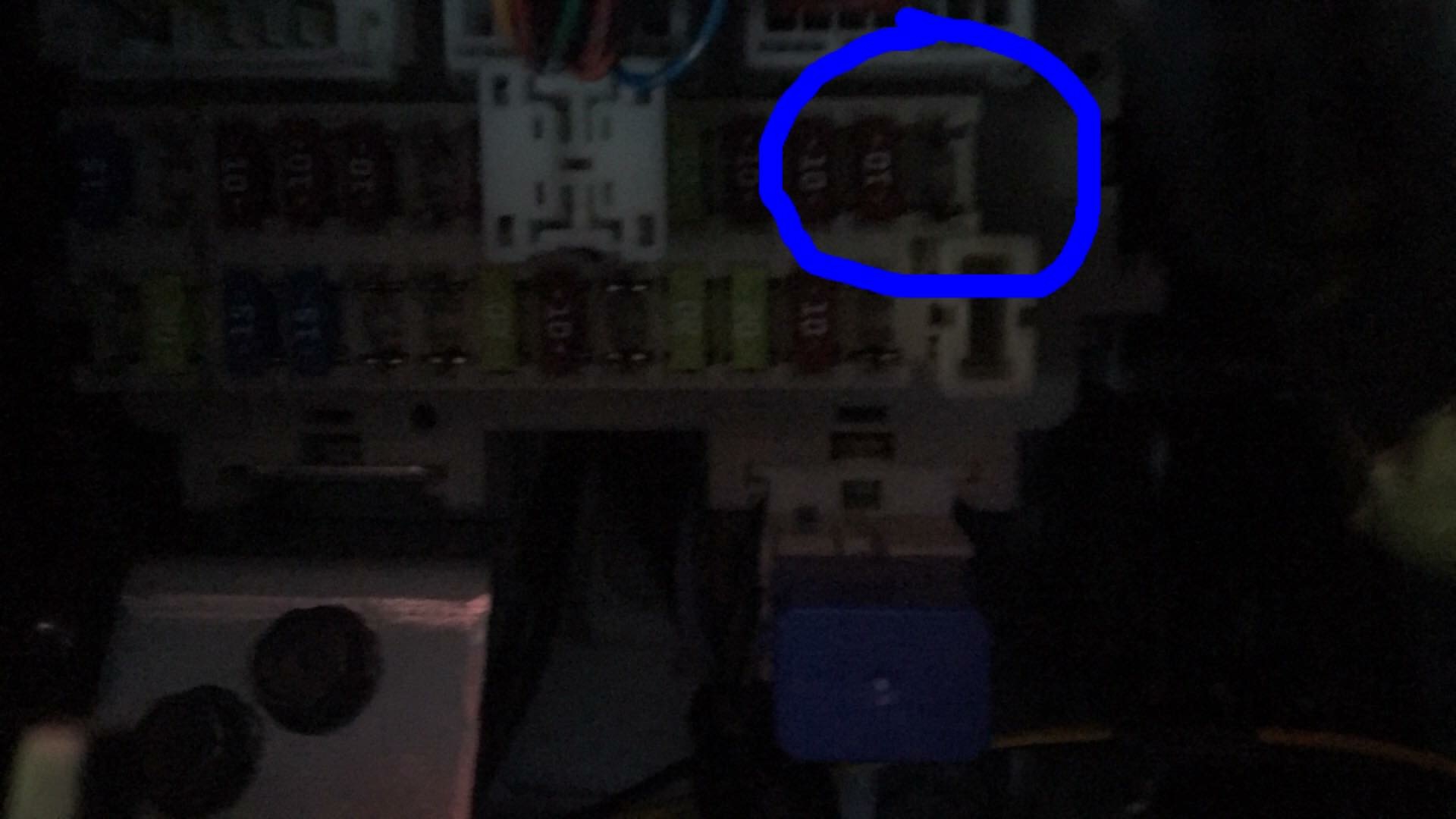

Now the gear shift won't come out of park unless I hit the unlock tab right by the shift. The AC Still won't come on either?
Old May 27, 2016 | 07:16 AM
  #60
Squiddoc's Avatar
Joined: Jan 2016
Posts: 46
So I figured out what it was. A blown 10 fuse called "elec parts (ign)" 2nd from the upper right in the driver's fuse box. A real pain in the a$$. I still want to put the nexus but i need to get the wiring down.

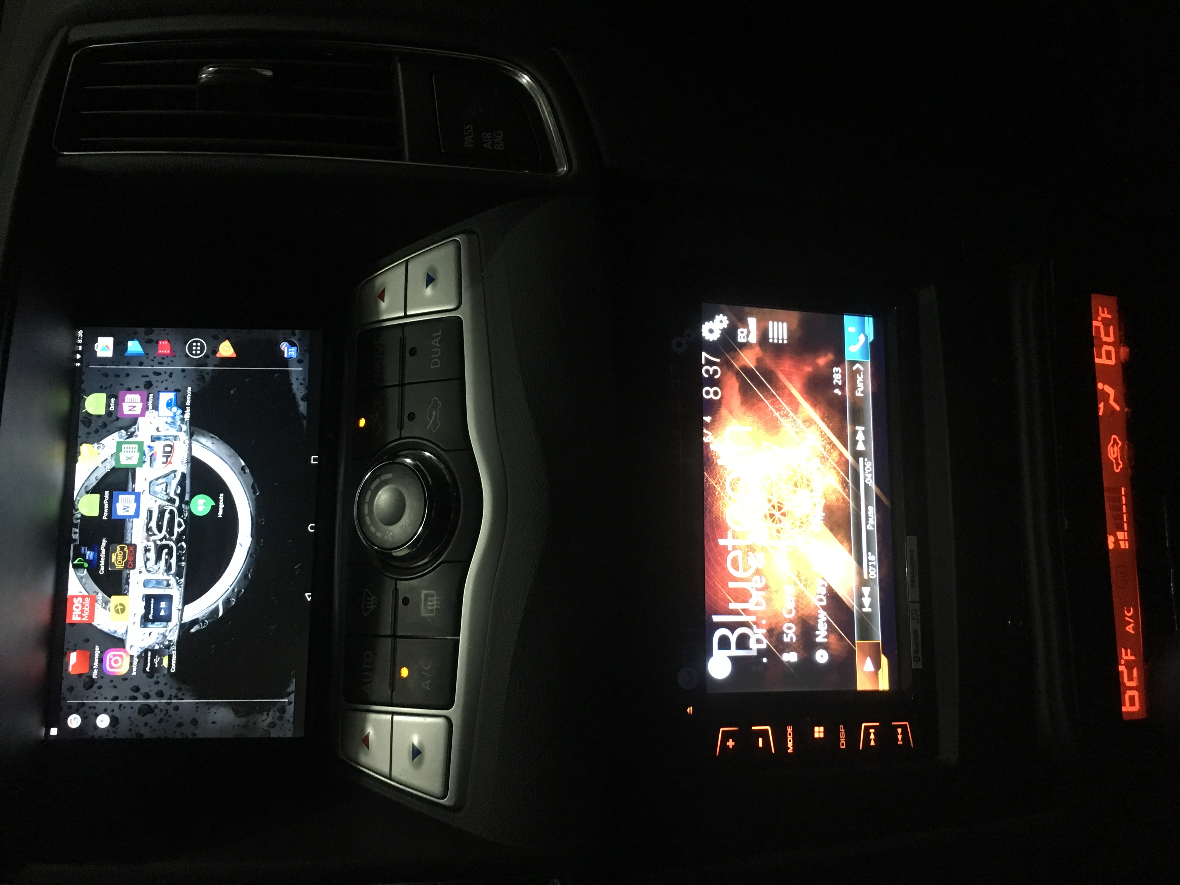

No More Amber Screen.

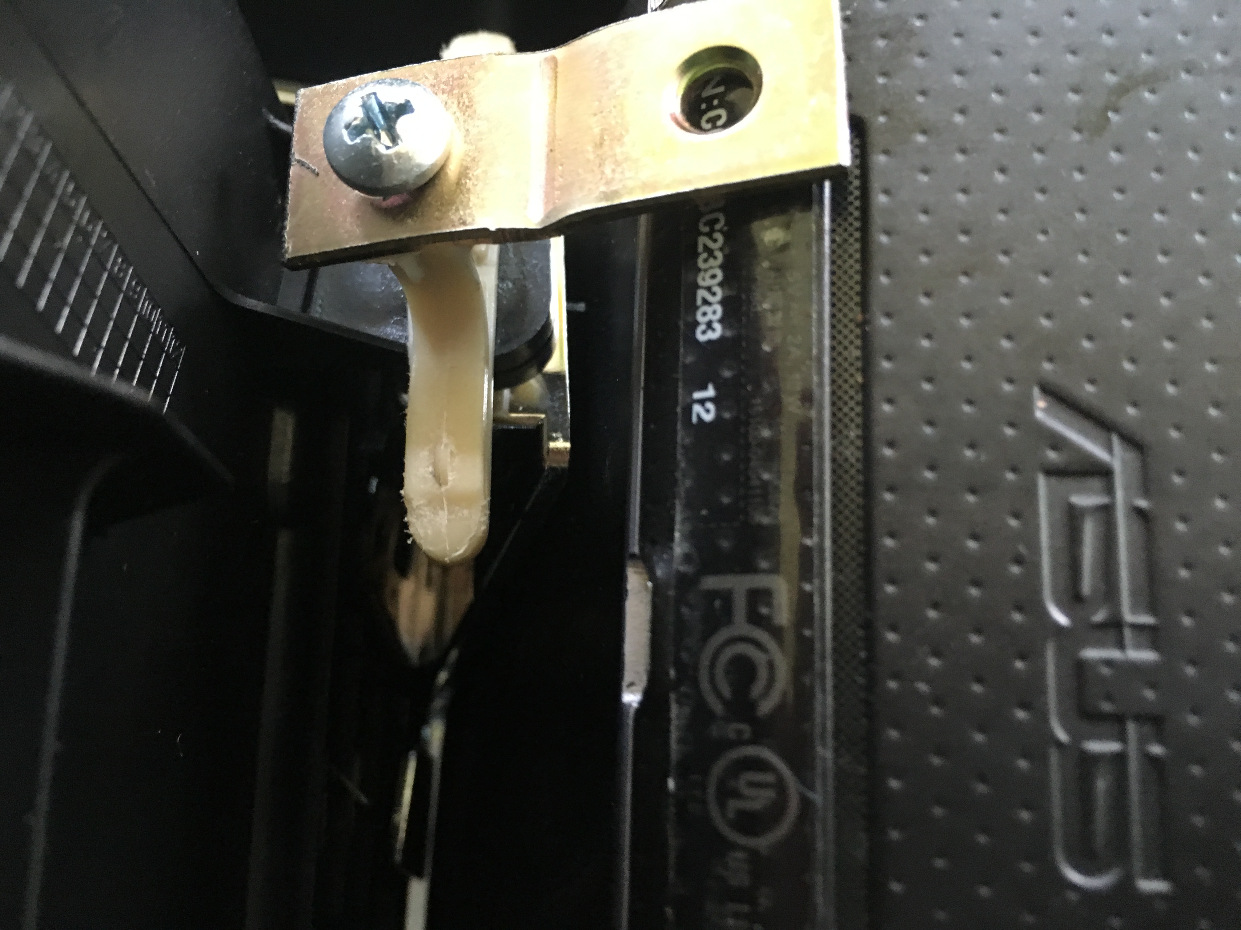

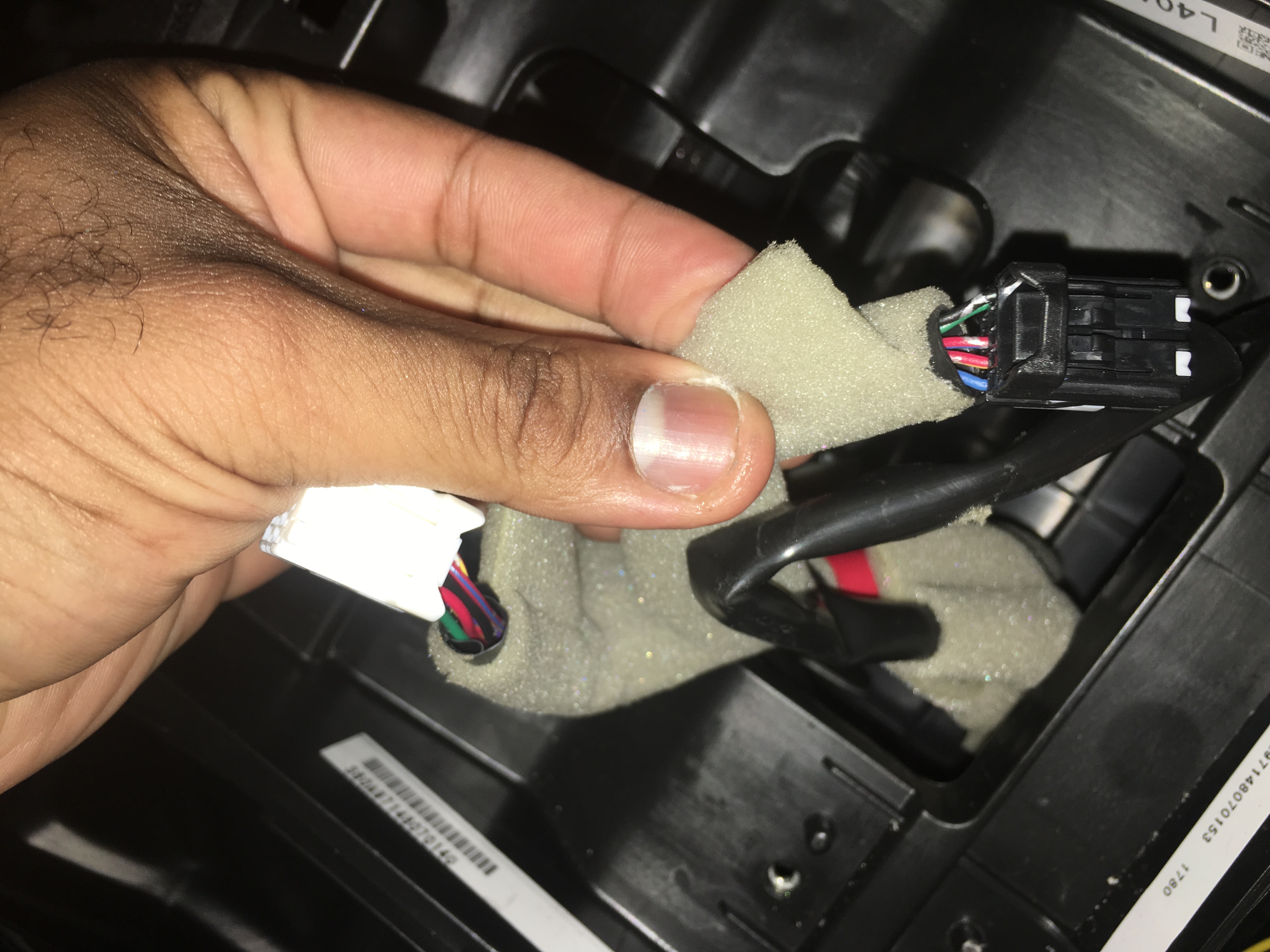

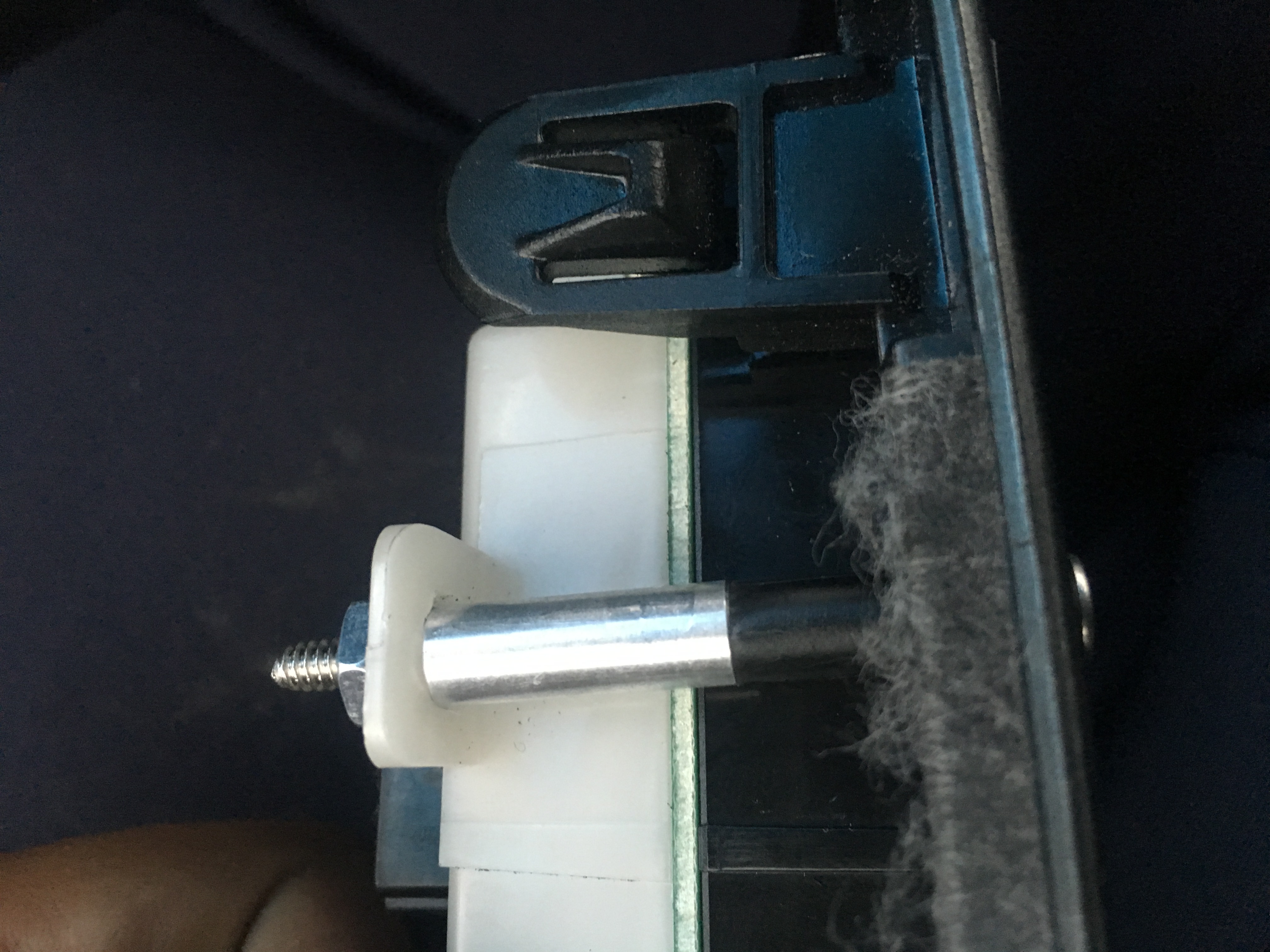

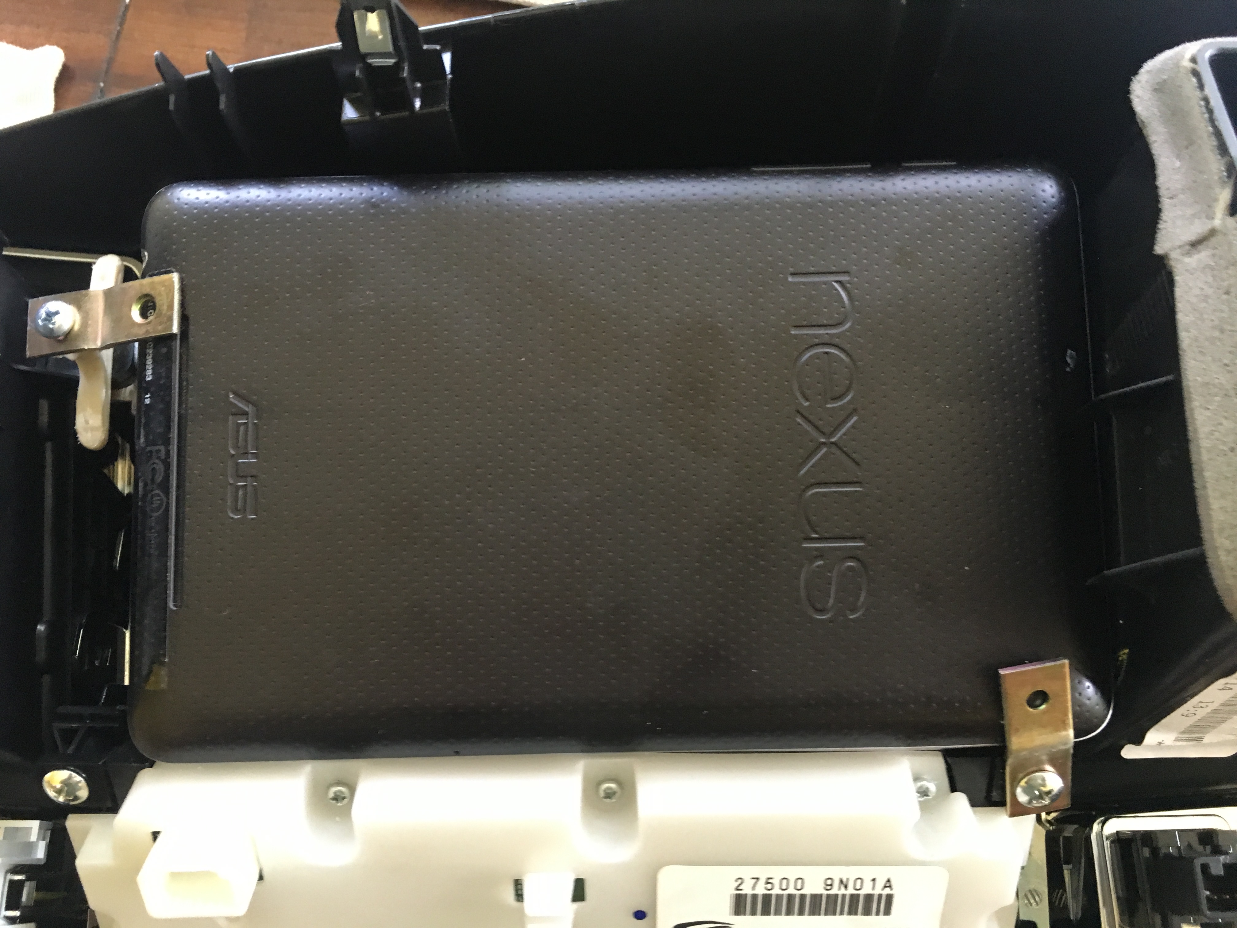

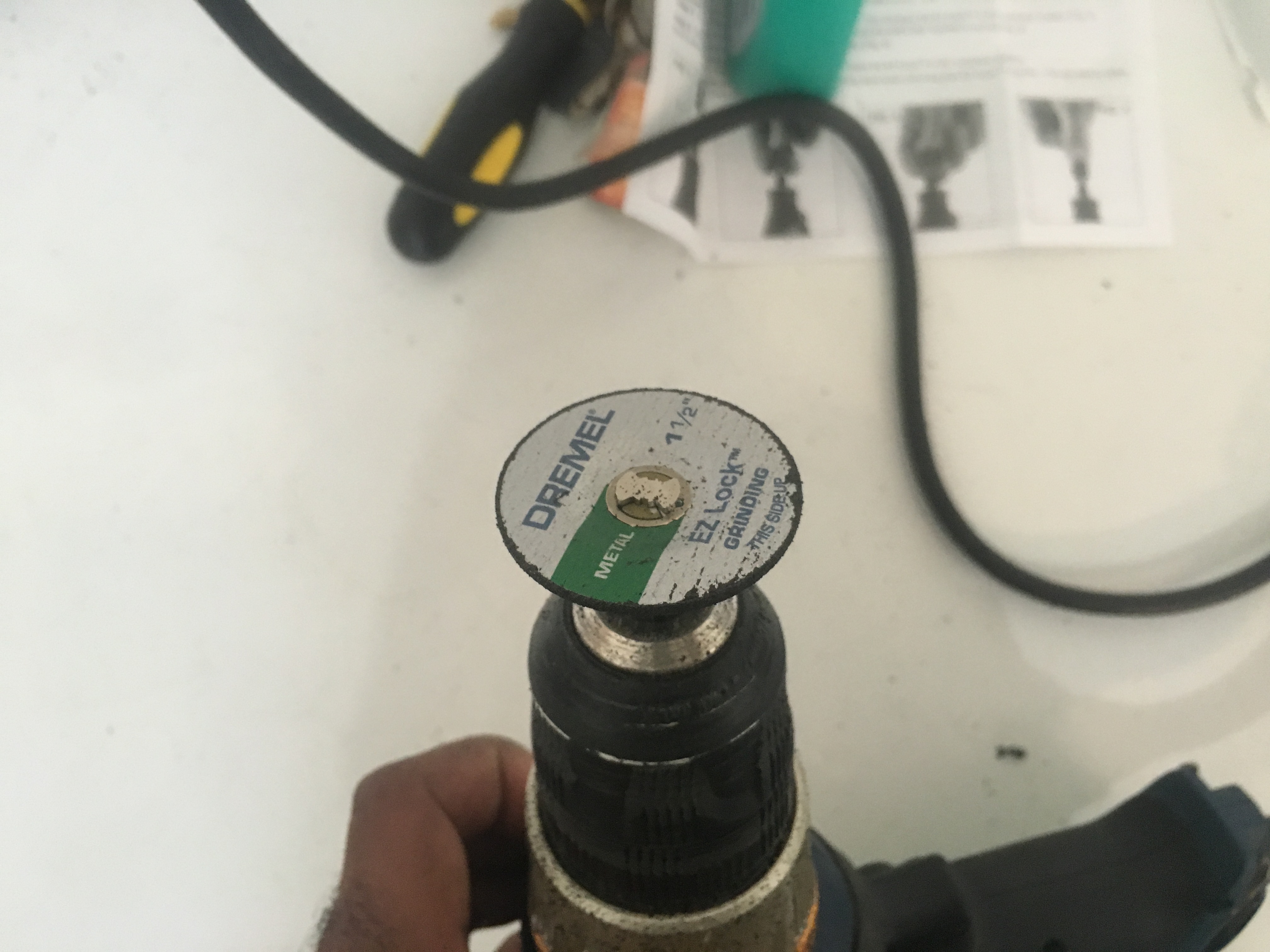

I was able to get the Nexus pad installed. I used 1ft of 5 wire thermostat wire from Home Depot to splice and extend the temp. controls from the original position to the lower position of below the head unit.
I used some make-shift brackets from elbow joints (also from Home Depot) that I bent with pliers and a hammer to hold the Nexus in place. I think I might open it back up and glue it because the screen is a little off.
The tough part is mounting the temp controls below the head unit. The temp control is a little bulky, and there's not enough space to sit the temp control back flush with the interior. Everything works as it is, but I'm not satisfied with the finished product. I think I will be tweaking things in the coming weeks until I'm where I want to be.

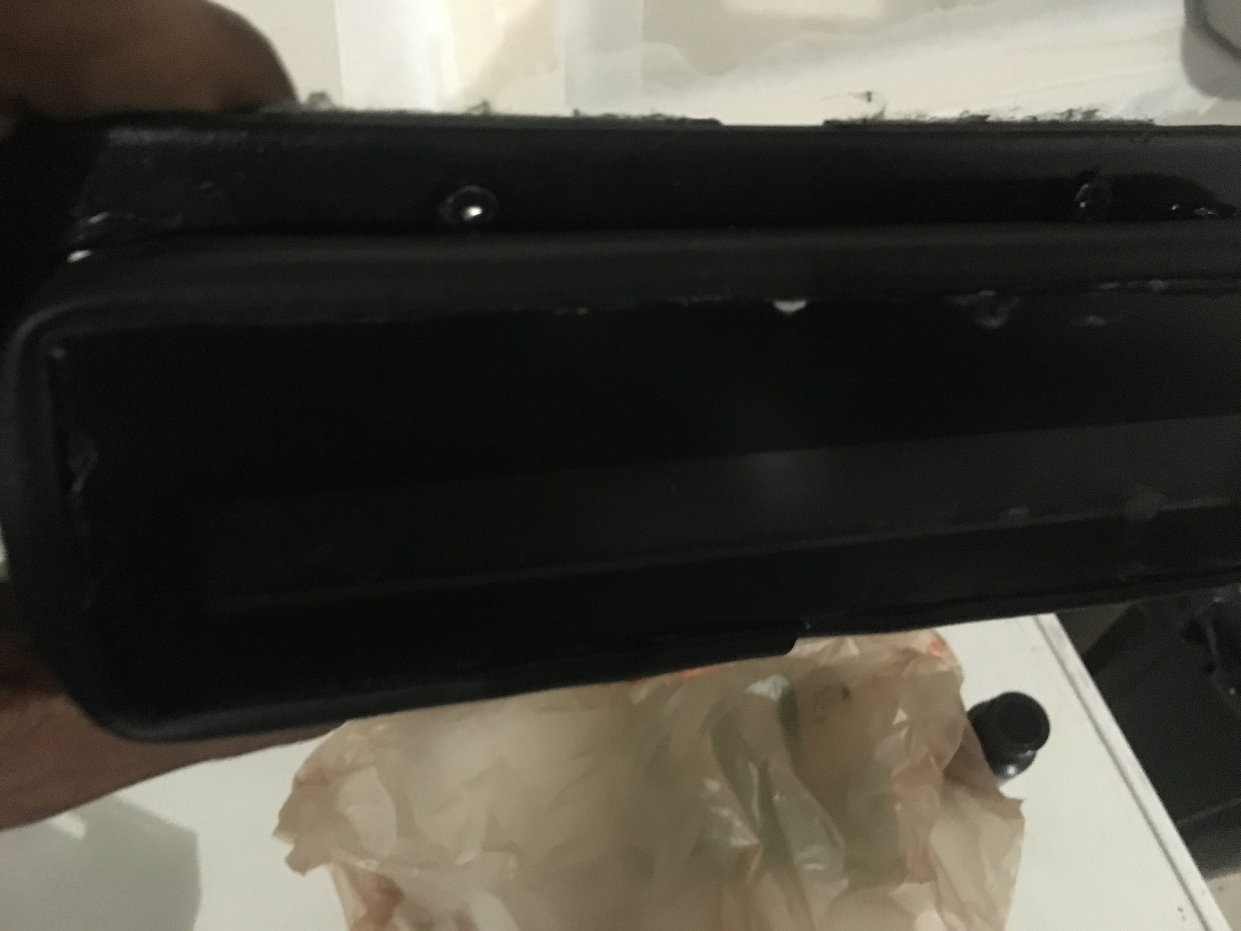

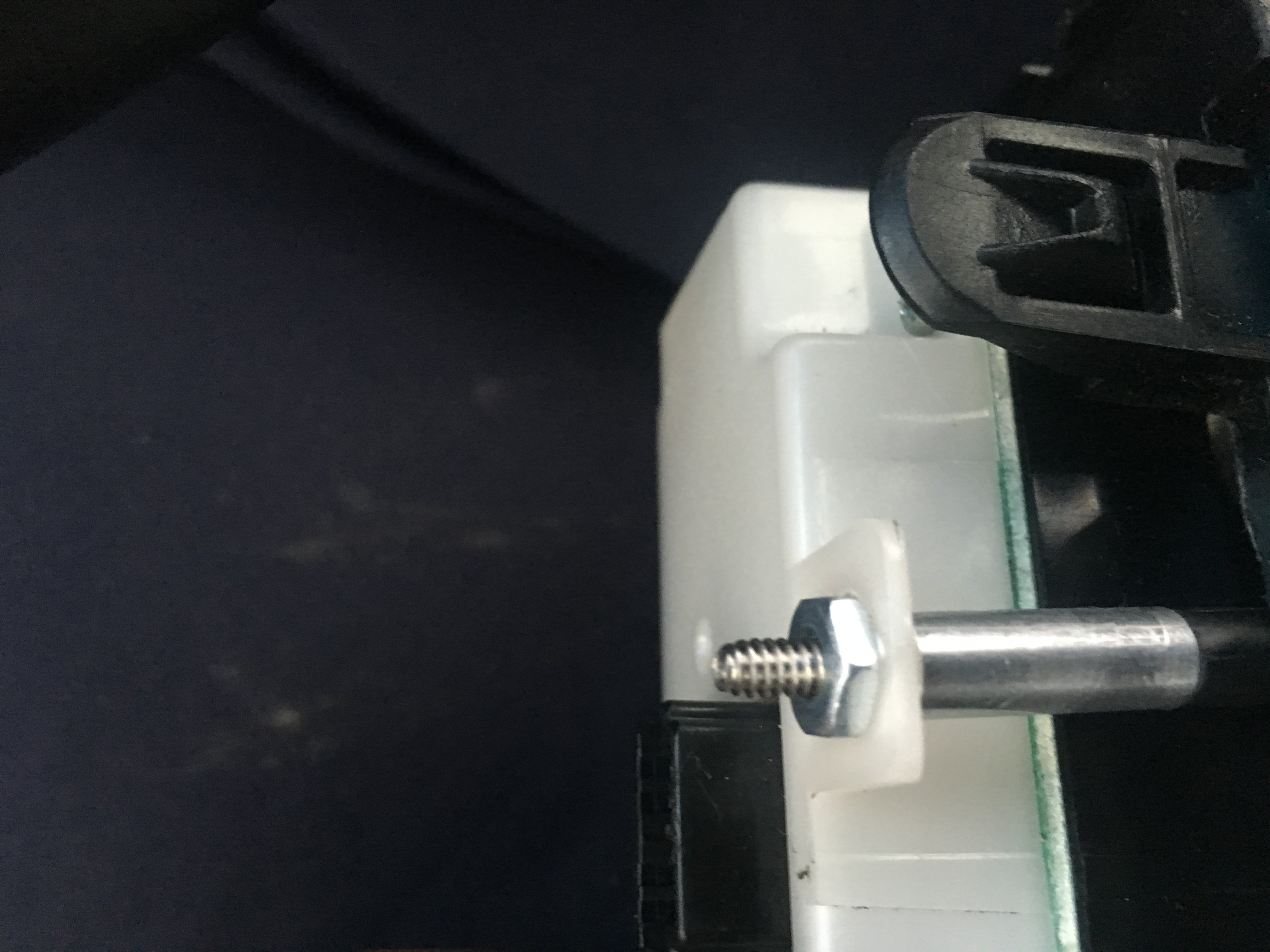

I changed a few things on the temp. control for the A/C. I just added some weathersealing from Home Depot to go around the control. Everything works fine.
I also used a little hot glue on the clamps to reinforce them to the back of the Nexus pad, but I honestly don't think it's necessary.

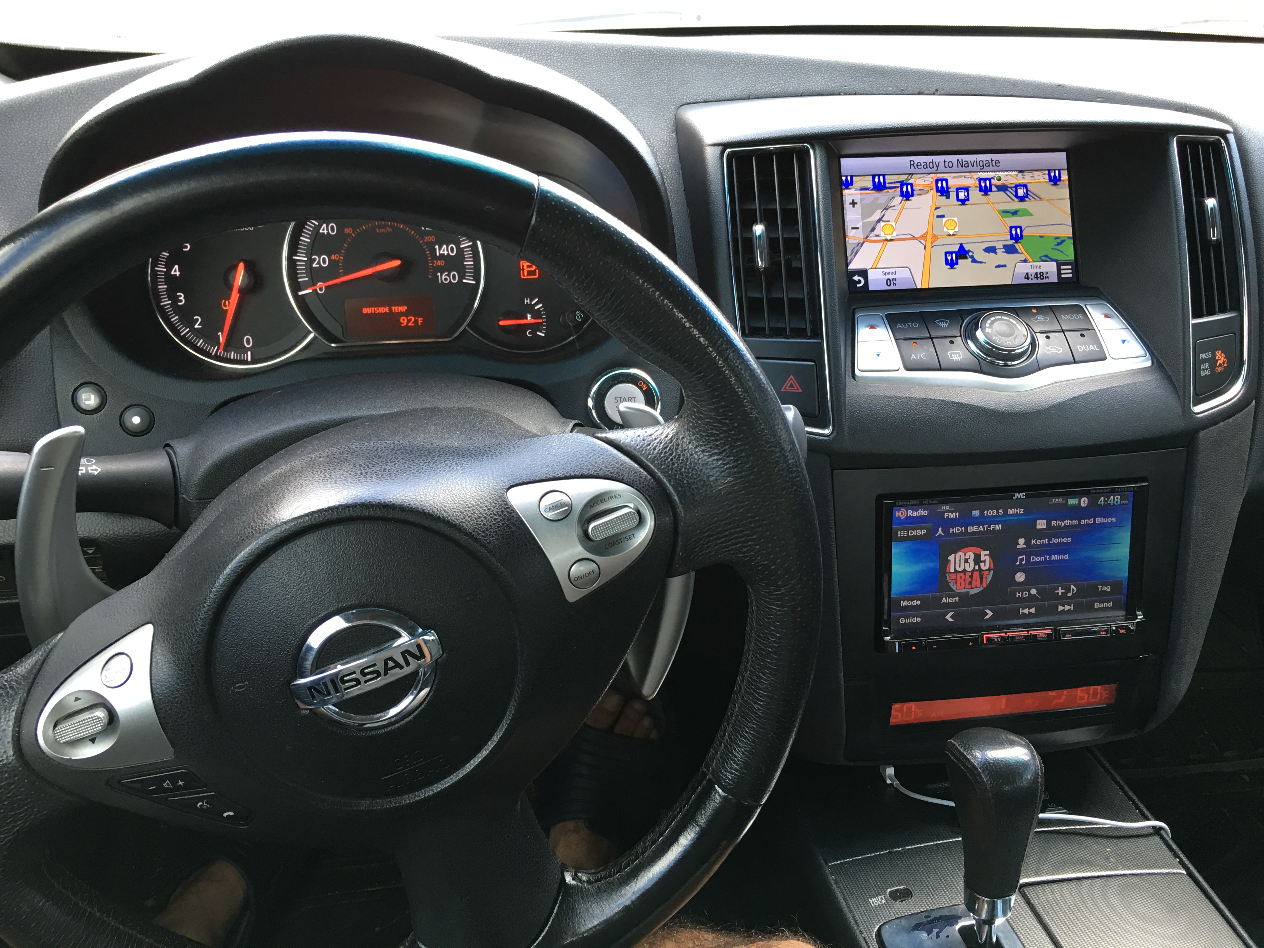

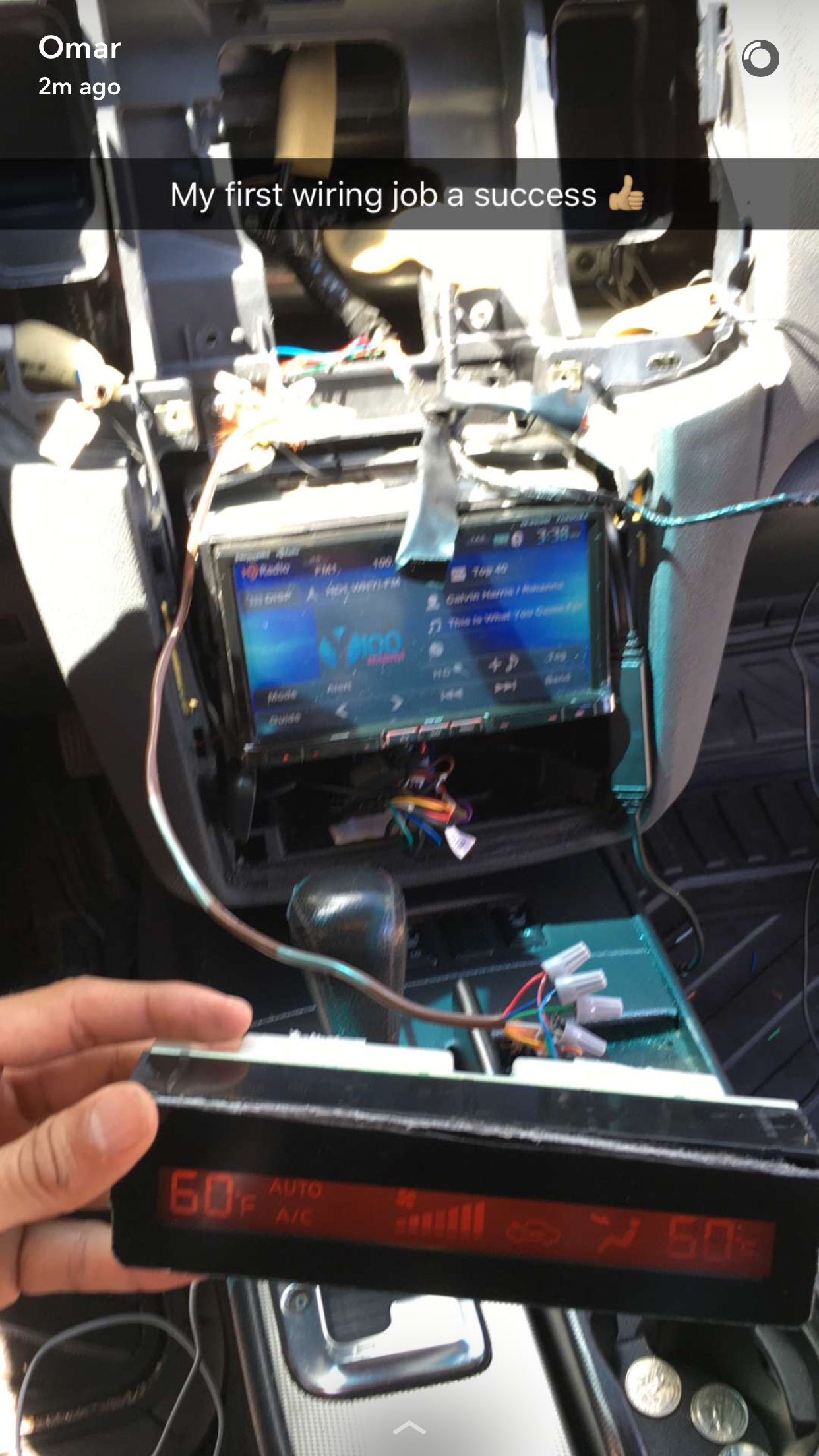

My setup
2009 Nissan Maxima
Closest way to make your console look like a Q50 console
-7" Garmin Gps replaced amber screen
-7" JVC touchscreen radio headunit
-Relocated climate dispplay in the bottom of the radio by retro fitting bottom cover and extending wiring with a 5 wire thermostat cable.
Best way to work on a maxima with non tech package.
