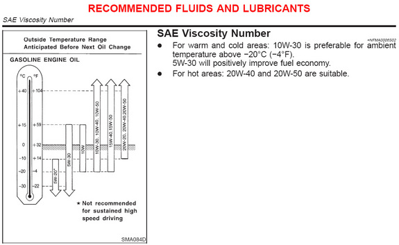

Thanks for the link... I'm trying to make my way through it, but it is LONG! I've gotten about half way, but still haven't found anything to convince me one way or the other. Can you elaborate on why you went the 40 route... I'd like hear your opinion on why you decided on a 40w vs. a 30.
I also think it is an interesting subject with regards to CAFE mandates in the US. It makes me wonder why the same car that is recommended to use 5w30 in the US is then changed to a recommendation of 5w-40 in Europe. I really have to wonder if the engine was actually built to use 40w but due to regulations, companies are now recommending 30w for the MPG.
I've also read over and over again how the VQ "loves thicker oil" but can never find any facts as to why... only opinions.
Here is a pic of the European Viscosity chart for our car... Makes you wonder.
I run the 40 weight cause it shows much better UOA, and also I know with my current driving style my engine is possibly faling into the range of more premature wear and Im trying to run a better oil for more protection.
