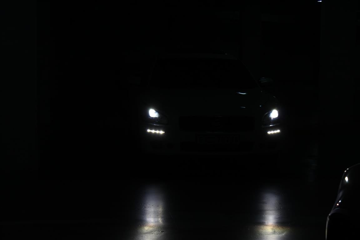

Instructions: Like mentioned earlier, To access the left light, turn the steering right, and remove the protective panel above the tire. Stretch your hand inside for the cables. There are two amber light bulbs in our headlight, the outer bulb should be disconnected permanently. The big amber bulb (inner one) has three cables (green, green, black). One of the greens needs to be cut, make sure you have a tester so you'll know exactly which one to cut. Same procedure goes to the other side.
Couple of low exposure shots so you guys can see how mean the car is now
