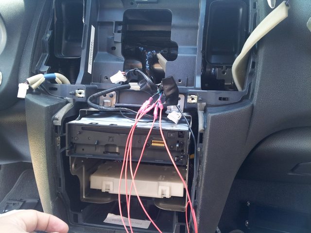

Here's how the tablet is held in:
Yes, a bit Ghetto, but I assure you, it's solid in there. Not moving one bit.

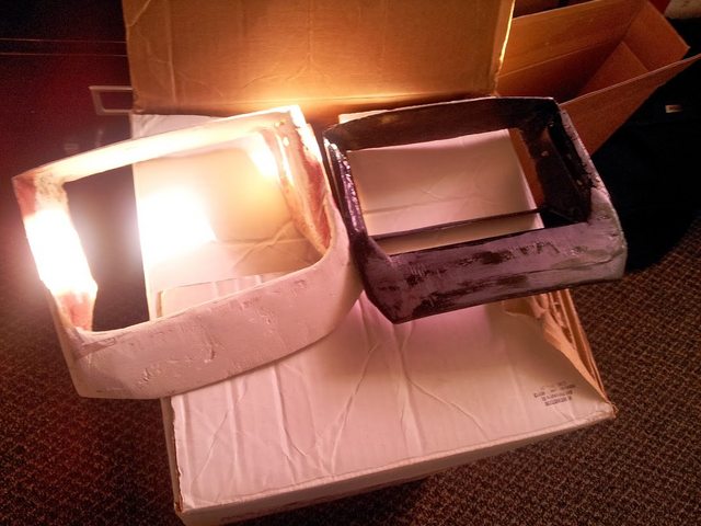

The main event: The On-Face Custom Mounts.
Mark I and Mark II (in progress) side by side
The Mark I is really heavy so I decided to try again with the fiberglass, moving from 4 matts thick to 2, and using much less resin and bondo.

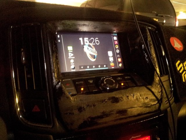

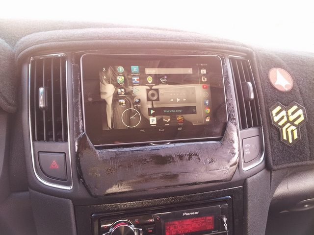

Here's the Mark II and how it currently sits:
Anyway, progress is slow and steady, but currently I'm happy with how this idea is turning out. Any input from you fiberglass gurus would be great. Thanks for viewing.

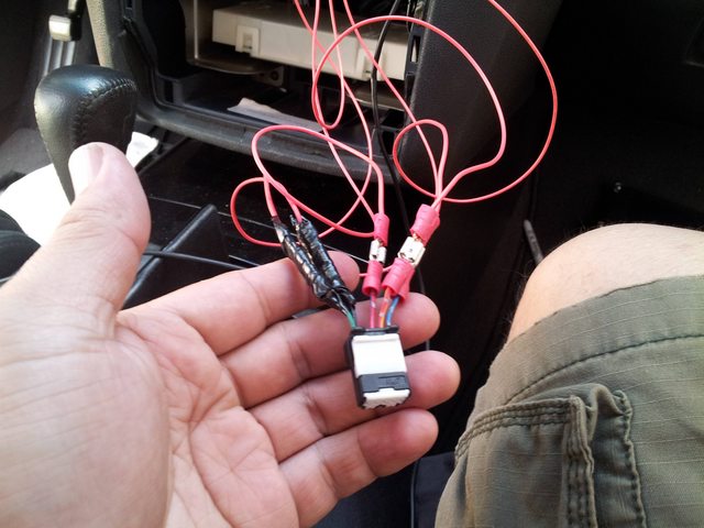

You really have little option but to cut the wiring and extend it by soldering or crimping wire connects (like I did).
Those are simple crimp connectors that you pinch on each end of the exposed wire. They're not the best thing to use when you consider thermal expansion, but crimp them hard enough and ensure the connection is tight, and you should be fine. I taped each one up after testing as well.
The endwires and harness were fitted with male/female wire connectors that also require you to crimp the wire to fasten on. Note: you can still use those simple crimp connections on the previous joints. I forgot why I decided to use the slide connects...

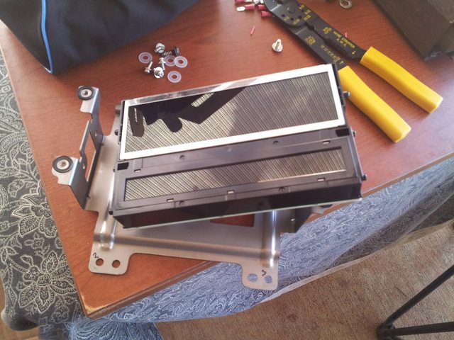

That's basically it! Use about 1-2ft of length on each wire to extend and make sure you match up the correct colors to the end points on the harness. Yes, nerve wracking to cut OEM stuff, but once you get past that it's all cherry. Best part is if you do need to go back to factory, you've still got that line intact and never really have to remove the added wire.
If you're not too confident about cutting and stripping wire, practice a bit on some 16-18 gauge with a wire stripper. Depending on what wire stripper you use, the job can be easier. If you look up "heavy duty wire stripper" or "automatic wire stripper" you'll find the easiest of the bunch to use.
I used one of those manual ones in the upper right (yellow grip)

Ya I did basically what he did above but I used solder and heatshrink because I hate crimp connectors. I just removed everything and lined the waterfall section with aluminum foil to prevent any damage. I also wanted the added protection from moisture because it is close to the HVAC system. Even to relocate the HVAC display below the head unit required me to extend the wires about 4 inches each. For the price of me flying down to Texas and staying there for a couple of days, you could hire an audio shop to do it. Nothing is hard about fiberglass and body filler. Just spend the money and buy they right tools and make sure you have enough time. This is my second fiberglass project ever. It isn't rocket science.
