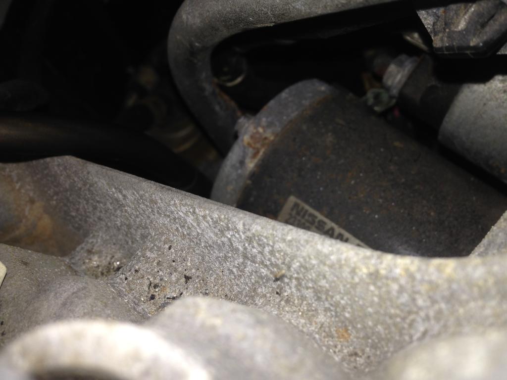

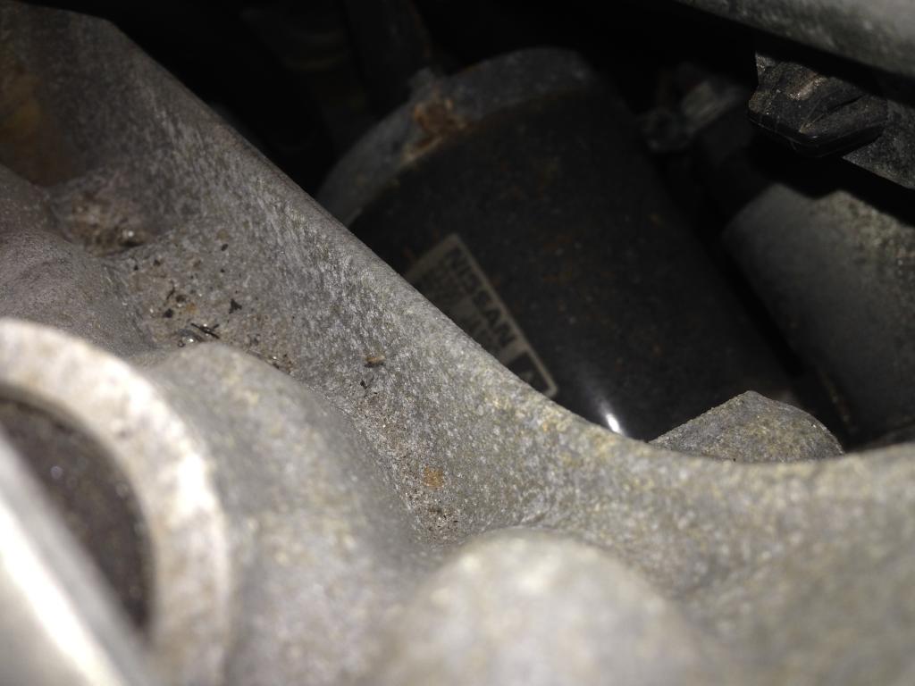

I need help before I screw it up, I have to put one wire from the chassis to the long barrel of the starter, the area is so tight I can't get in there with any tool to loosen the bolt. Is this the correct bolt or is it the Philips screw to the left on the other part of the starter
Just so I know I'm right the long barrel is black with the nissan sticker on it?Name:  E9E7D09C-8F35-445A-98C1-5BD34016C902.jpg

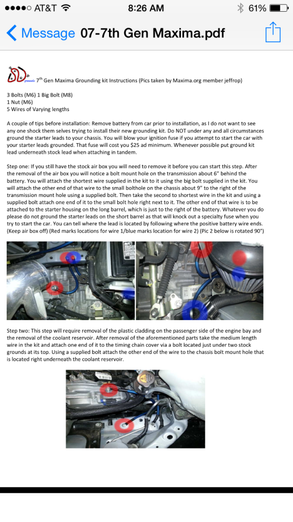

Yes it did, the directions are very good except for that picture, the picture isn't very clear, I'm just being cautious and don't want to screw it up and blow a fuseName:  443D1E9D-909F-4FE7-8374-0F67E2AA71CD.png

So I've recently done the big 3 but am concerned about the grounds. Do you mind posting all the pics in the instructions? Or message me with it? I'd really appreciate it. I'm assuming there's more than those 3 pics. I'm using 1 awg ofc wire. I have a a stereo system, that's the reason for the upgrade.

Yes it did, the directions are very good except for that picture, the picture isn't very clear, I'm just being cautious and don't want to screw it up and blow a fuseAttachment 19191
I know it's been going on 7 years since you post this but you wouldn't happen to have the rest of those instructions would you? Ive installed a high output alternator and am redoing all the grounds. I appreciate it. If you don't have it, thats cool too.
