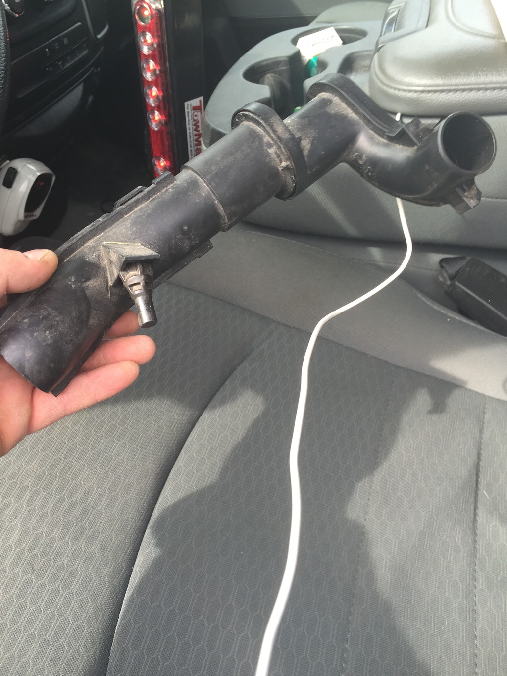

It's a long "tube" attached to the OEM intake that snakes next to the cabin.
When I installed a R2C intake I was like WTF is this thing? and chucked it in the OEM parts box.

Search sound generator in the search box and you'll find a whole bunch of info on it, and how to cap it ect. But to explain if you remove the intake box there's tube that goes from the rubber piping to the back of the firewall. Remove it and cap with pvc cap I think it's 1.5" and use the existing clamp to tighten the pvc

Here's what this sound generator looks like, forgot I had it in my trunk and snapped a picName:  E0AA2F46-D283-441C-AC47-9CA2000CB55D.jpg
Size:  350.2 KBthis may not be causing the loud engine sound but def something to look into
