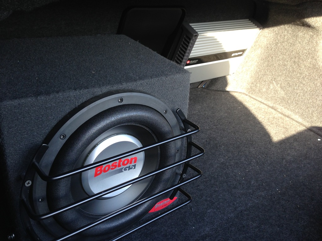

Adding an aftermarket subwoofer & amp was the first audio modification I did to my car. My car came with the Bose system. It really rounded out the system as that was the thing that was lacking the most. As stated, make sure you get an amp with a remote controller to be able to adjust the sub's volume. Also, get an amp that accepts speaker level inputs or get a quality LOC. Audiocontrol makes the LC2i, which I've used in 2 installs so far with great results.
