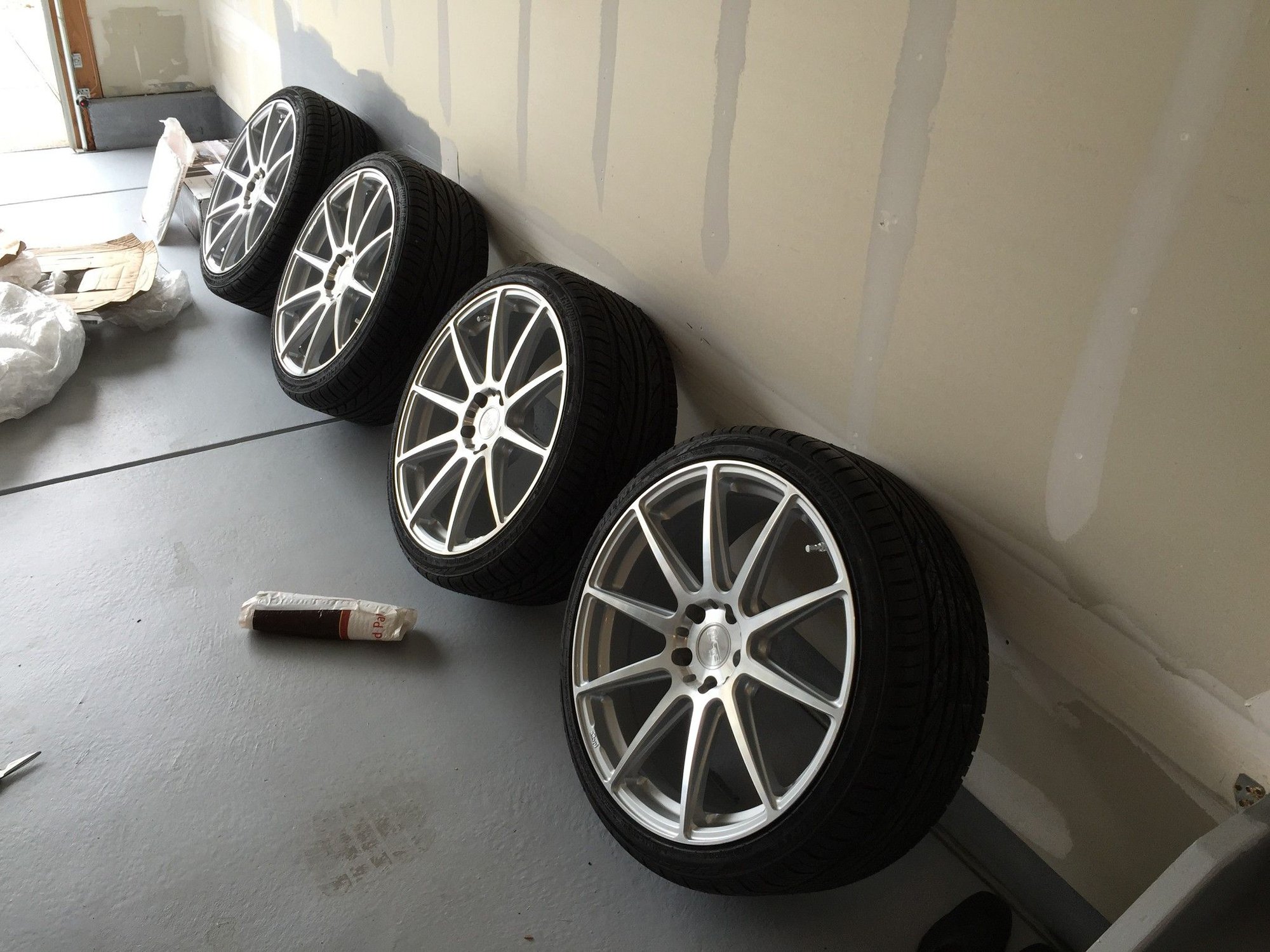

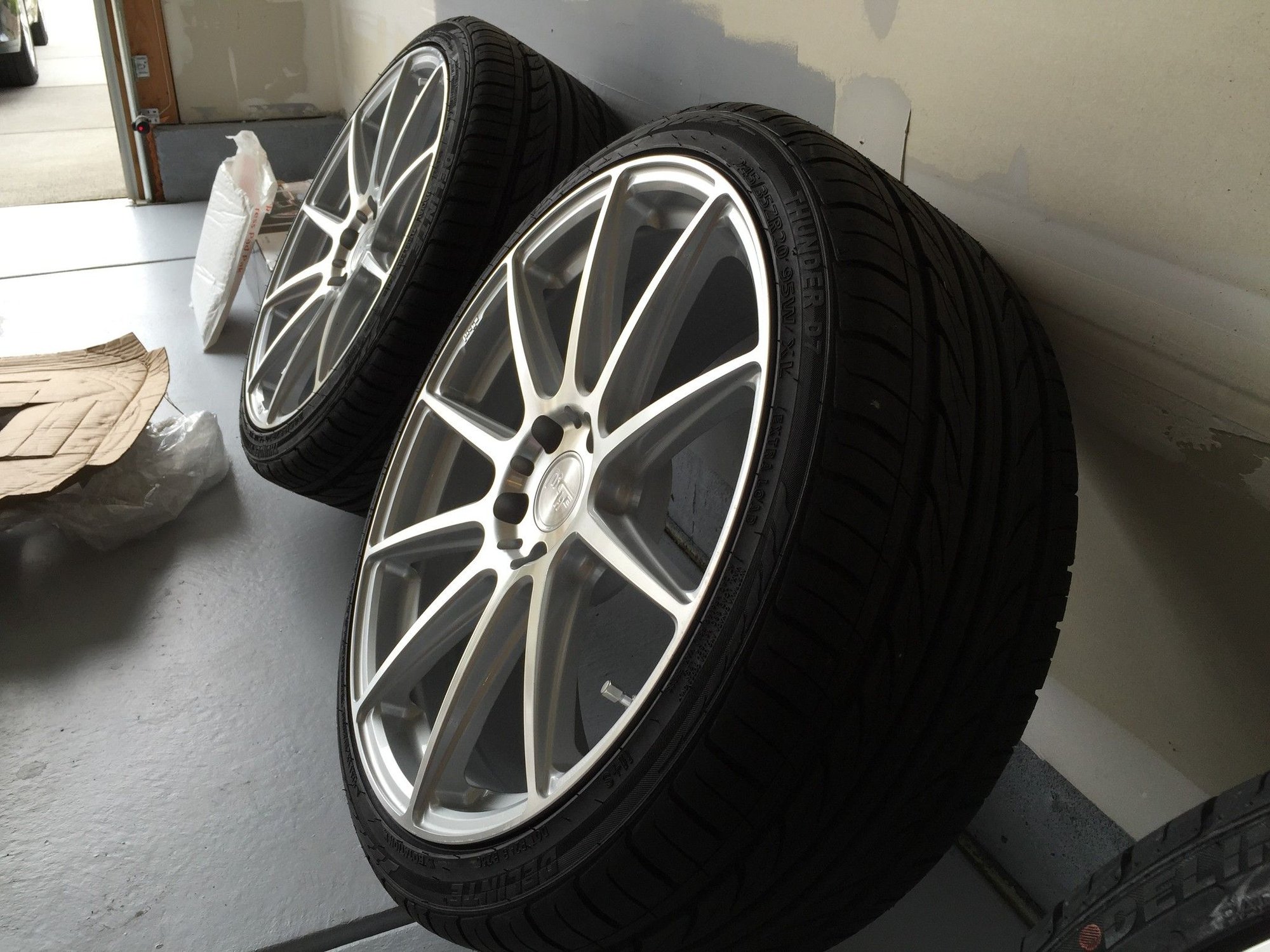

An idea of what 245 looks like on a 9" for reference:
