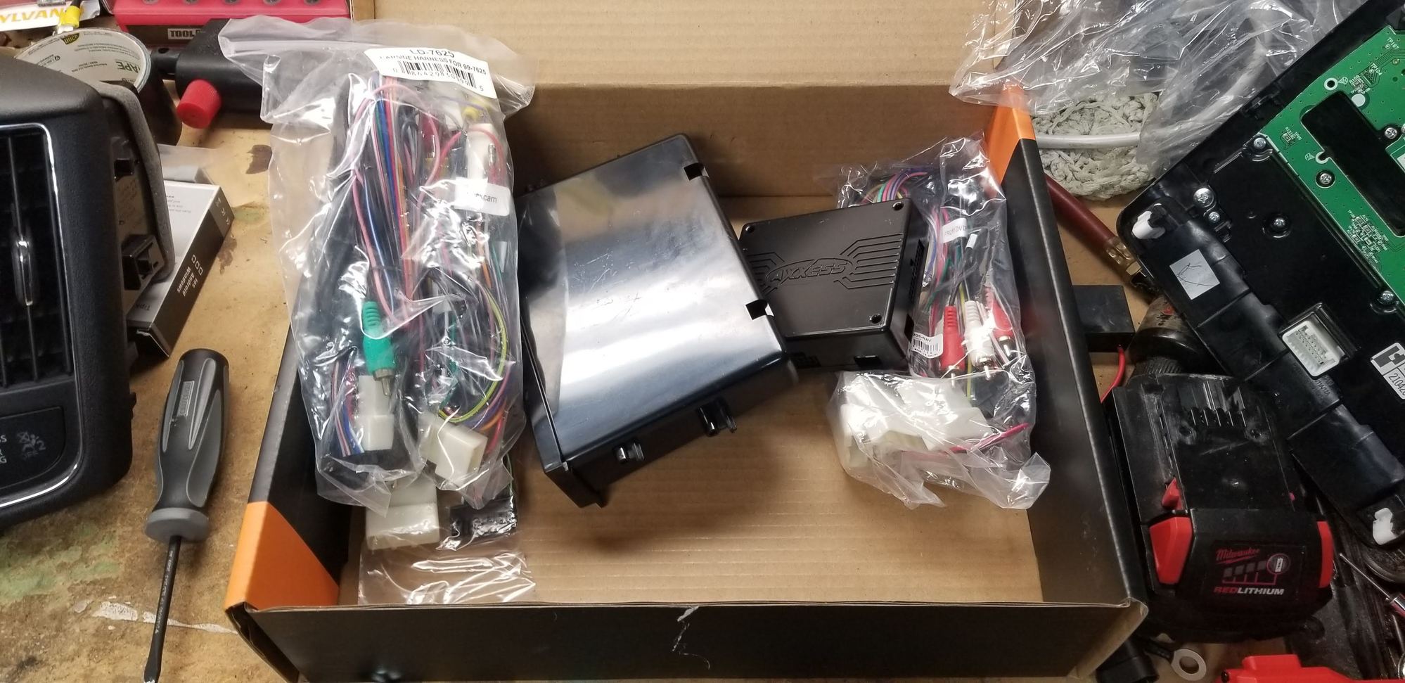

Old Nov 15, 2018 | 10:45 AM
bcrosby51's Avatar
Joined: Nov 2018
Posts: 5
I just installed it last night. Its a lot of work, but it turned out great. Added more options on the factory screen menu too.
