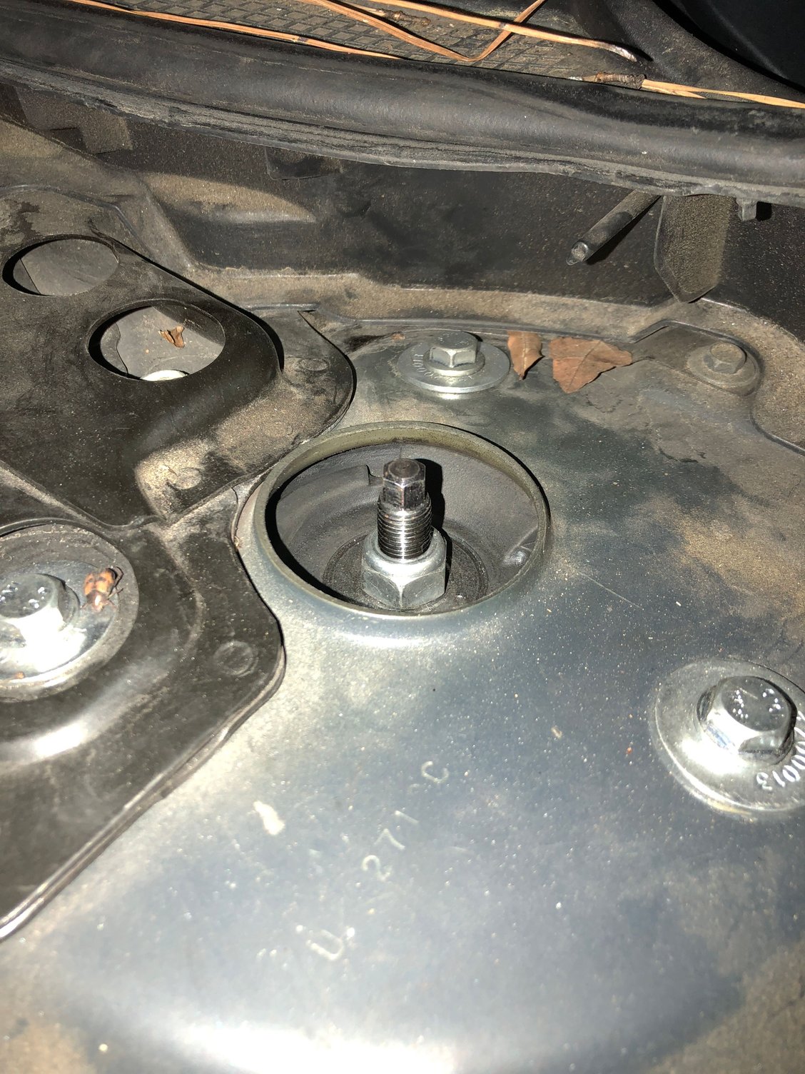

So I diy my 2010 maxima front strut replacement with original springs, the ride ended up unusually rough with loud bottoming out over bigger bumps and pot holes to the point that i feel that it got to be something wrong with my installation or parts.(was not like this with oem worn out struts 129k).
I went with New Monroe OE Spectrums from Rock Auto and new Monroe Strut mounts and Monroe Bellow and bumper kit as well, i was very careful to document the removal and disassembly as to make sure and put back everything as oem, (took pictures and marked things). there is one caveat, the lower retainer, i believe is called (circled red in the picture below ) which holds the rubber bumper I had to leave out because it would not fit the new rubber bumper of the bellow kit and it would sit loose and make noise (pictured below). by carefully looking at the assembled strut assembly i do not think that not having this lower retainer is crucial or causing the loud banging, (bottoming out) but i may be wrong.
Does someone have any idea or experience with this situation?
is there such a thing as worn out springs? 129k on them.

I dont know, how can i find out? can you tell from the pics?

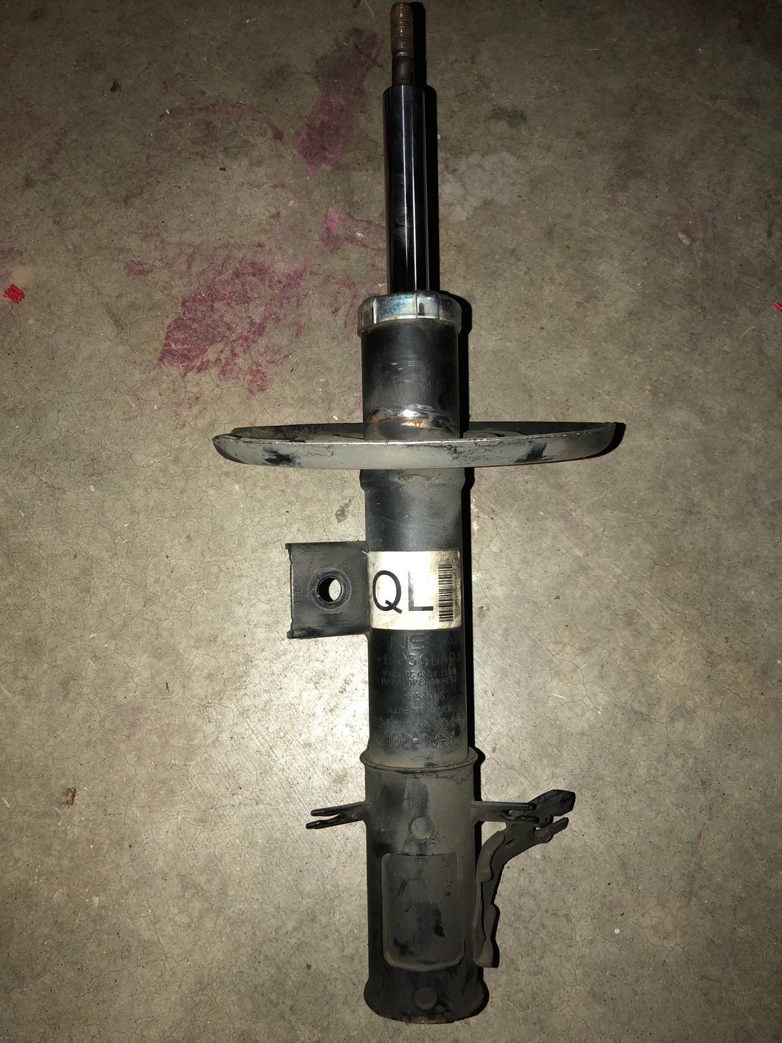

It is probably the new struts and not an installation issue. Compare the size and travel of your old struts to the new ones. Probably best to put the old struts back on and get another brand. FWIW I recently replaced my rear shocks with Monroe OE Spectrums because of the good price. They also bottomed out. I contacted Monroe and they insisted that they were the correct size shocks but I disagree. I put my old shocks back on and they worked fine. I have done a number of shock/strut installs and believe many of the manufacturers do not size these items well. Best to get OEM or from the same manufacturer that made the OEM struts/shocks. If you want to return those to Rockauto do not indicate on the website that they were installed as soon as you do that they will not allow a return for any reason. Even if it was their error.
The sport model uses different shocks/struts than Maximas with the standard suspension so that could be your problem also.
I believe if you have 19 inch OEM wheels that is sport model and 18 inch means standard suspension.

I suppose some of your other new parts could be an issue. Compare all your old parts with the new parts.

I believe I read on this forum that Sachs is the manufacturer of the OEM Nissan struts. You may consider going with them. You may also want to check the part number of your original struts and make sure your new struts cross reference that number.
I don't think your springs could wear out so much that they would bottom out. You are probably fine keeping them.
If you plan to keep the car for a while you may consider purchasing an entire strut, spring and mount assembly. Saves some work. Just do a through visual inspection comparing the new assembly to the old one before installation.

Although the Monroe 5659 OESpectrum shocks I changed in the rear appeared to be the same size as the OEM. The travel of the piston seemed less on the Monroe. I contacted Monroe and they said they would investigate. They got back to me and said that they should be fine for my 2014 sport. I disagree. They sent me another pair of new 5659 OESpectrum shocks but I just put my old ones back on the vehicle. When it comes time to replace them I will go with Sachs. Don't want to waste any more time. Although the rear shocks are very easy to change.

Forgot to mention that I did notice that I had to tighten the nut considerably more compared to the original nut leaving more thread showing
which leaves me to agree that there may be less suspension travel

From my experience over the years installing shocks/struts I do not have a lot of confidence in shock/strut sizing by 3rd party companies. I would very closely inspect and compare any replacement shocks/struts with the originals before installation. This goes for all replacement parts. This can save a lot of time and frustration.
You will get a lot of noise over bumps if the nut on top of that rod isn't tight.
