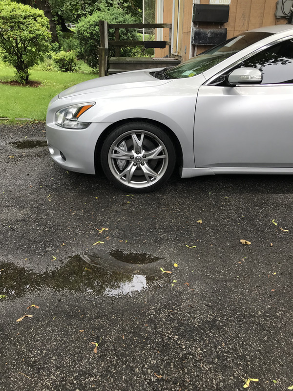

Put the Rays on. Also threw on the Jemini y-pipe
Akebono bkk will be a couple weeks or next month. Still need the short banjo bolts,stainless steel brake lines etc

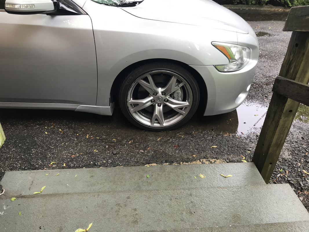

Jemini Performance Y-Pipe stock exhaust

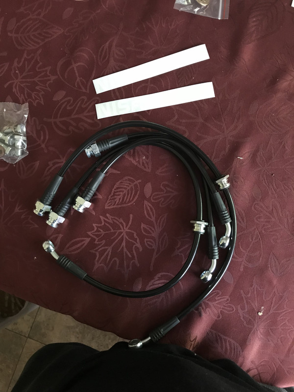

Been busy with work haven’t done anything to the car in a while. Haven’t even washed it. Here in NY we have literally had rain almost every other day for the last month. Anywho,with that being said finally got around to getting some braided brake lines. Ordered from Nisformance. Unbelievably fast shipping. I ordered them Wednesday morning around 1am. They were shipped that morning at 845am. Just arrived here at home on Friday,215. Dang

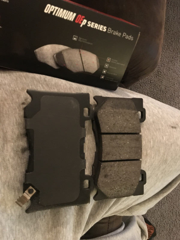

These came in today. Purchased from R1 concepts. Very positive reviews on these. Plus can’t beat the fact that I had a coupon and paid $28 shipped.
Probably won’t be putting the new calipers,lines,rotors etc for another couple weeks. Car needs an alignment,balance,,oil change,few other basic maintenance things that must come first. Plus still need to clear coat the calipers and then bake them
Also need to figure what size spacers I need to get for the front

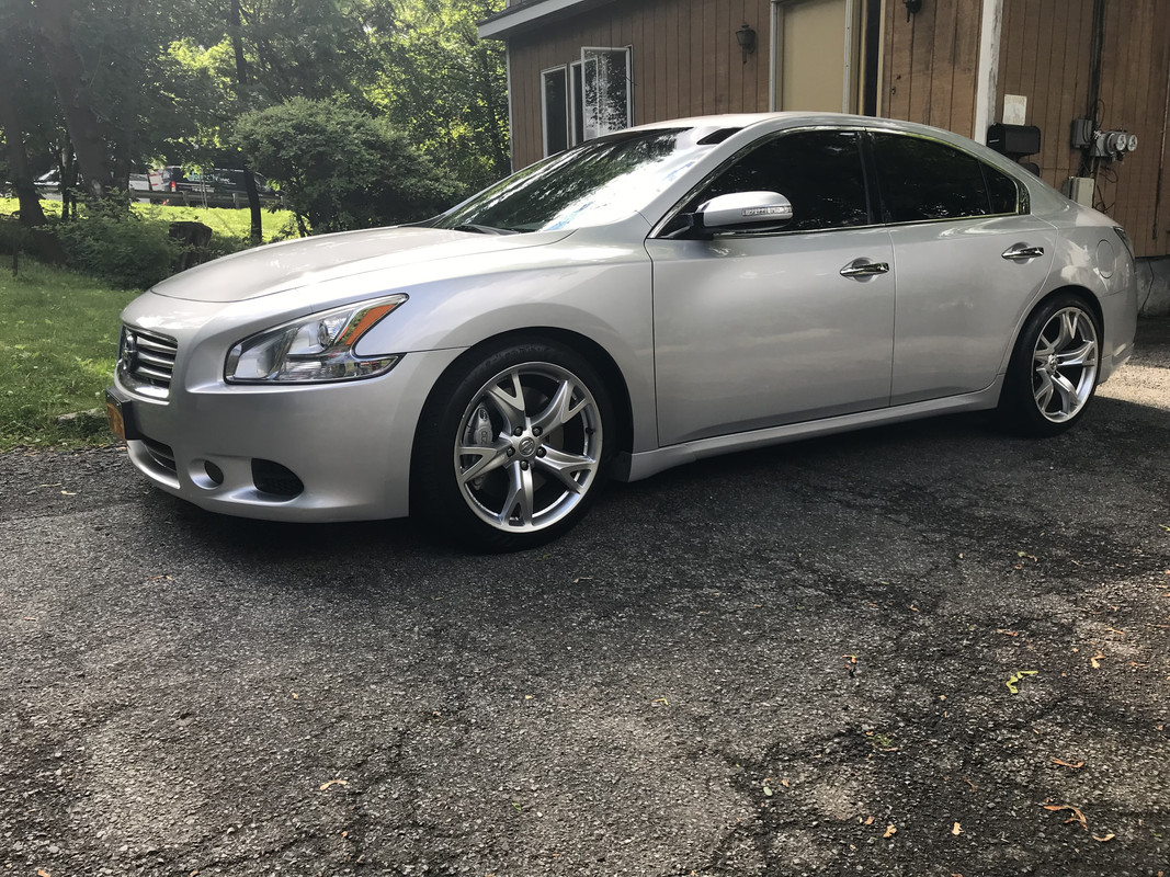

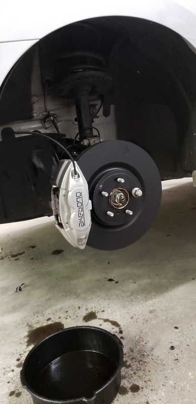

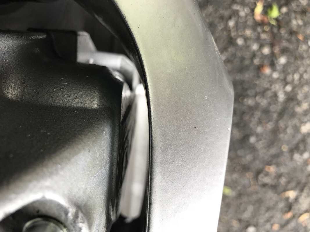

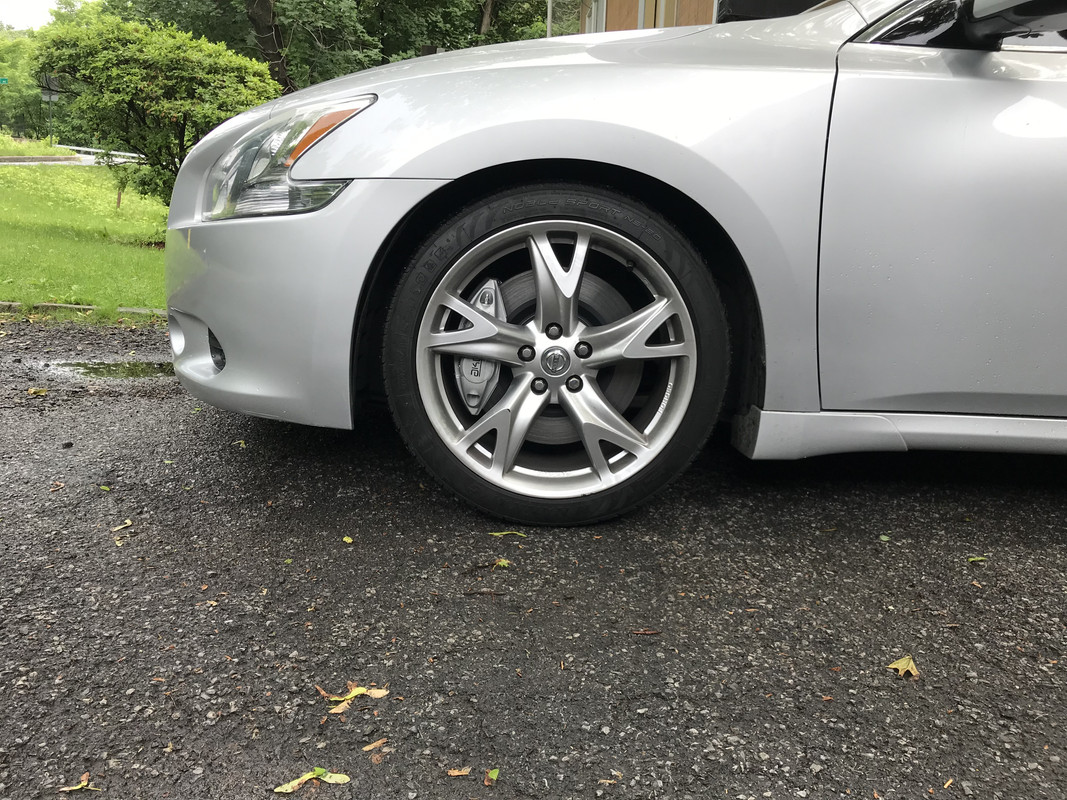

Finally got the akebono on!

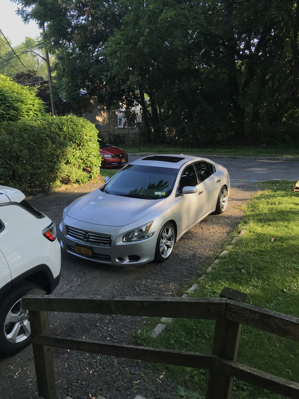

My car sits weird when it’s in my driveway. When it’s not in my drive it sit lower and doesn’t have that much gap at the front tire.
Wheels have to get redone and and new paint. Just gonna wait til the winter when I put the stock wheels back on to get them refinished.
Next is an oil change and cvt fluid change and maintenance things. After that more then likely gonna be some sort of front lip or splitter.
