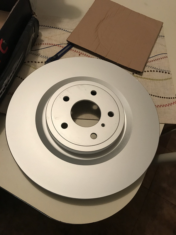

Ordered new rotors from r1 concepts. The rotors I got from autozone(duralast gold) developed and bad vibrations when braking at high speeds( anything above 60 got really bad vibrations. Really pissed me off to have new brakes and bad wheel shake under braking. So I just bought new ones

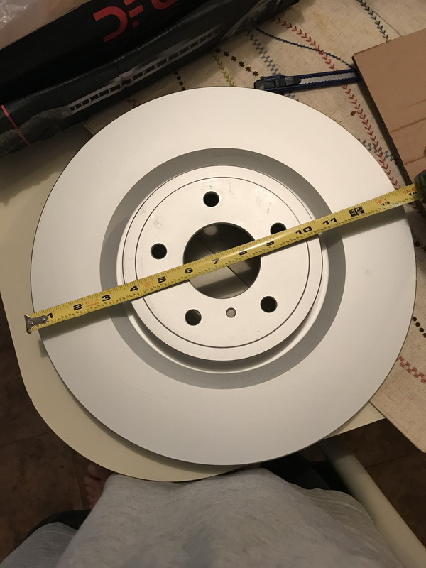

14inch rotors

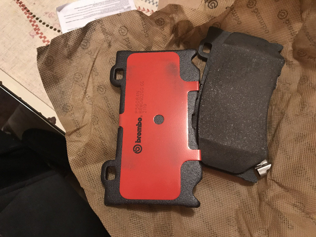

Hopefully these brembo pads and R1rotors will be better then my current garbage setup
What's going on with your current setup?
Old Aug 21, 2019 | 07:01 PM
  #133
Martinez1031's Avatar
Joined: Dec 2018
Posts: 308
From: New York
Less then a week after I installed and after following the break in procedure I’ve had severe steering wheel vibrations when braking above 60mph.
Old Aug 22, 2019 | 04:41 AM
  #134
MaximusN8's Avatar
Joined: Mar 2018
Posts: 448
Man I thought it was gonna be smooth sailing for you after I saw that set up. Goodluck with this one keep us informed, that car is looking nice I haven't done any mods to mine I'm keeping her as is, Only thing I did was tint my windows. Imo these cars look awesome as is and ofcourse look even better when their all done up!

Thank you good sir! Yeah man,I thought so too. I probably could just take the rotors off and have them cleaned with flex hone or bring them somewhere for resurfacing. Scrub the pads in case they are glazed but honestly I don’t have patience for things like that anymore. If I’m gonna spend 100 bucks to get brakes resurfaced etc I might as well just scrap them and spend money on what I hope is a better setup.

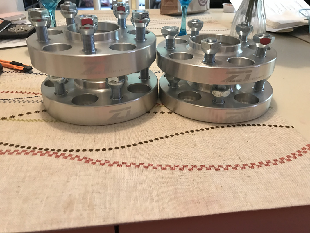

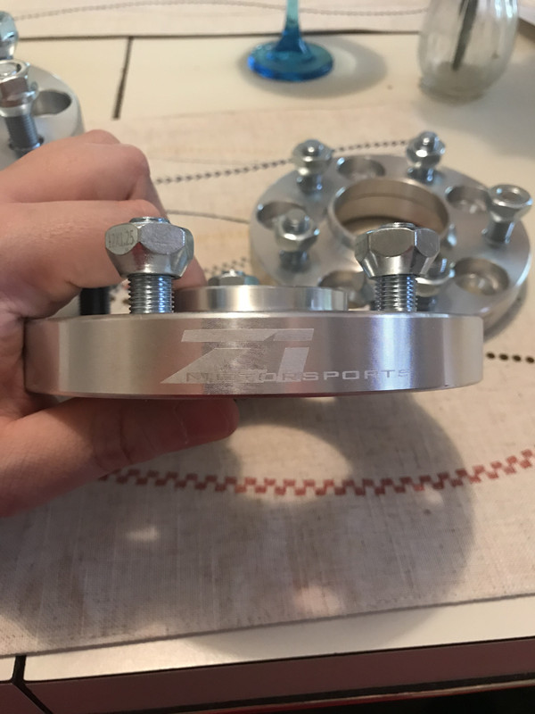

20mm for the front 25mm for the rear. These are so I can put the oem wheels on for the winter to clear the calipers and make the wheels more flush
May I ask from where did you get the spacers and how much they cost?
Old Aug 24, 2019 | 03:18 PM
  #144
Joined: Dec 2018
Posts: 308
From: New York
Got them from z1 Motorsports. The 20mm are 109 but were on sale for 80. Paid 88 with shipping. Same goes for the 25mm. They are actually still on sale. But 88 now instead of 80. Still beats 109 though.
https://www.z1motorsports.com/z1-pro...mm-p-5392.html
Old Aug 24, 2019 | 06:26 PM
  #145
mahanddeem's Avatar
Joined: Mar 2009
Posts: 1,382
Bolt on even on stock setups (wheels, brakes and everything)?
Old Aug 24, 2019 | 08:51 PM
  #146
Joined: Dec 2018
Posts: 308
From: New York
Supposed to bolt right up. Some people get longer wheel studs. I’m almost certain I won’t need to do that. Usually only have to do that when you have aftermarket wheels.

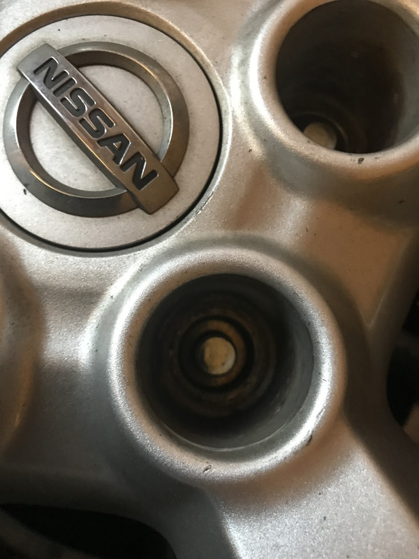

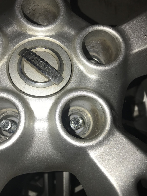

Haven’t posted in while,haven’t done much to max buuuuut tried to put the oem wheels back on with the spacers to clear the calipers. I should have got the spacers with extended studs. With the spacer,the oem studs just leave me with very uncomfortable feeling. The main reasons spacers fail is either because they are cheap or because the lugs don’t have much to hold on to. If I were to put these on,I might be able to get 4-5 turns before the lug is tight. That’s asking for trouble.
So now I have to wait and order longer studs

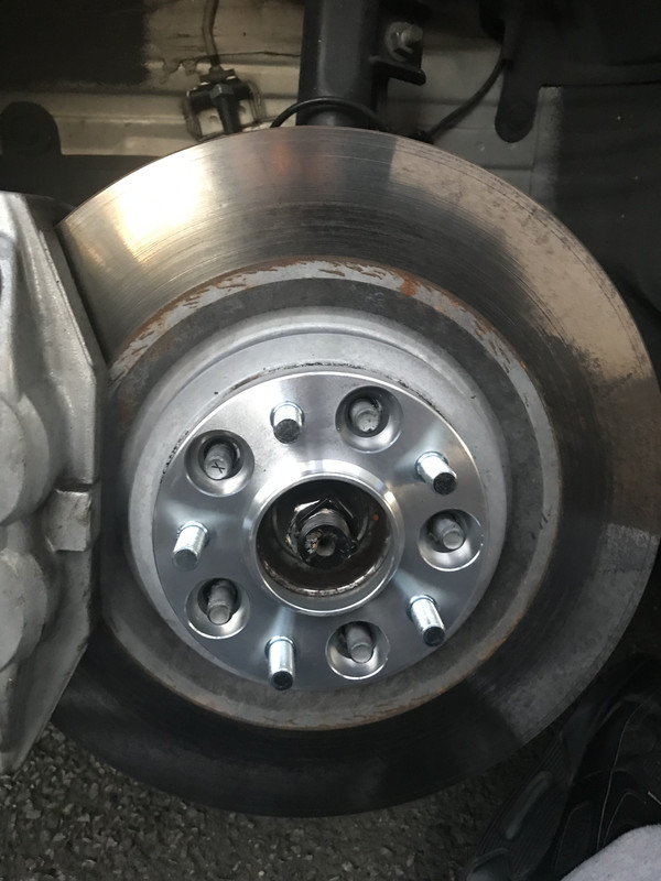

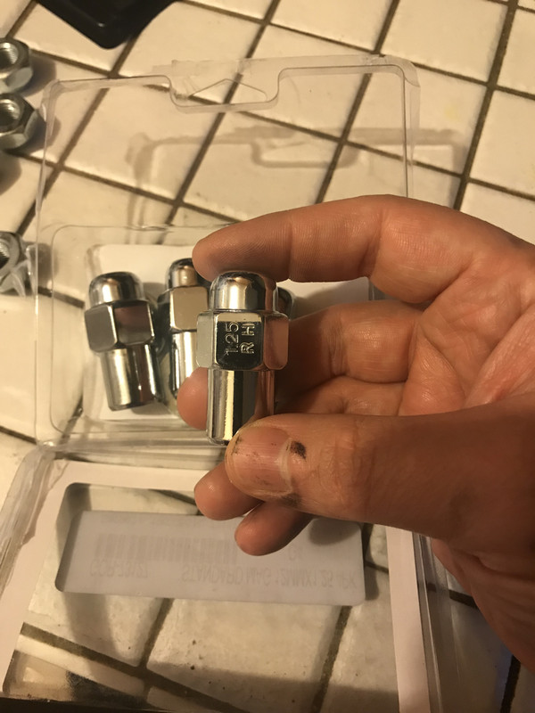

The answer for the shorter studs...extended lug nuts. Did a test fit and seems to work great. Was gonna put them all on today but my little one is sick. So I’ll wait til the weekend

Finally decided to change my wheels back for the winter. Got (1) done then had to stop and do something else. Will finish the rest tomorrow. 20mm spacers from z1 motorsports along with extended lugnuts from Gorilla
